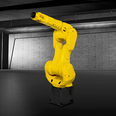

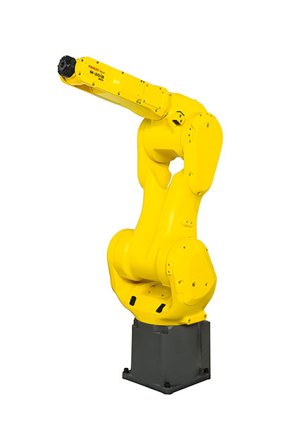

Equipped with a lightweight upper arm and inline wrist, and weighing just 205 kg, the M-20iB/35S delivers high inertia and lifts a full 35 kg. This, combined with its compact design and narrow arm, makes it ideally suited to numerous high payload machine tending and loading applications in a small footprint.
M20ib 35s facing left
Outstanding strength-to-weight ratio
The M-20iB/35S boasts an incredible strength-to-weight ratio and has been designed to achieve faster cycles and increased throughput on a range of applications.

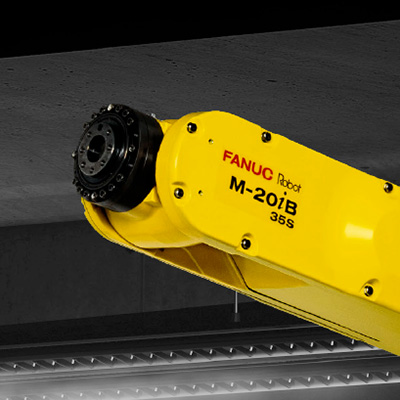

Fea m 20ib 35s halle head web
Demanding environments
Fully able to cope with the spray, moisture and dirt associated with many machining processes, the M-20iB/35S comes fully encapsulated to IP67 standard.

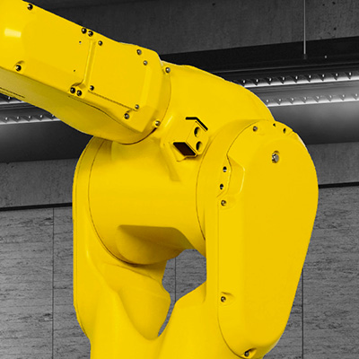

Fea m 20ib 35s halle slimarm web
Smart slim arm design
The M-20iB/35's slim arm contains a user interface and has been designed not to interfere with the peripheral devices.

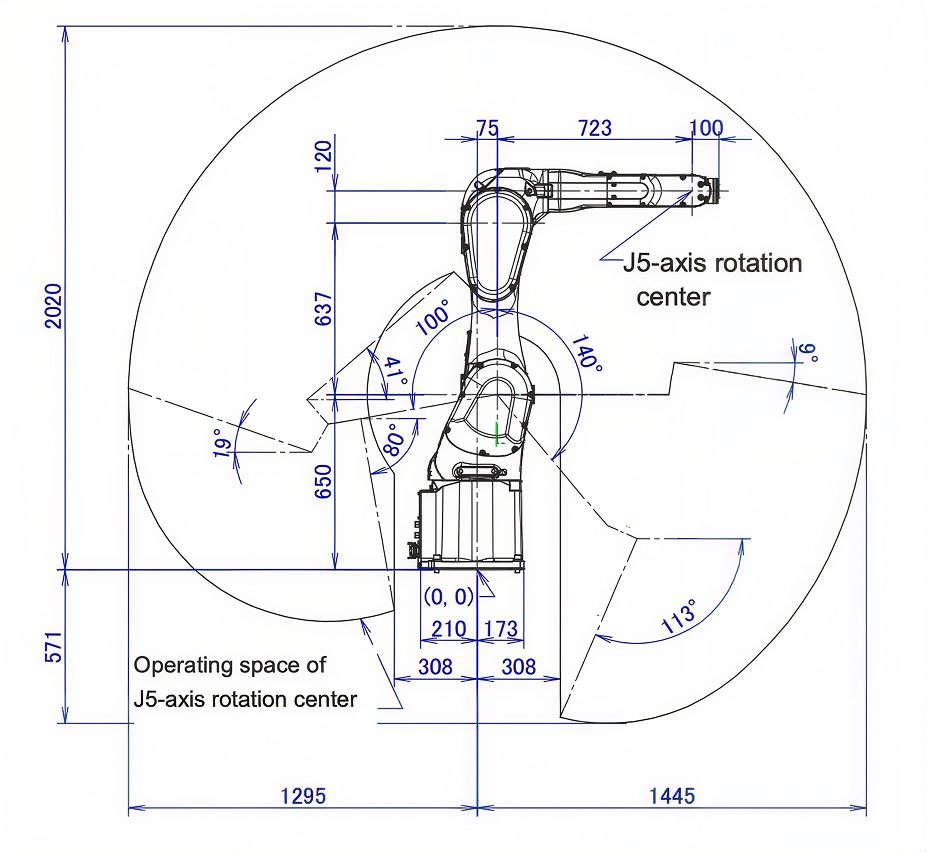

35.00 kg
±0.02 mm
1445.00 mm
205 kg
1 kW
340°
240°
302°
400°
260°
540°
205°/s
205°/s
260°/s
415°/s
415°/s
880°/s
51/2.2
51/2.2
31/1.2
