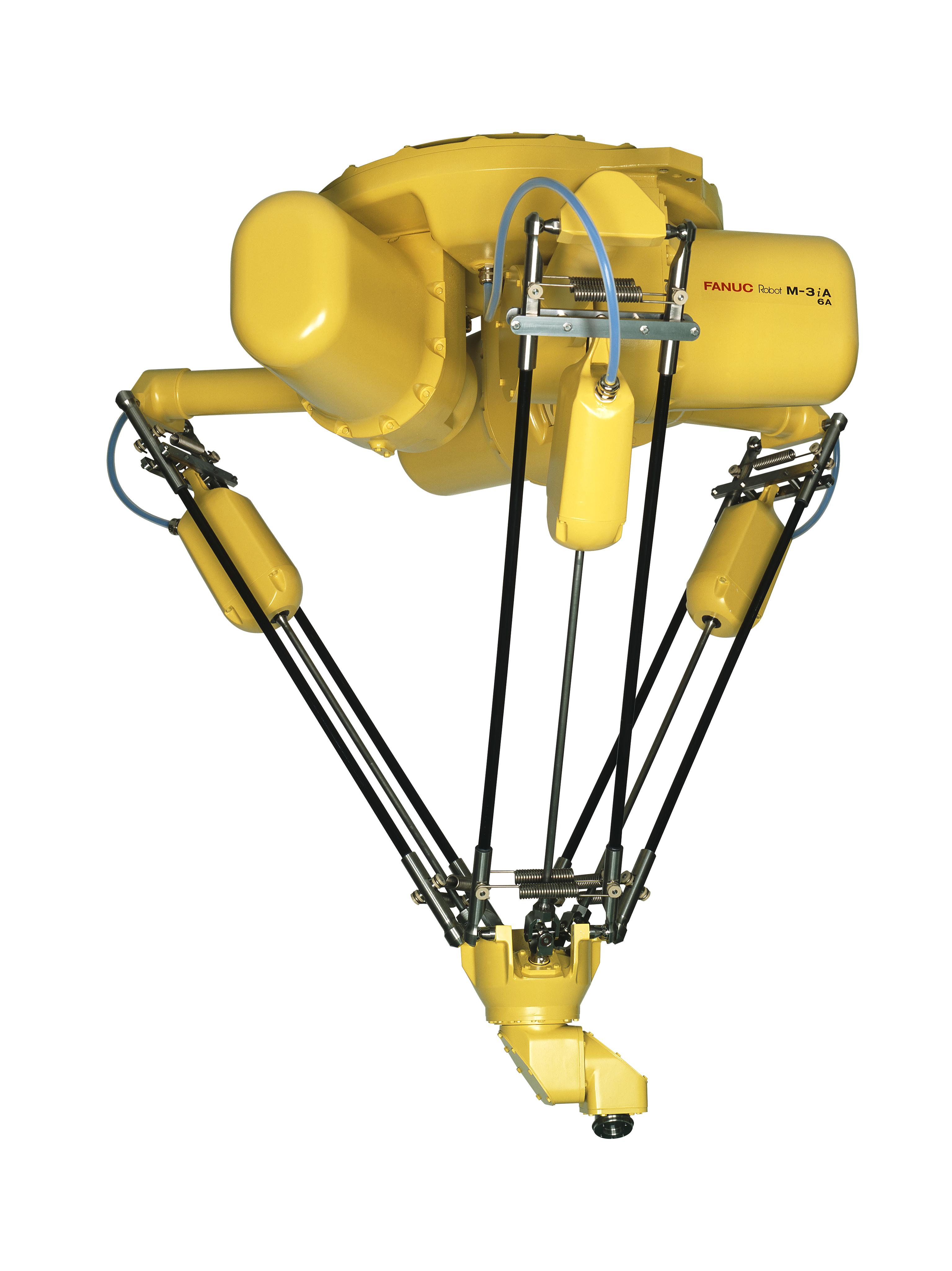

M-3iA/6A

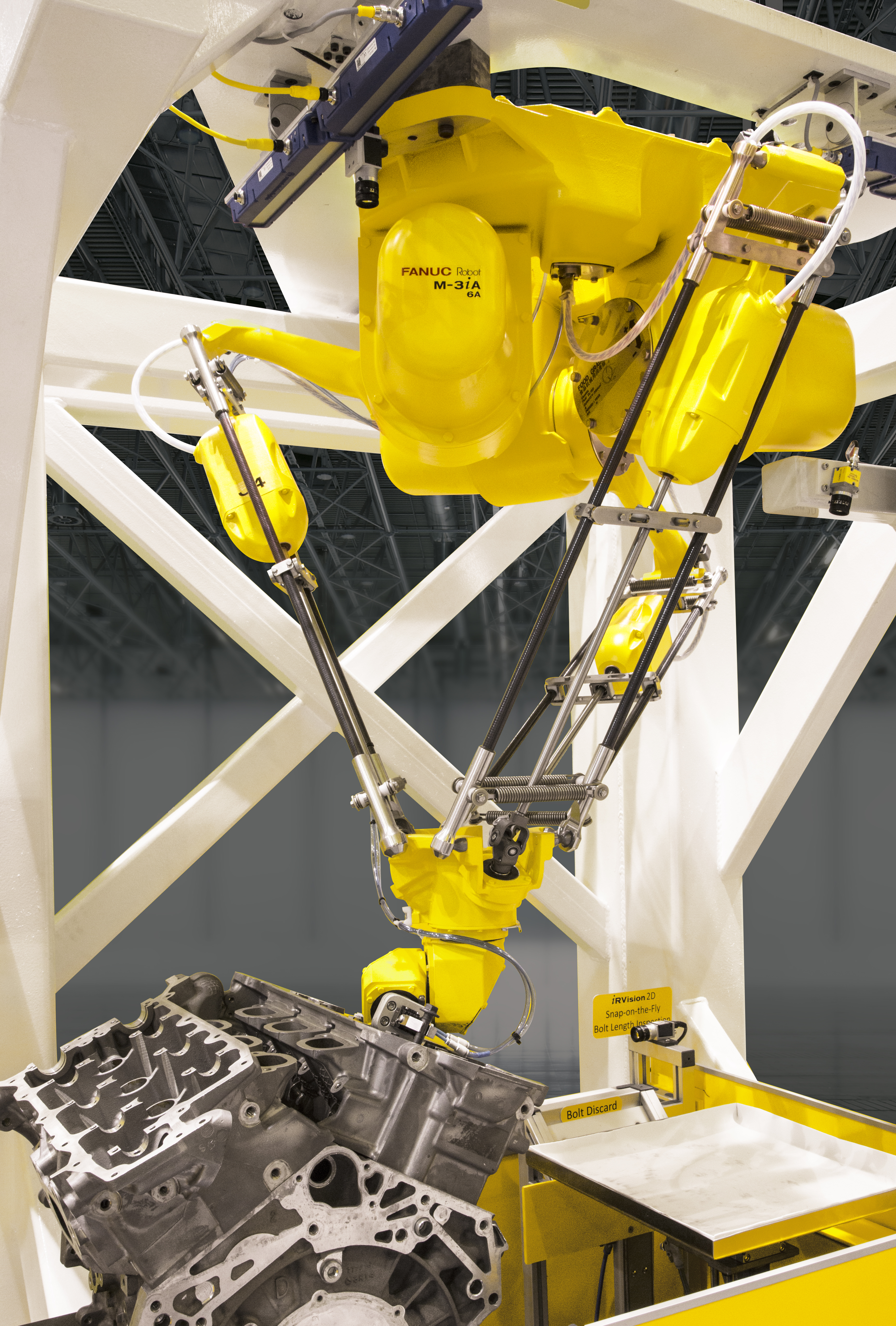

M 3i A bolt insertion

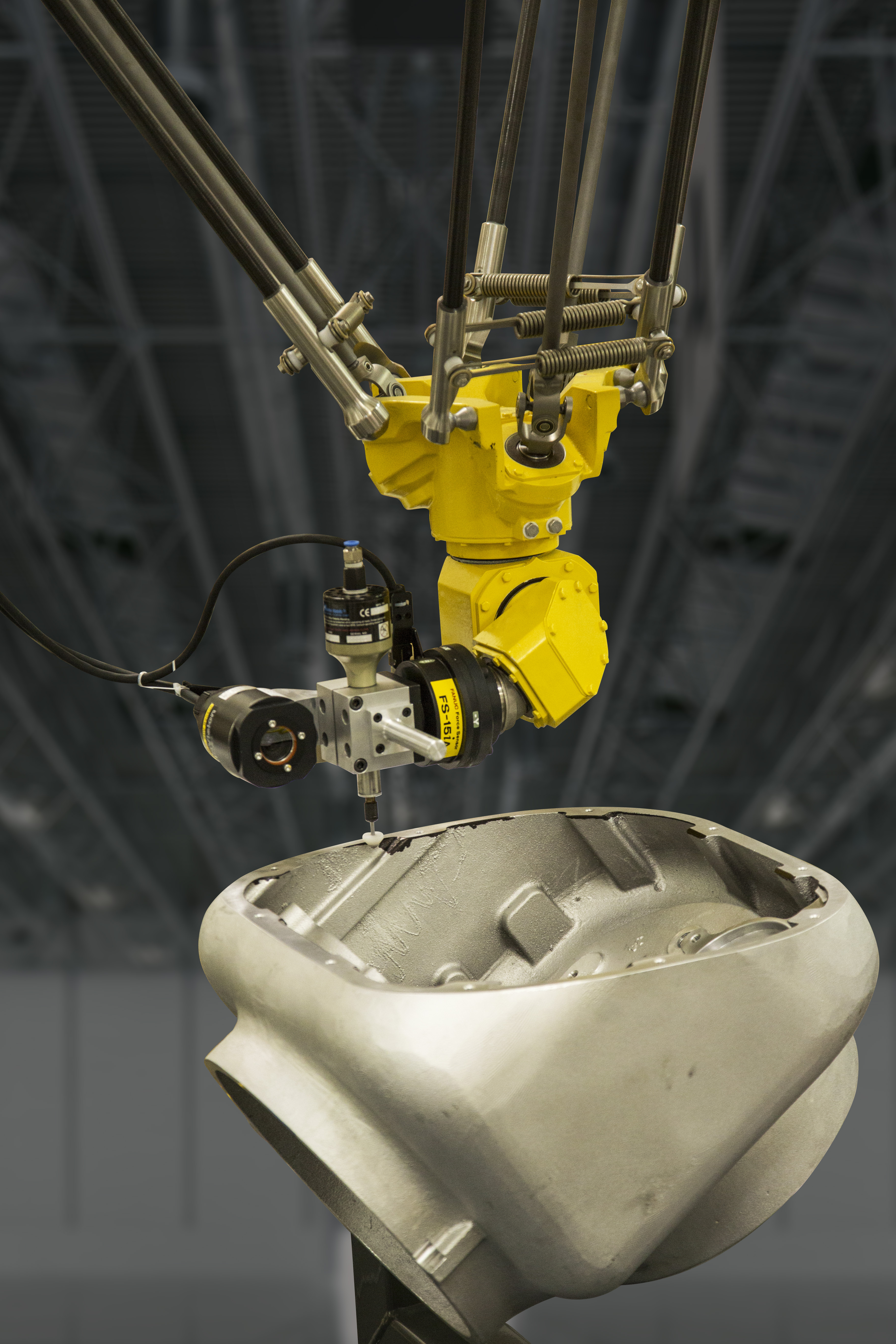

M 3i A deburring FS 15i A

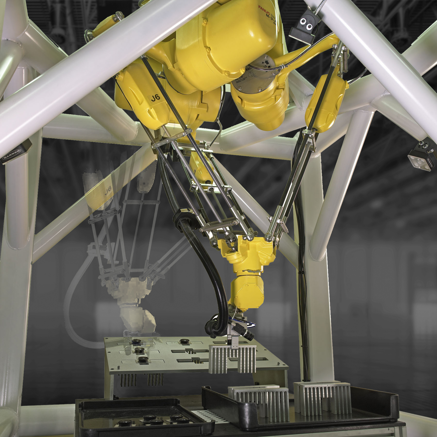

Fan Assembly
M-3 Series
M-3iA/6A
6 kg
1350 mm
175 kg

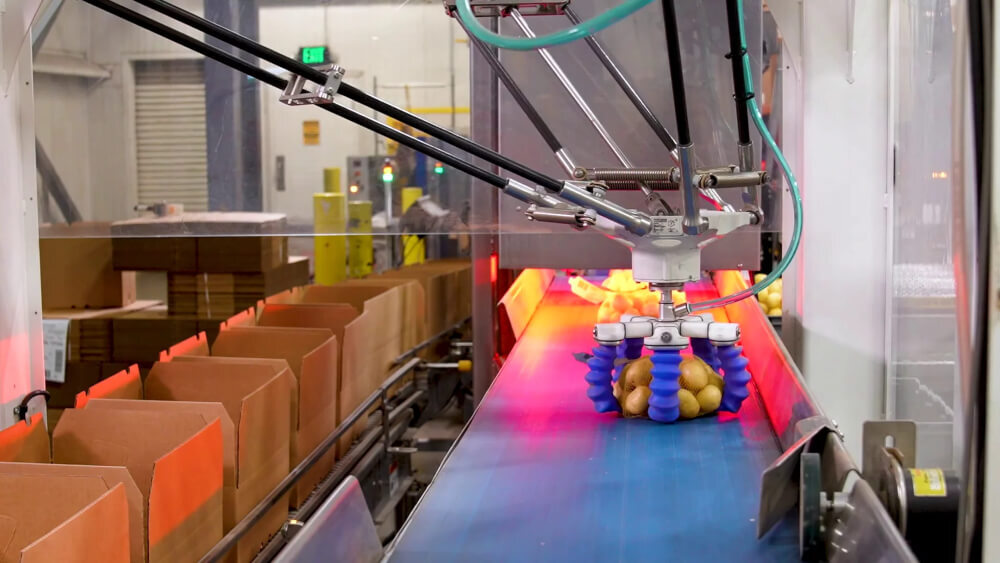

This high-speed 6-axis delta robot is perfect for picking, packaging and assembly. Its 3-axis wrist means it is capable of freely rotating workpieces and tools as required for assembly applications. Its clever design also means it makes best use of available workspace.
M3i A 6 A Beauty Shot
6-axis Delta Robot Design
This model's 3-axis wrist enables you to feed parts in from different sides of the work zone, increasing your useable workspace.
Int ro pr m36a 1 1

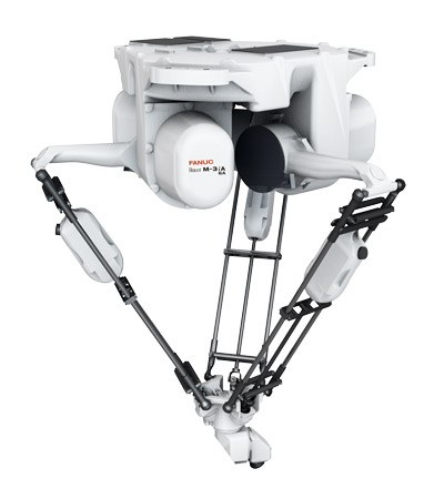

Food Option
Lubricated with food-grade grease, this model features a special coating to handle acid and alkaline disinfectants, and low-pressure rinsing.
M3ia 6a delta robot wrist banner
Unique delta design with flexible 3-axes wrist
The extreme human-like flexibility offered by the three-axis wrist enables the robot to pick up and insert parts at simple or compound angles, and twist parts into place.

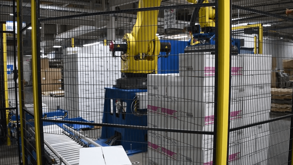

Material Handling
