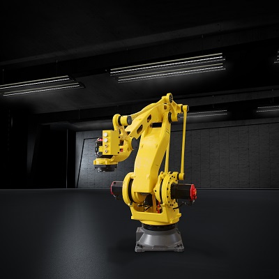

Built on the basis of the FANUC M-410 model series, this 4-axis robot stands out based on its slim design and optimized kinematics. These features allow it to perform robotic palletizing tasks at a high speed (throughput of 2200 cycles per hour) while making the most efficient use of the available workspace. Compared to the larger models of this series, the M-410iC/110 is considered the fastest palletizing robot in its class with a working range of 2,400 mm.
Dx0a5830
Maximum usage of minimum space

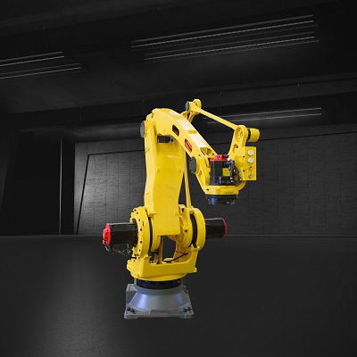

Straight working envelope
To ensure ideal palletizing conditions, this model is designed to achieve an optimized working envelope for palletizing. This gives it the wider range of motion, which is optimal for the complete stacking height of pallets.

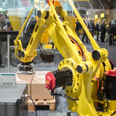

Compact and dynamic
Its compact size gives the M-410iC/110 the advantage of speed. It is significantly faster than the other palletizing robots from the same robot range.
