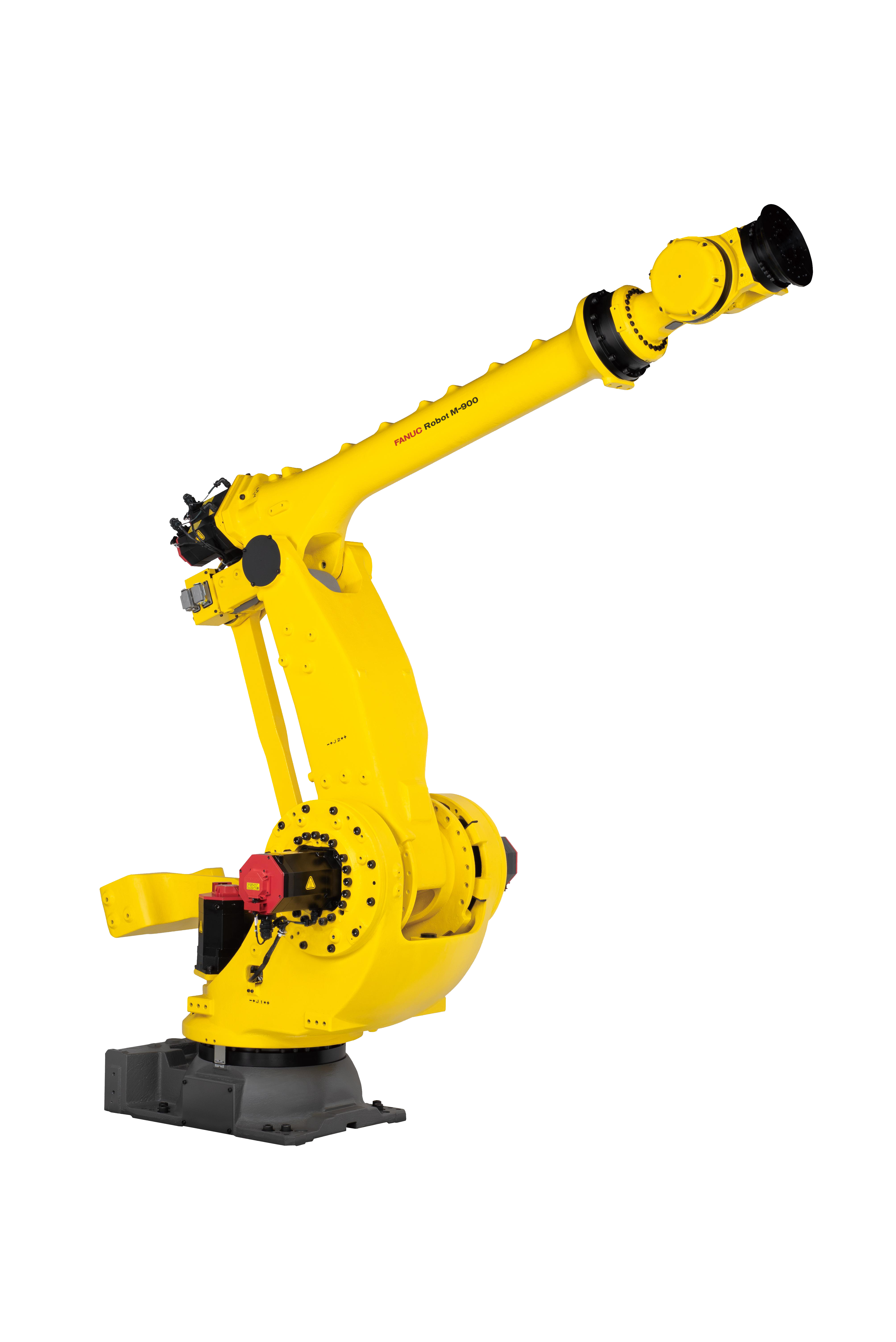

M-900 Series
M-900/330F-32B
330 kg
3203 mm
1780 kg
This long arm model comes with a compact mechanical construction ensuring an optimal weight-payload ratio. The large work envelope with a horizontal reach of 3203 mm and a vertical reach of 3539 mm makes it an ideal solution for heavy spot welding and material handling application like palletizing. Its inherent stiffness and the high payload qualify it for operations that demand higher levels of rigidity from the robot.
M900ia steel sheet robot banner
Floor, ceiling and angle mounting options
To make life easier in confined areas, this machine facilitates easy access for servicing.
M900ib 280l robot long arm banner
Increased reach
Your solution to tasks that demand a combination of ruggedness, extra reach and heavy lifting.
M900ib 280l dust liquid protected banner
Optional severe dust and liquid protection (SDLP)
Enhanced severe dust and liquid protection package available for use in harsh environments.
