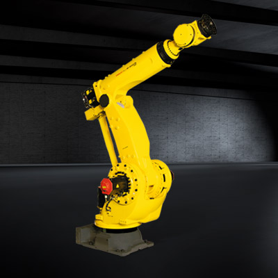

M-900 Series
M-900iB/360E
360 kg
2655 mm
1540 kg
The FANUC M-900iB/360E robot offers an enhanced wrist load capacity, large work envelope, and 2655mm reach. A robust 360kg payload, various mounting options, and six-axis operation maximizes the robot’s flexibility to accommodate heavier payloads for assembly, parts transfer and machine tending applications.

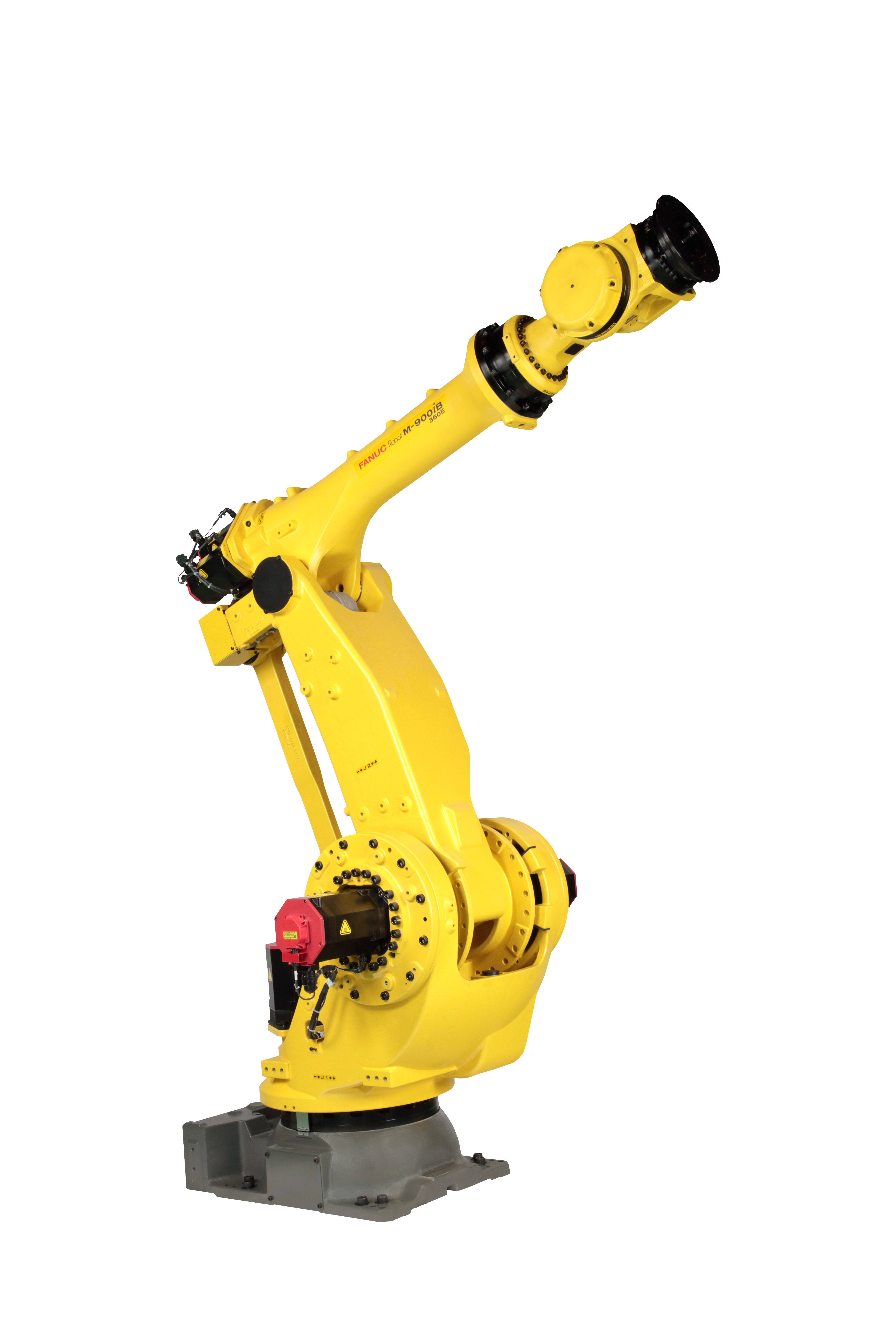

More Wrist Capabilities to Handle Heavy Parts
An enhanced wrist load capacity means that the robot offers more rigidity and force to efficiently handle, stack, load or unload large and heavy parts such as EV batteries, construction components, and metal fabrications.
Fea ro pr m900280 r 2
Space-Efficient Design
The compact footprint optimizes factory floor space. Mounting options include ceiling, floor, angle, and wall configurations.
M900ib 360l robot drive banner
Optional Severe Dust and Liquid Protection (SDLP)
For harsh environments, additional protection kits safeguard the robot base, drive train, and J1-J2 axes against dust and water. The J3 arm and wrist come standard with IP67 protection.
