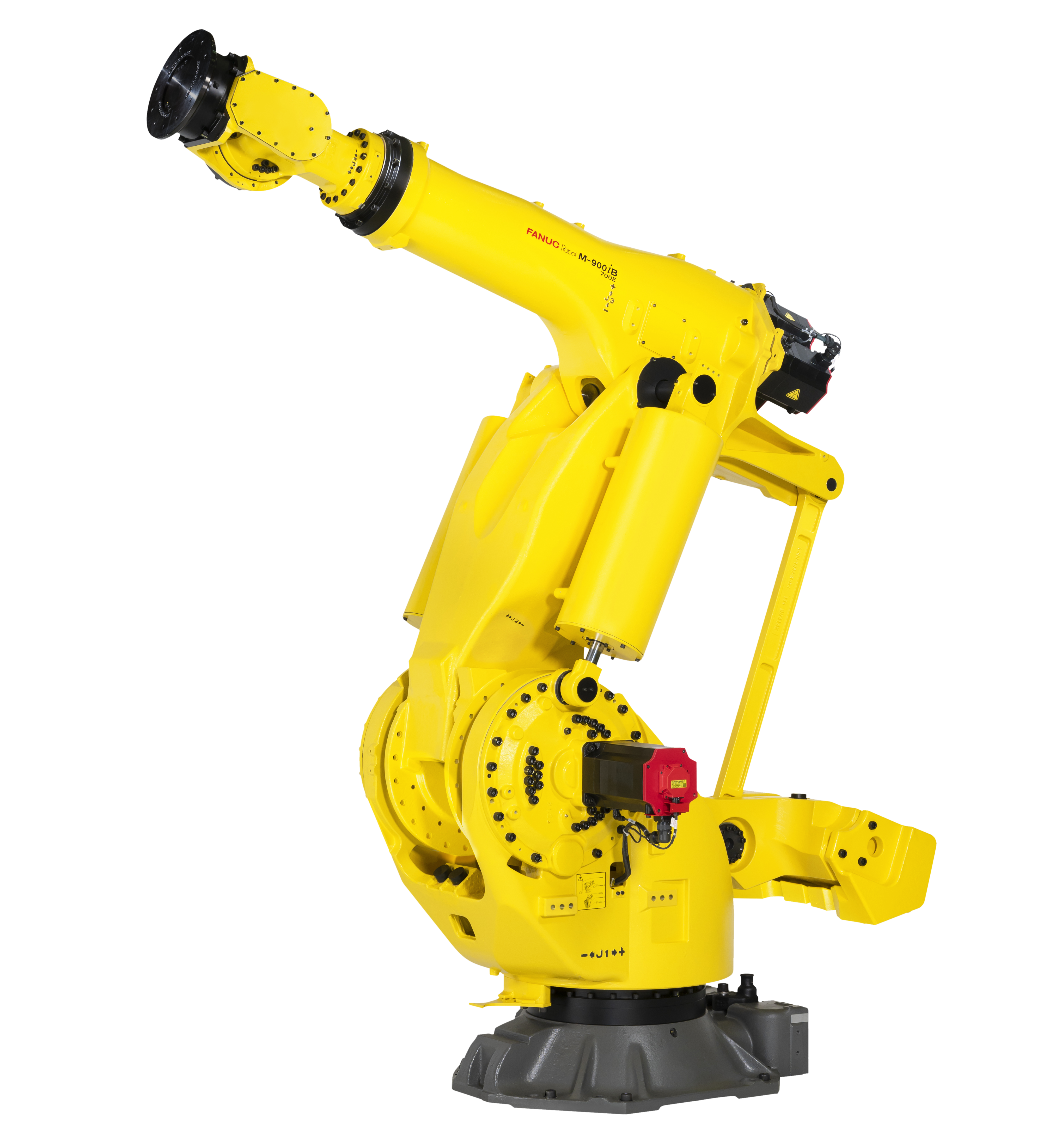

M-900 Series
M-900iB/700E
700 kg
2832 mm
3030 kg
The new M-900iB/700E robot is the latest model in the M-900 series of heavy-duty robots with payload capacities ranging from 280-700kg. The six-axis M-900iB/700E offers an enhanced wrist load capacity, large work envelope, a 700kg payload and long 2832mm reach.
M900ib 400l robot arm banner
More Wrist Capabilities to Handle Heavy Parts
An enhanced wrist load capacity means that the robot offers more rigidity and force to efficiently handle, stack, load or unload large and heavy parts such as EV batteries, construction components, and metal fabrications.
M900ia robot forge welding banner
Excellent accuracy and rigidity
Suitable for constant force applications such as routing, cutting, polishing, deburring.
M900ia robot large gripper banner
Heavy-duty drilling with robots
The M-900iB/700E is suited to high force drilling operations on workpieces such as windmill wings or aerospace parts.
M900ia robot loading banner
Rigid body enables stable transferring of large work pieces
Ideally suited to the EV Battery, steel, foundry, automotive, plastics, beverages and construction industries.
