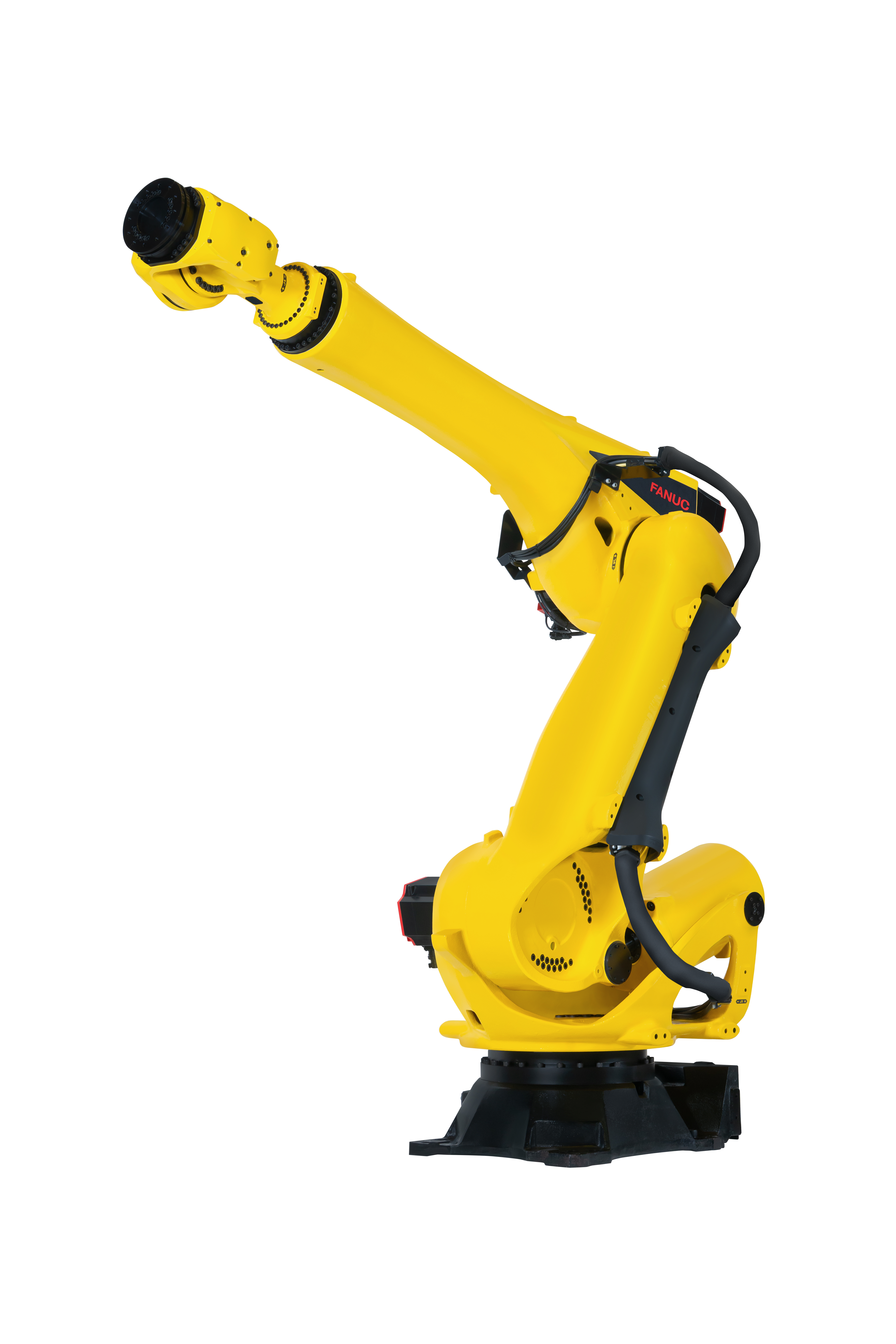

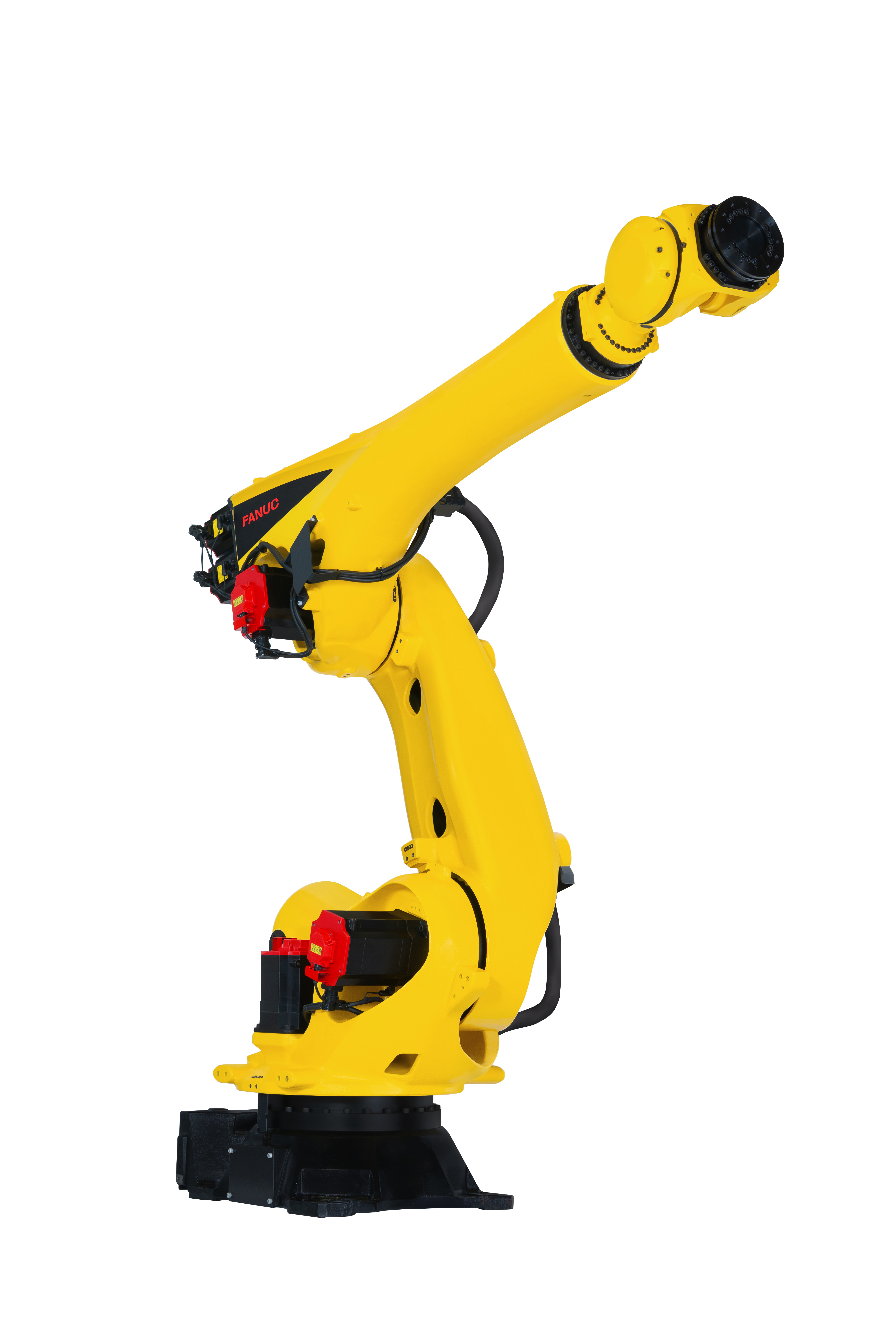

R-2000/E Series
R-2000/210F-31E
210 kg
3100 mm
1390 kg
The FANUC R-2000/210F-31E is a high-performance floor-mounted robot designed for demanding industrial applications such as spot welding, material handling, and heavy payload manipulation. With a 210 kg payload and an extended 3100 mm reach, it balances strength and coverage, making it ideal for large automotive components and multi-tool operations. Its 6-axis design and ±0.05 mm repeatability ensure precise, repeatable motion even at high speeds.
Built on the R-2000/E platform and powered by the FANUC R-50iA controller, this model delivers faster cycle times and smarter operation. Battery-less encoders and a maintenance-free design eliminate routine service requirements, while the rigid single-cast upper arm improves stability. Reduced energy consumption and seamless AI and network integration help lower total cost of ownership over the robot’s lifecycle.
