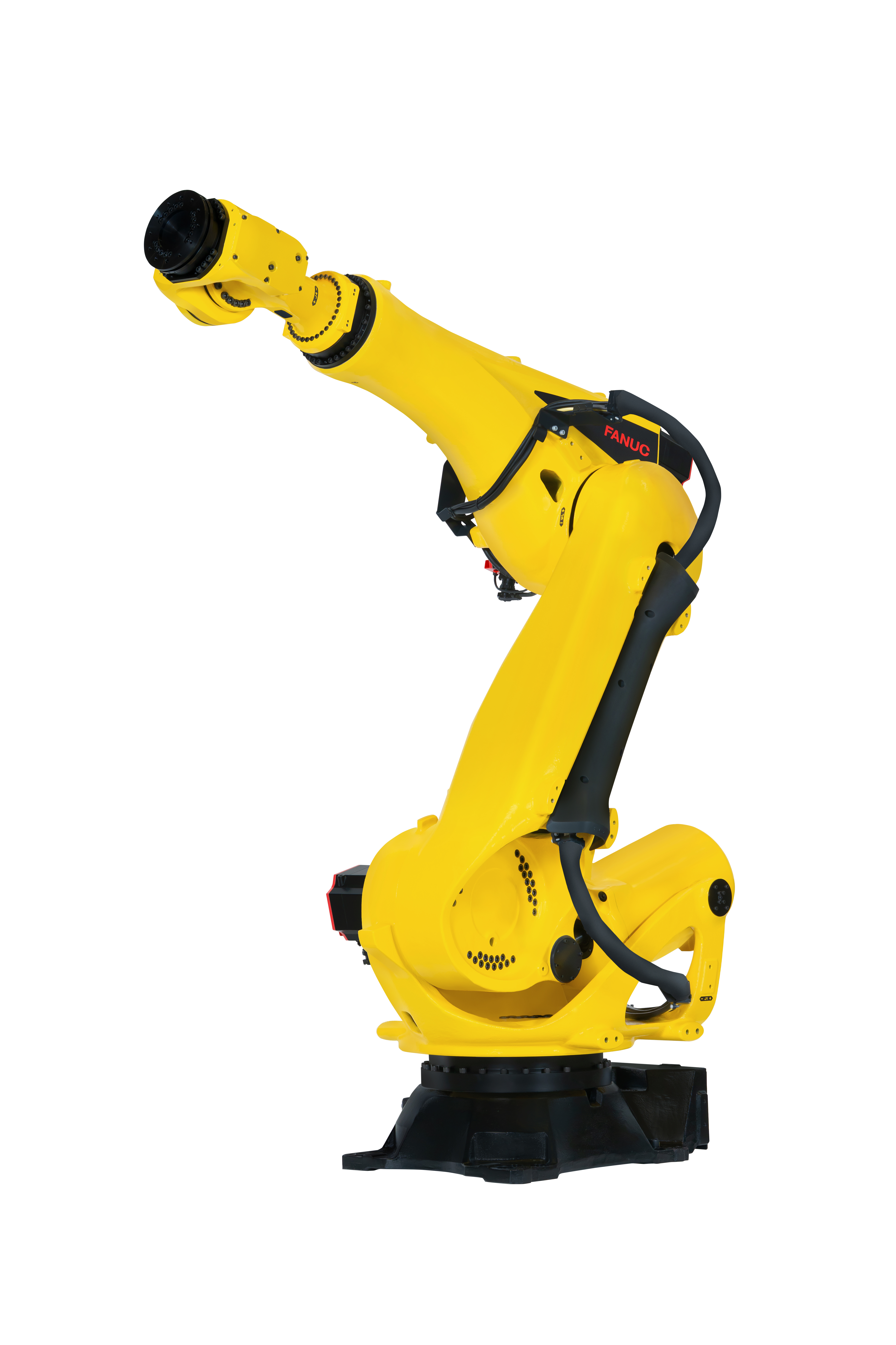

R 2000 300 F 27 E Right

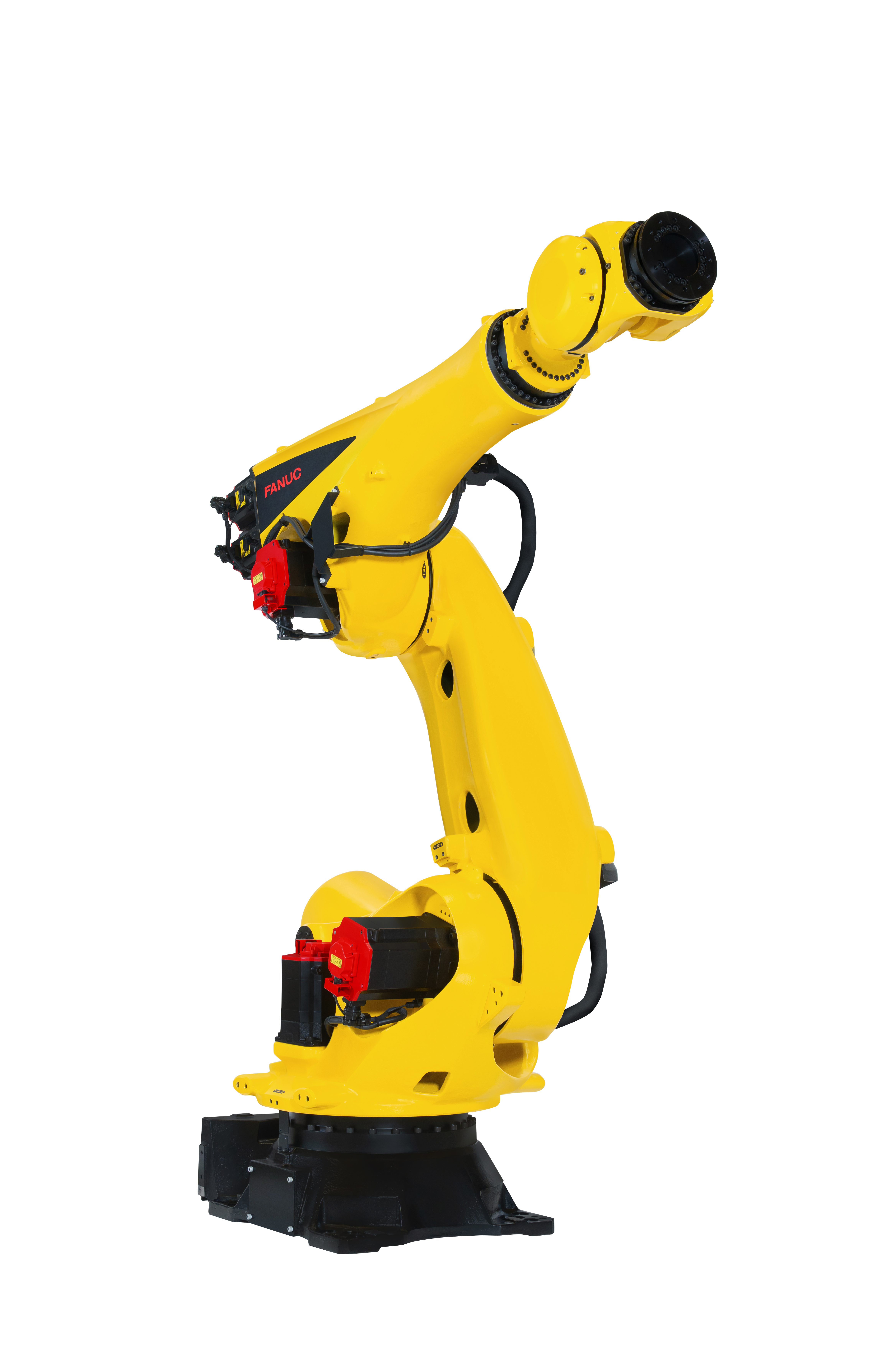

R 2000 300 F 27 E Left
R-2000/E Series
R-2000/225F-27E
225 kg
2655 mm
1105 kg
The FANUC R-2000/225F-27E expands material handling capability with a 225 kg payload capacity, scalable up to 240 kg, while maintaining a compact 2655 mm reach. This floor-mounted robot is ideal for heavier assemblies or applications requiring larger end-of-arm tooling without increasing cell size. Precision is maintained through its 6-axis configuration and ±0.05 mm repeatability.
Powered by the FANUC R-50iA controller, the R-2000/225F-27E benefits from the advanced R-2000/E redesign, including faster operating speeds and significantly increased wrist load capacity. The maintenance-free design and AI-ready platform support flexible system integration while helping manufacturers reduce long-term operating and maintenance costs.
