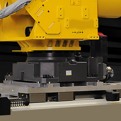

Rack mount
The rack mount configuration facilitates die change, press maintenance and optimal robot path programming.

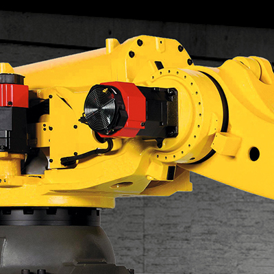

R 2000ic100p fan
High duty motor fan cooling
As a standard the R-2000iC/100P is equipped with J1/J2/J3 motors fan cooling to meet continuous high duty cycles.

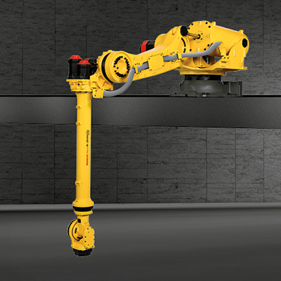

R 2000ic100p right
Shorter SPM cycle time
With a faster J1 and J6 axis speed, the R-2000iC/100P is able to meet shorter standard press motion (SPM) cycle time.
