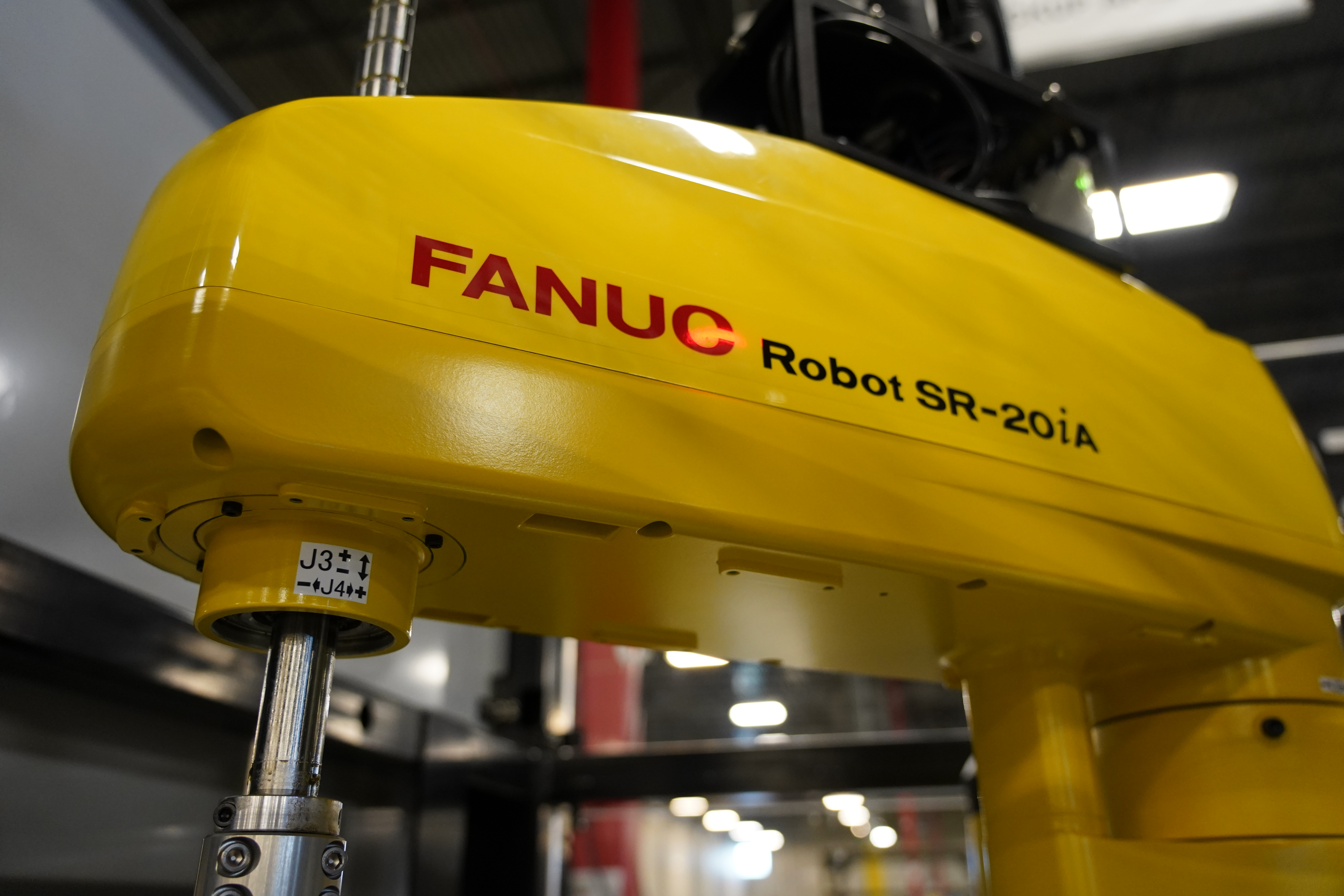

SR-20iA
C1 1068
C1 1097

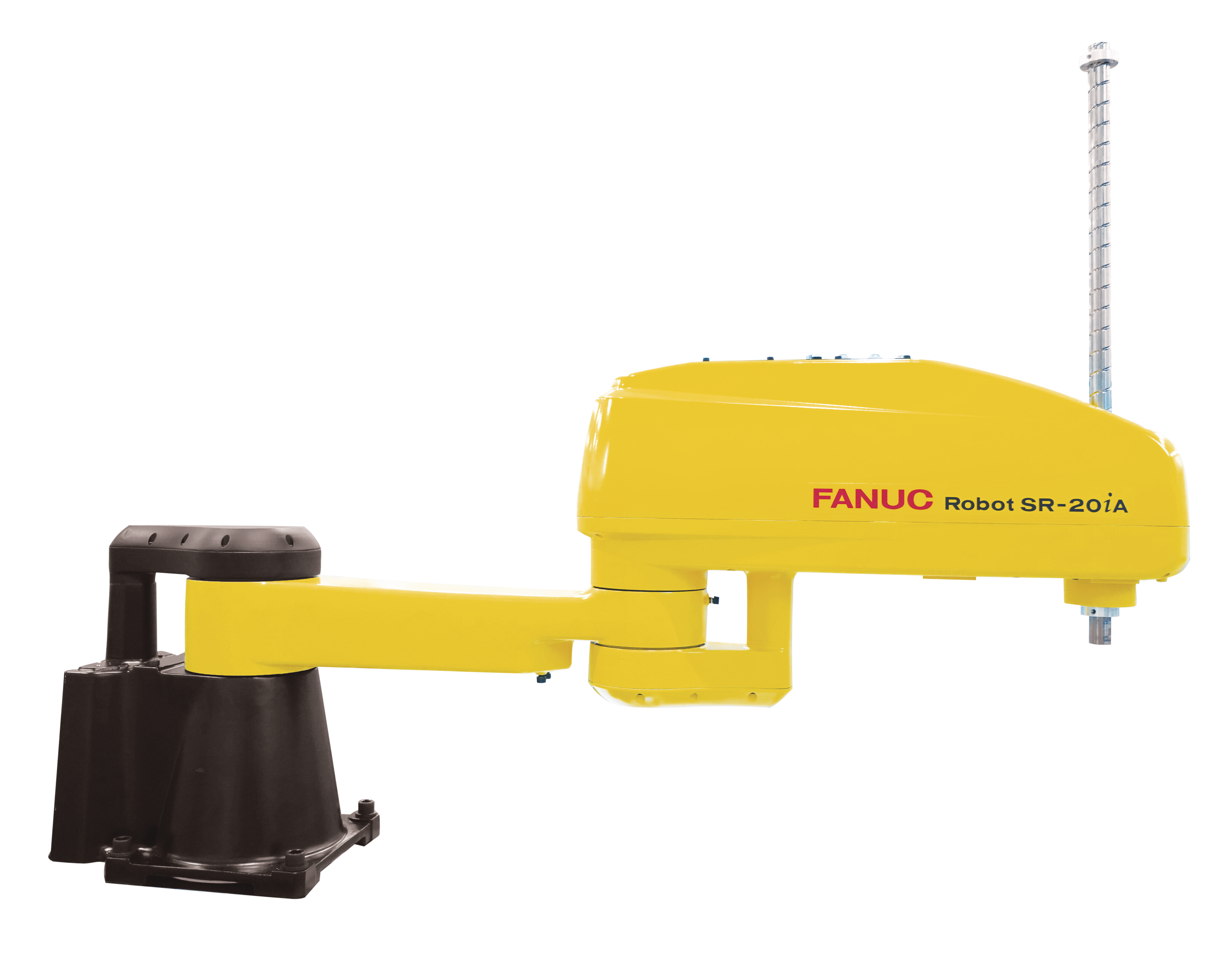

SCARA Series
SR-20iA
20 kg
1100 mm
4
64 kg

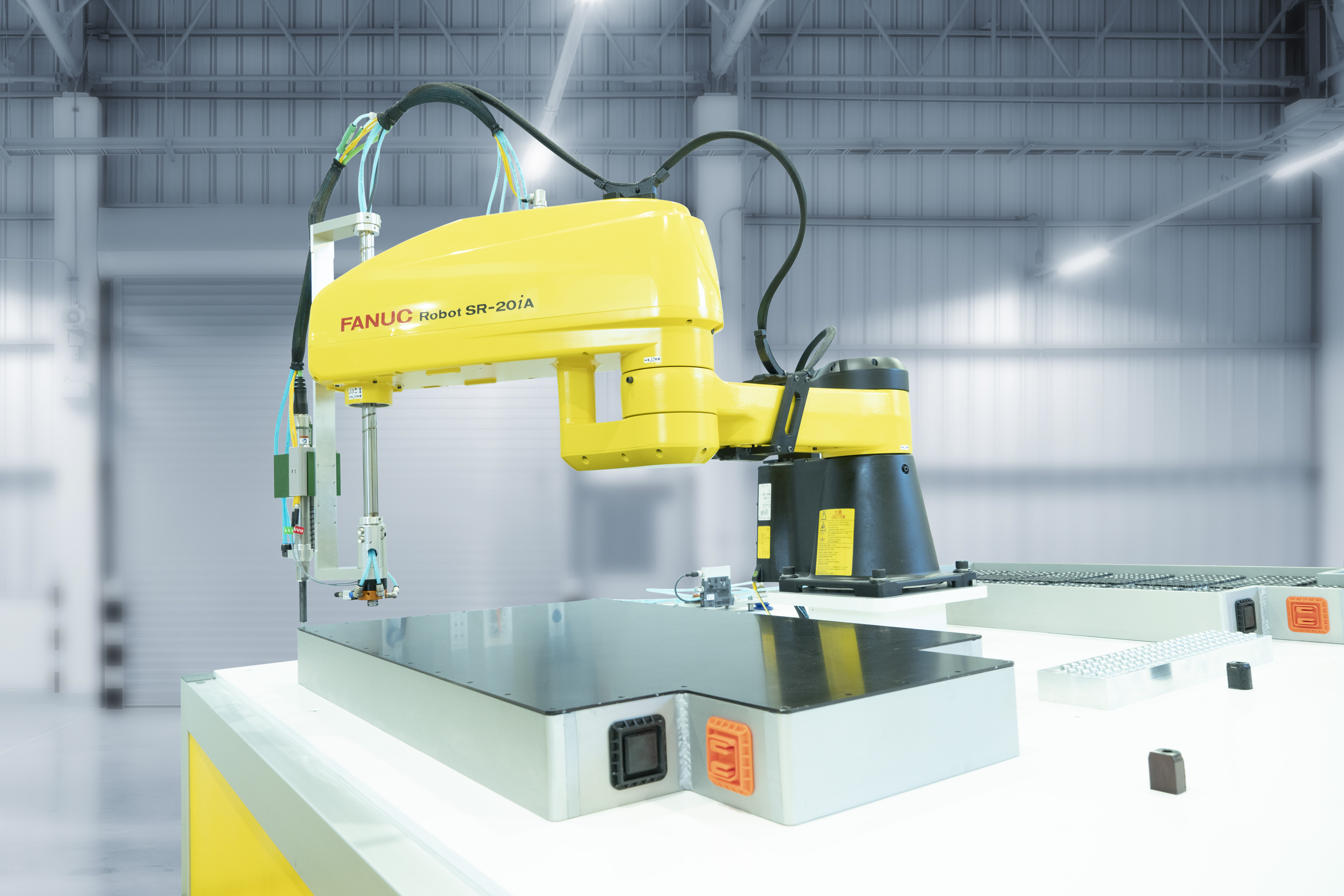

Internally routed cables/pipes give the FANUC SR-20iA SCARA robot a clean look, minimizing interference contour and simplifying its integration into any robotic assembly or packaging line. The compact design and weight of 64 kg and 1100 mm reach ensures maximum efficiency in terms of space and motion range.
SR 20i A Battery Pack Assembly
More productivity
High wrist inertia of up to 0.45 kgm² combined with payload of up to 20 kg the SR-12iA and SR-20iA open up new possibilities in the worlds of assembly and packaging.

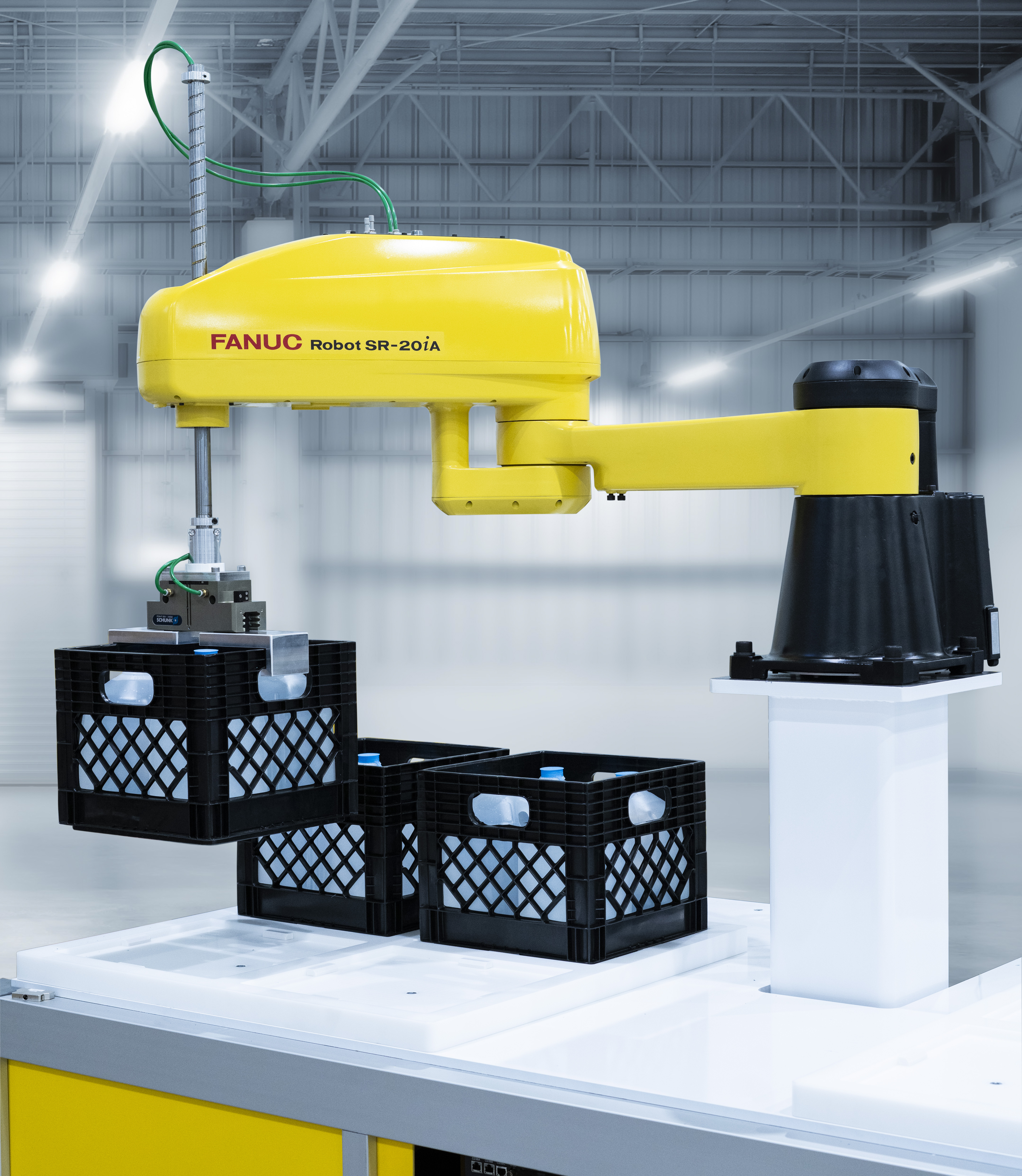

SR 20i A Handling Crates of Water
Integrated services
I/O, 24VDC, solenoid valves and air lines in the arm prevent interference and reduce costs.

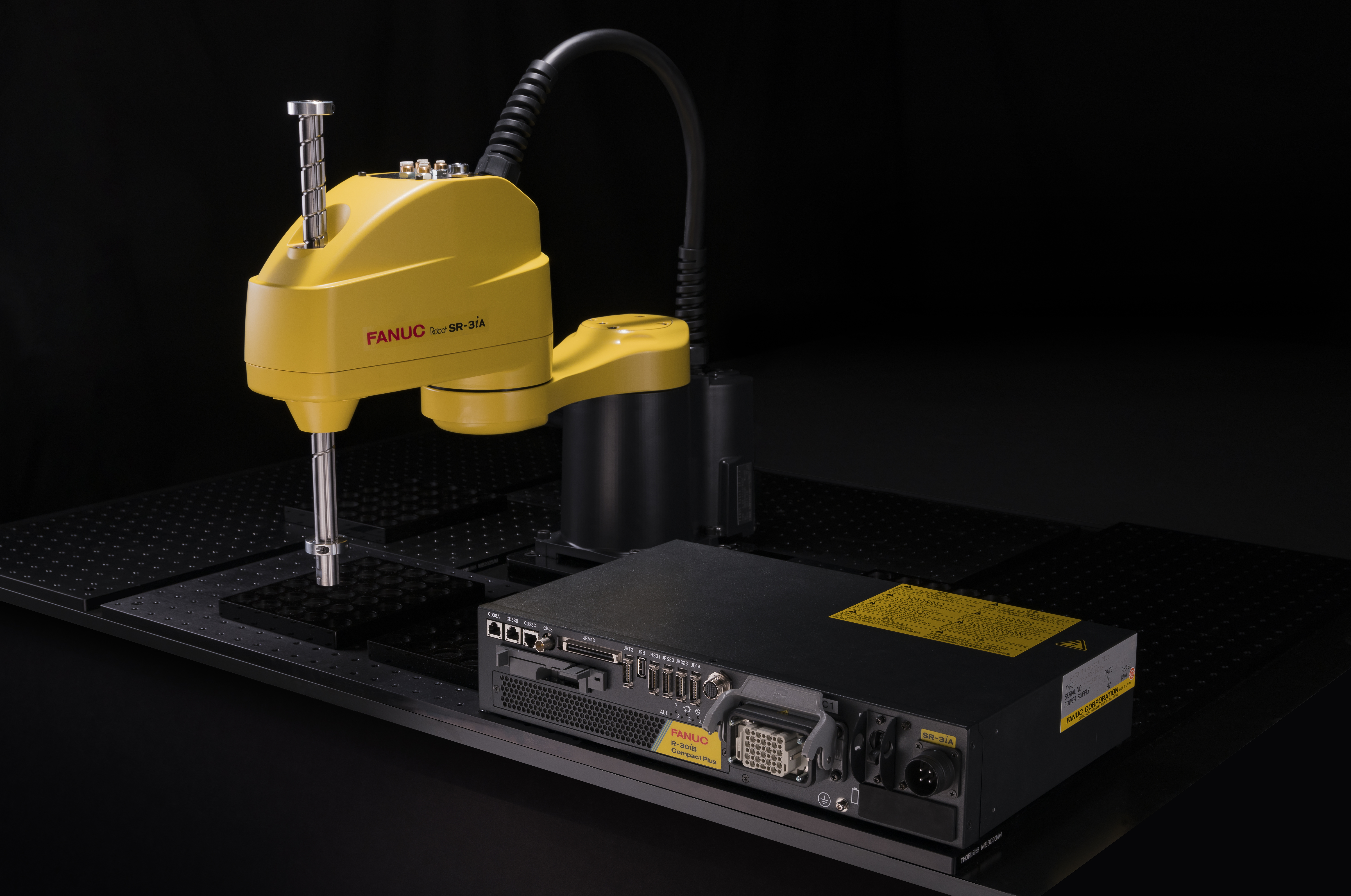

Space-saving controller

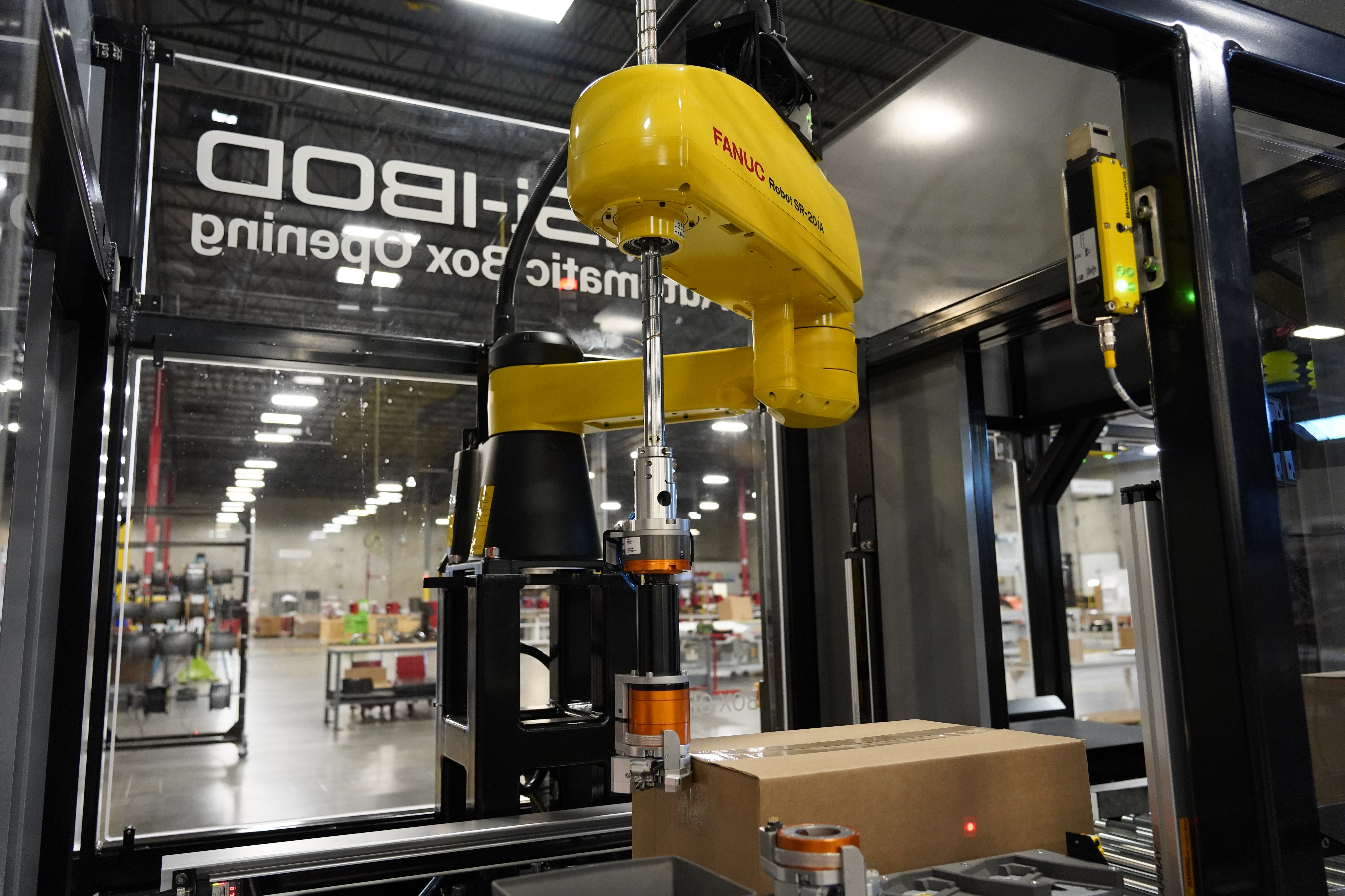

CASi-IBOD Intelligent Box Opening Device
The CASi‑IBOD system measures incoming boxes of varying sizes and automatically cuts them for safe, efficient product removal up to 950 boxes per hour.
Cropped CASI Logo Clr RGB
Video courtesy of CASI Cornerstone Automation Systems
