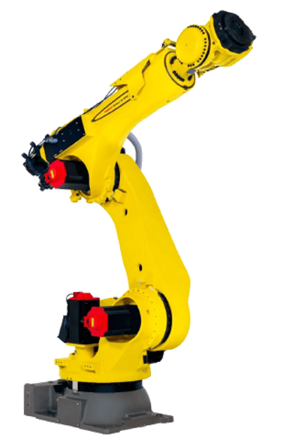

The M‑810/270‑27B is a heavy‑duty 6‑axis industrial robot designed for manufacturers who require both high payload capacity and exceptional precision. With a 270 kg payload, it delivers significantly greater lifting capability than the M‑800 series, making it ideal for handling large tools, fixtured components, or machining heads without sacrificing stability.
Engineered for accuracy under demanding external forces, the M‑810/270‑27B offers 0.03 mm repeatability and an extended 2687 mm reach, ensuring consistent performance across large work envelopes. Its structural rigidity and motion control tuning enable precise tool-path execution even during aggressive cutting operations or high-load interactions.

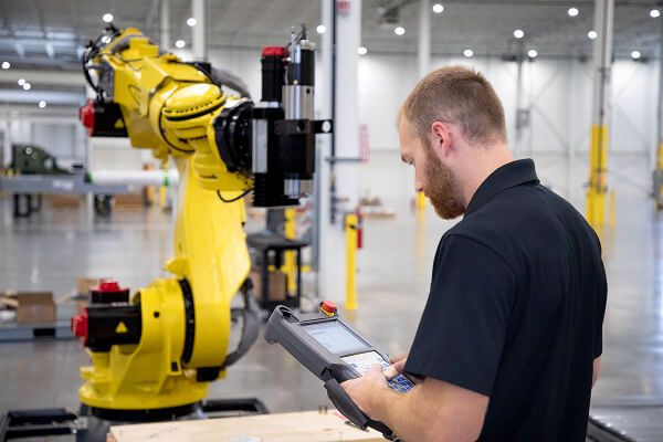

FANUC Employee Programming M810
Advanced machining specialist
Optimized for advanced machining environments, this robot excels in milling, drilling, and tapping applications on steel and aluminum workpieces. Whether operating in dry machining or wet environments with cutting fluid, the M‑810/270‑27B delivers reliable, high‑quality results—making it a robust solution for heavy industrial manufacturing and robotic machining cells.
