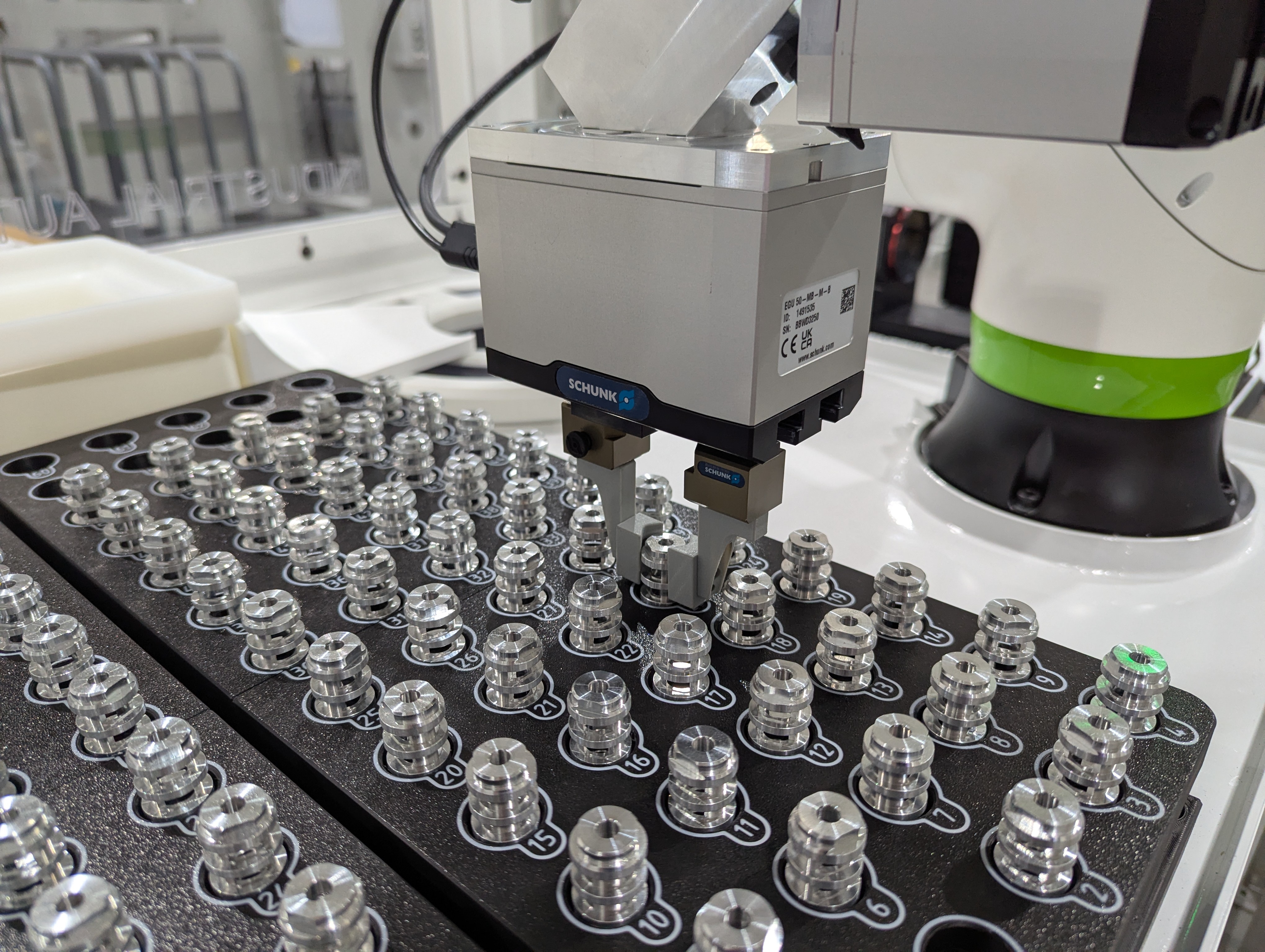

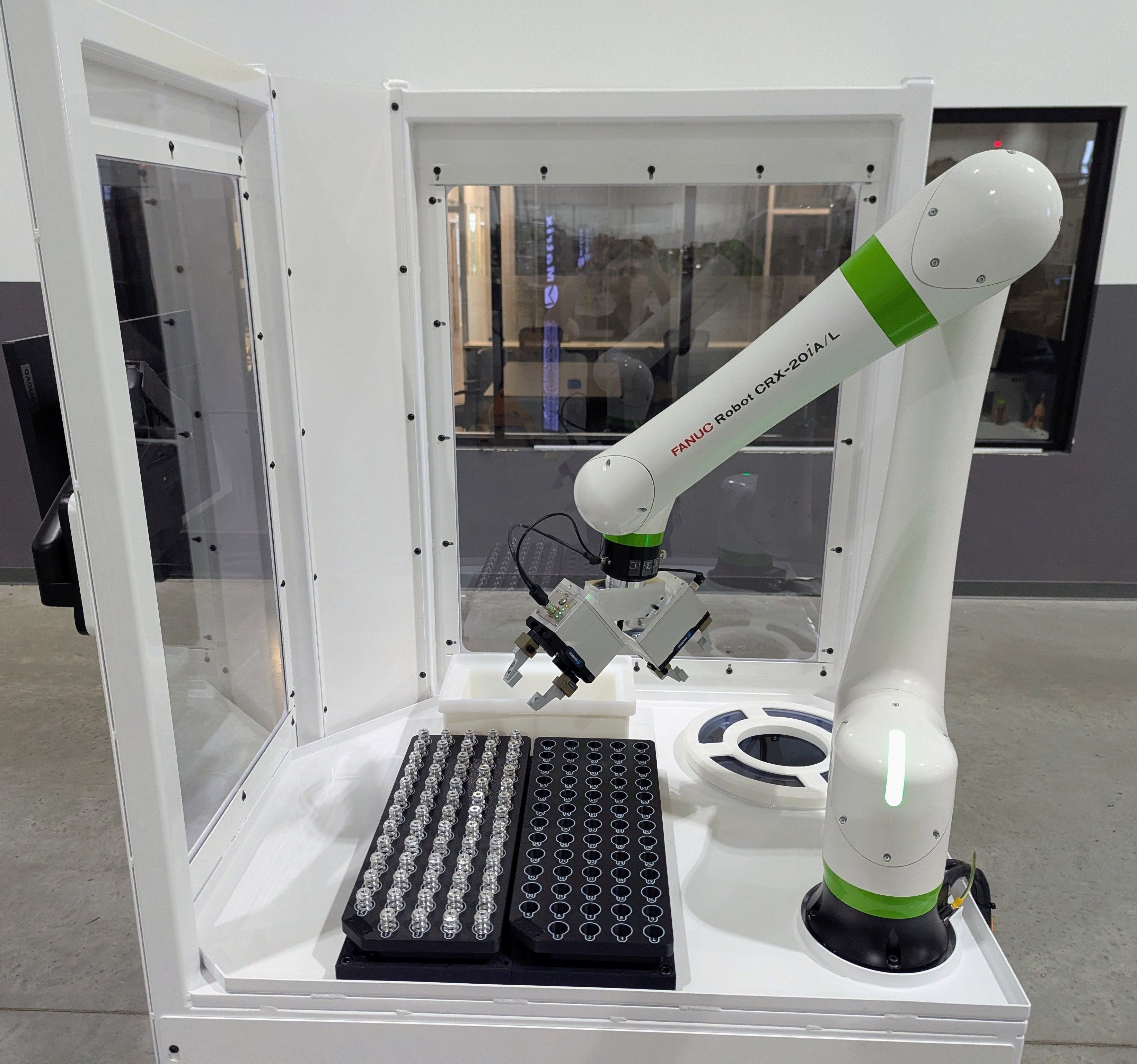

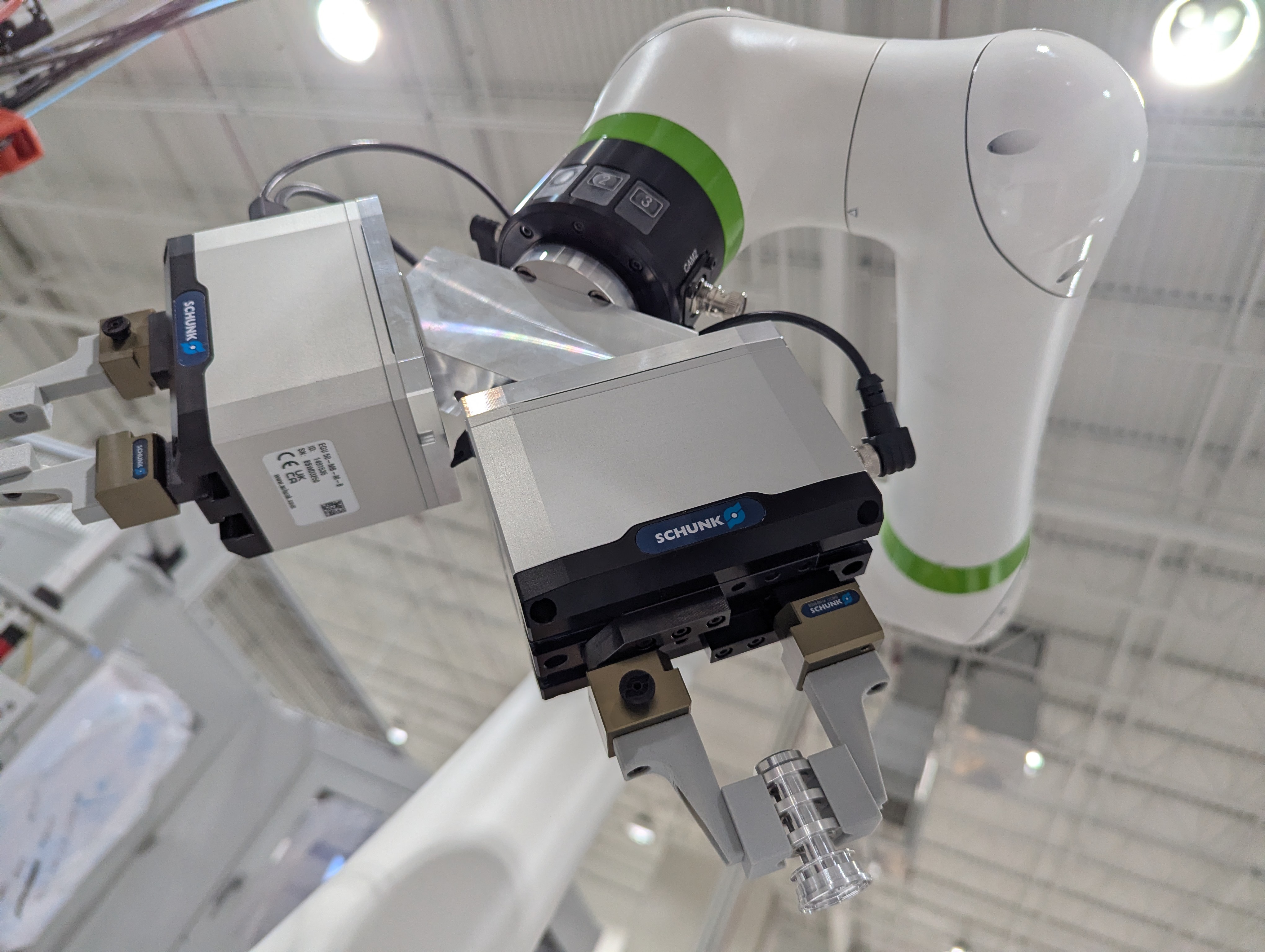

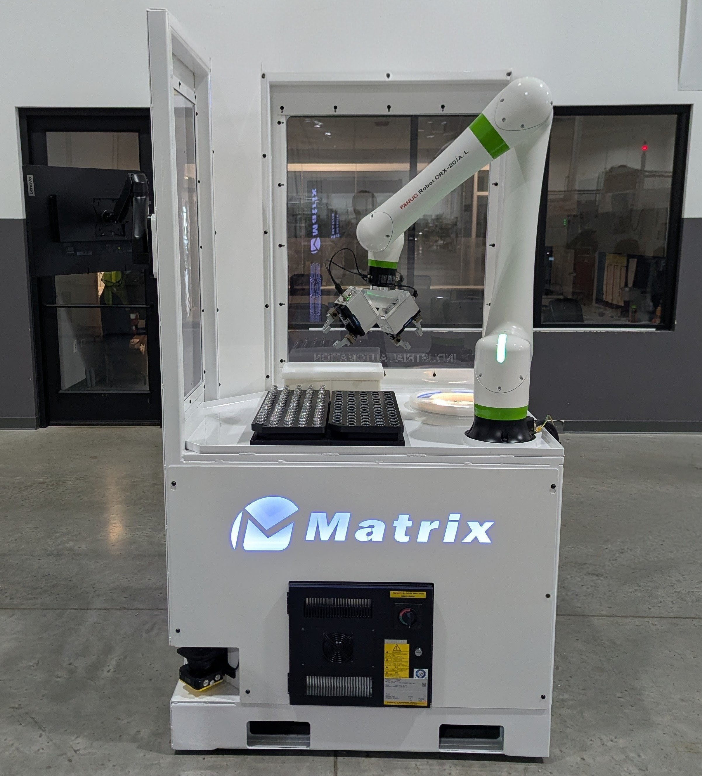

M-Tend is Matrix’s standard collaborative machine tending cell built on the FANUC CRX-20iA/L robot to pick, tend, wash, blow off, and stage parts within a compact enclosed workstation. It uses dual Schunk electric grippers, quick-change fingers, part staging nests, a wash dunk tank, and a blow-off station to create a continuous, repeatable production process from raw part loading to finished part staging.

  • Machine Tending with Integrated Cleaning & Drying
  • Dual Electric Schunk Grippers for Flexible Picking
  • Quick Change Gripper Fingers
  • Modular Design, Can Add Additional Operations
  • Every Systems Comes Standard with SICK Safety Scanner
  • Palletized Base with Pallet Jack Pockets
