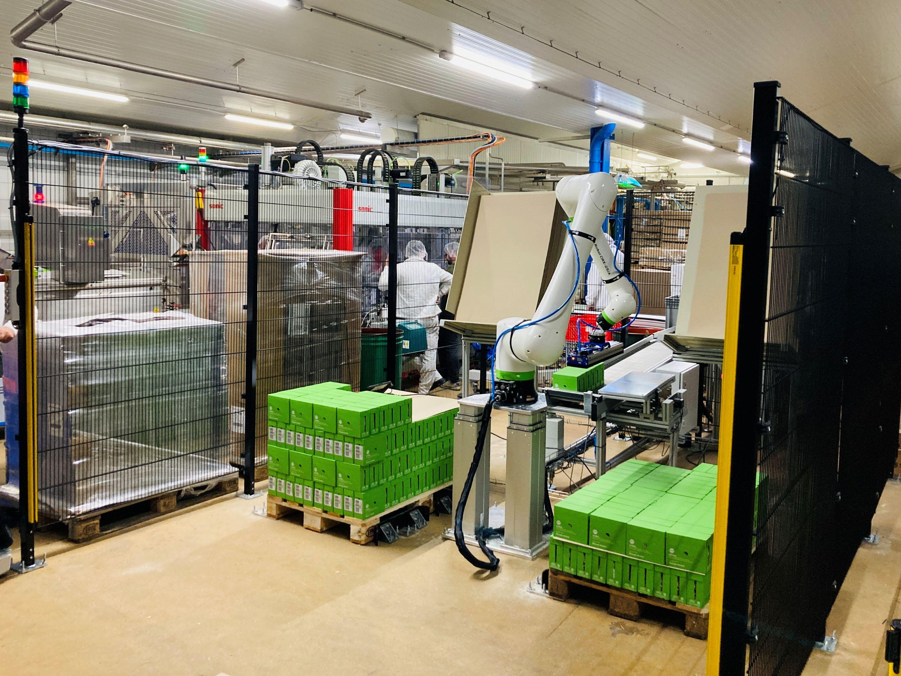

  • Collaborative application, if process conditions for collaborative operation are fulfilled.
  • Safety fence with light curtain
  • Area scanners
