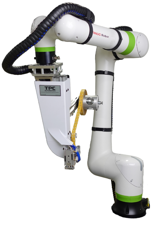

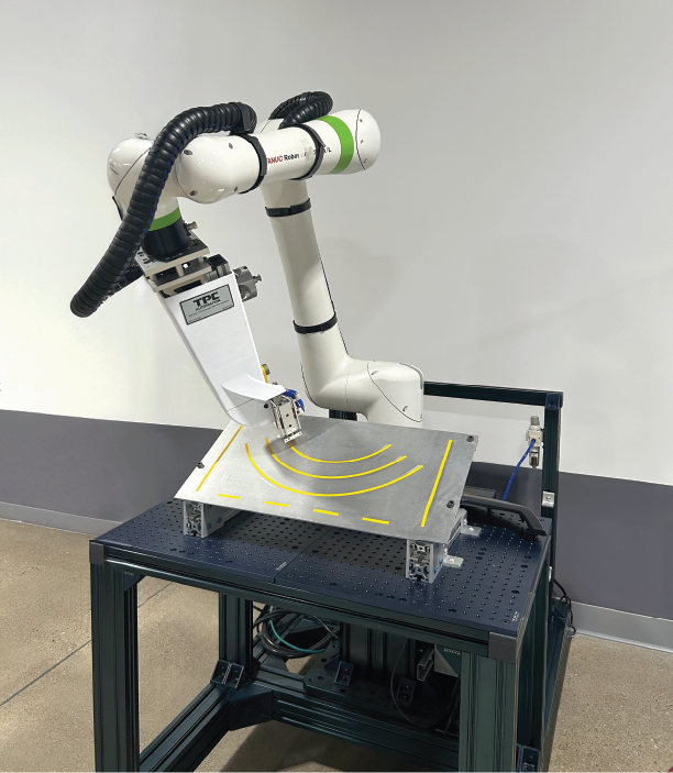

The TPC robot tape applicator combines a robot with our custom tape head extension to provide a solution for your industrial manufacturing and/or packaging needs. This automated solution applies tape consistently with speed and precision, even on uneven surfaces and in applications that require cutting tape at a radius.
Features
Solution Features
Highlights
  • Speed: Fast, consistent tape application
  • Accuracy: Precise placement on flat or uneven surfaces
  • Versatility: Handles straight lines and curved cuts
  • Automation: Reduces manual labor and errors
  • Integration: Easy fit into existing production lines
  • Reliability: Consistent performance in demanding applications

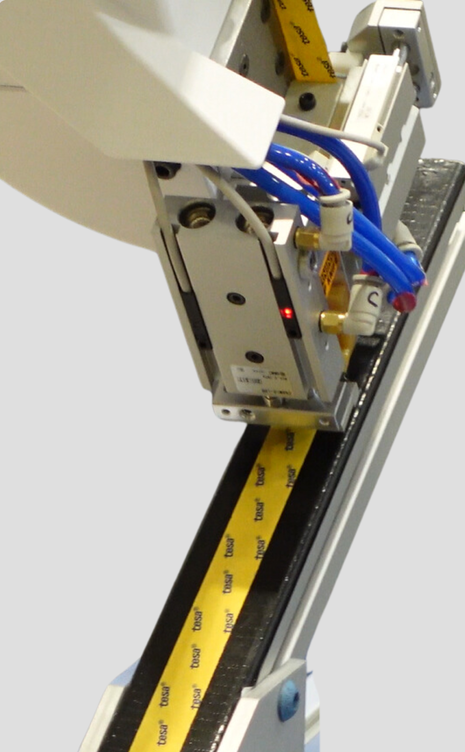

End of Arm Tooling Types
  • 2 vacuum actuated grippers with 4 cups each
  • 1 gripper per robot

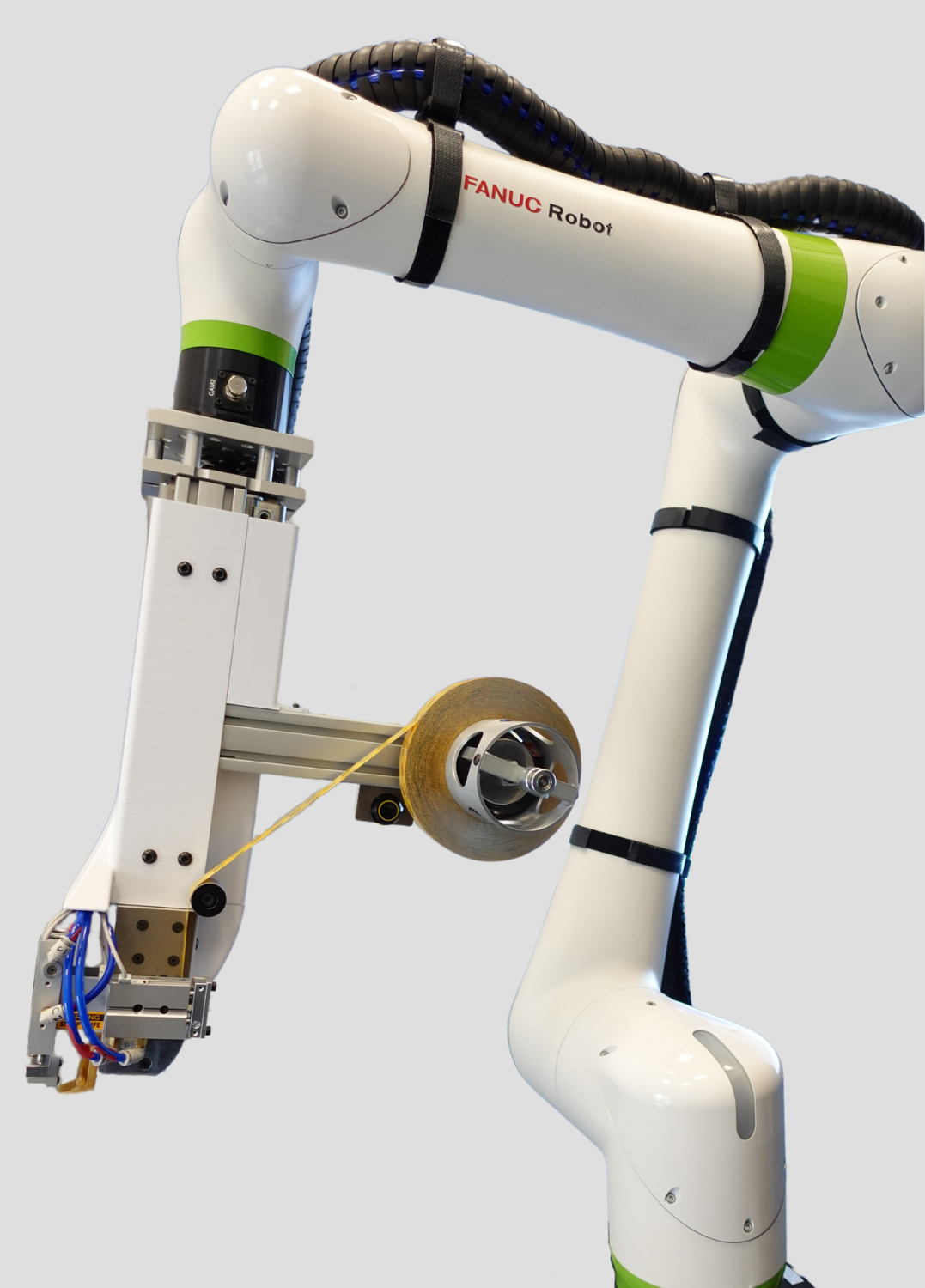

Compatible Robots
CRX-20iA/L
Collaborative
CRX-20iA/L
20 kg
1418 mm
View CRX-20iA/L
