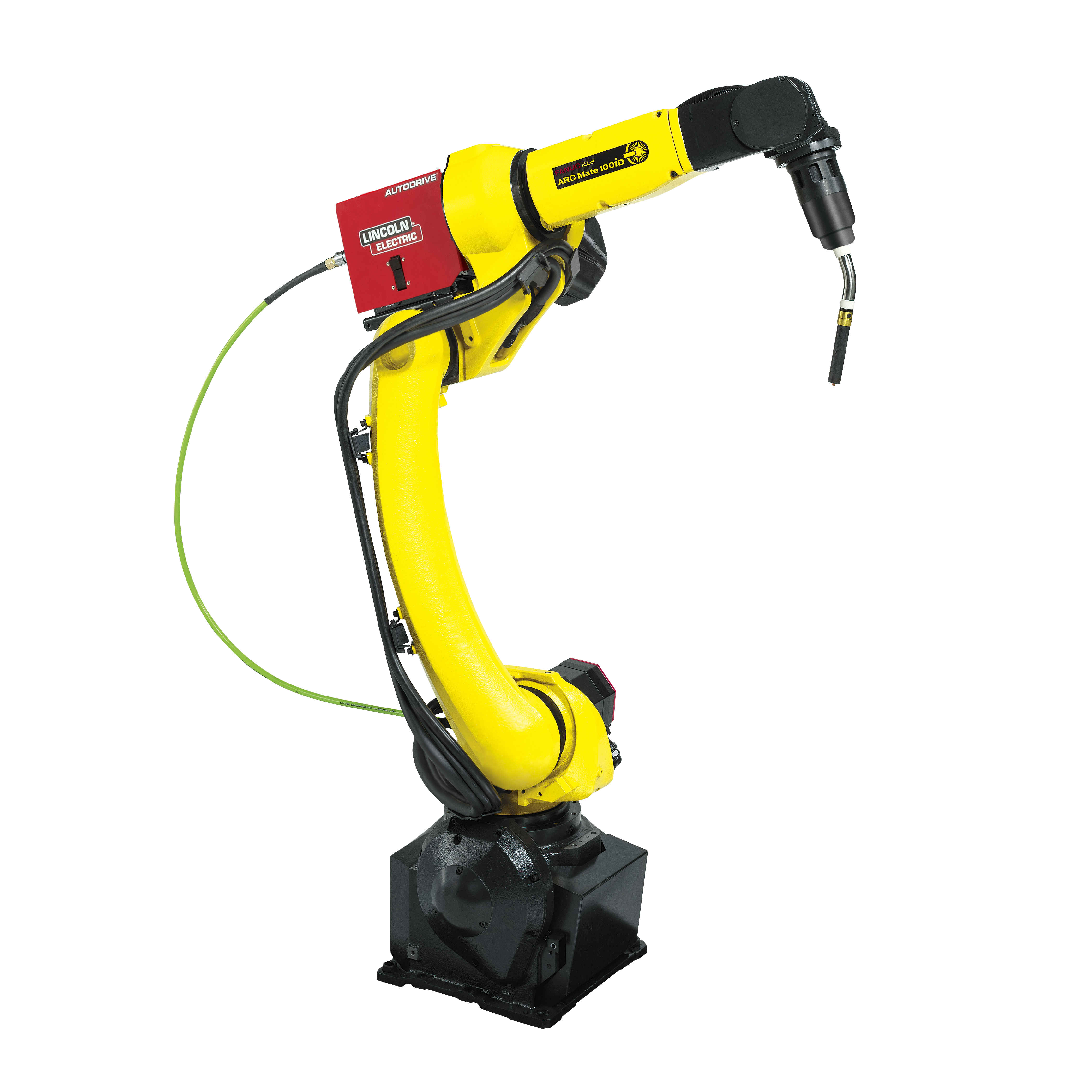

Yellow FANUC robotic ARC Mate 100iD welding arm with a Lincoln Electric AUTODRIVE wire feeder mounted on it and a black welding torch at the end, shown against a white background.
ARC Mate 100i D Welding Setup

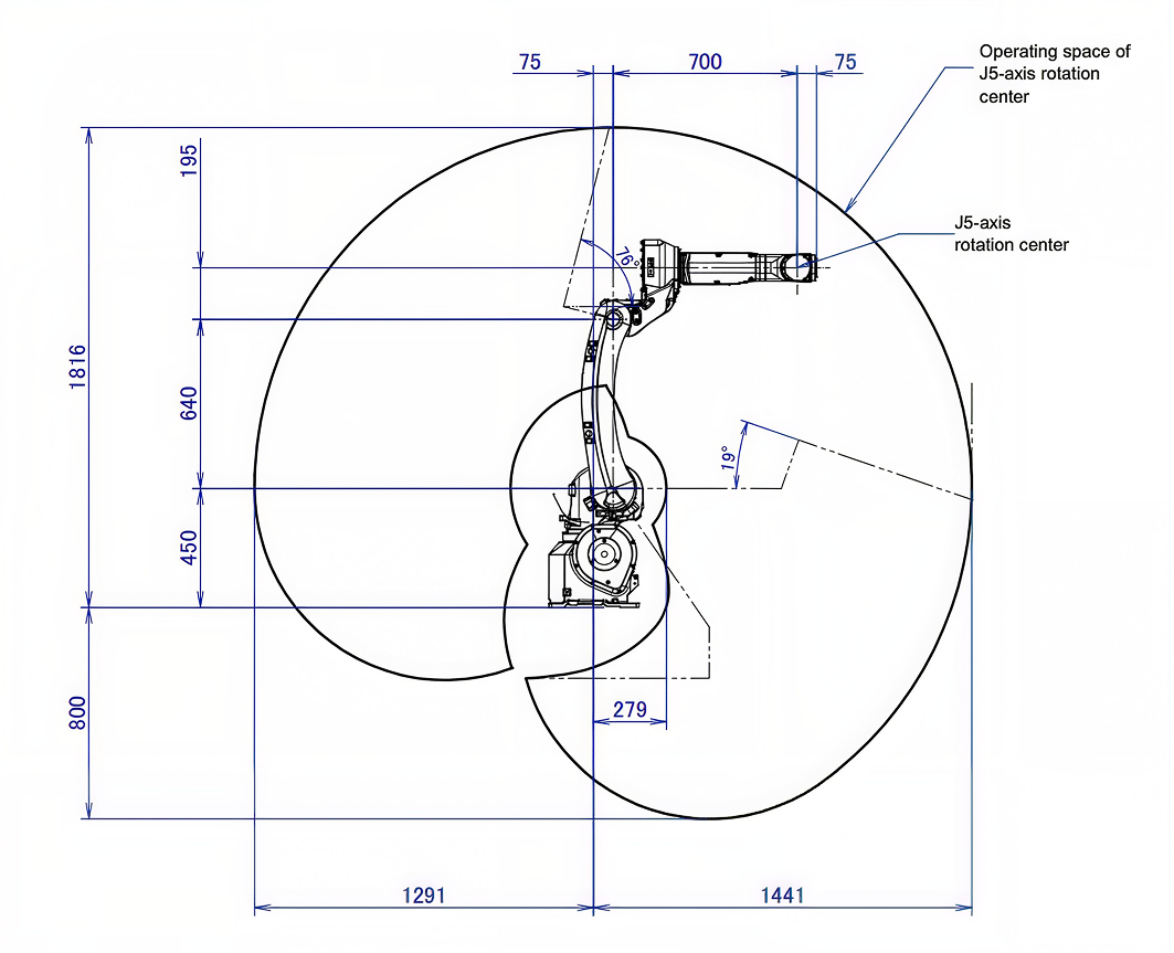

This new generation of arc welding robots stands out based on its productivity advancements and rapid integration times. To utilize space more efficiently, the new ARC Mate 100iD has received a more sophisticated, curved design, which allows it to effortlessly operate in compact welding cells. It features a fully integrated welding hosepack and utility cables, which further economizes the workspace. A larger workspace, reach and stroke, even in the backflip area, allows for a bigger working range. Improved rigidity and repeatability together with faster motion speed, mean increased productivity.
FANUC ARC Mate 100i D Welding
Ideal for Compact Installation Requirements
This arc welder allows for easy routing of the welding dressout and seam tracking sensor cables throughout the robot. It eliminates robot interference with peripherals and work cell equipment, improving the overall system reliability and ease of use.

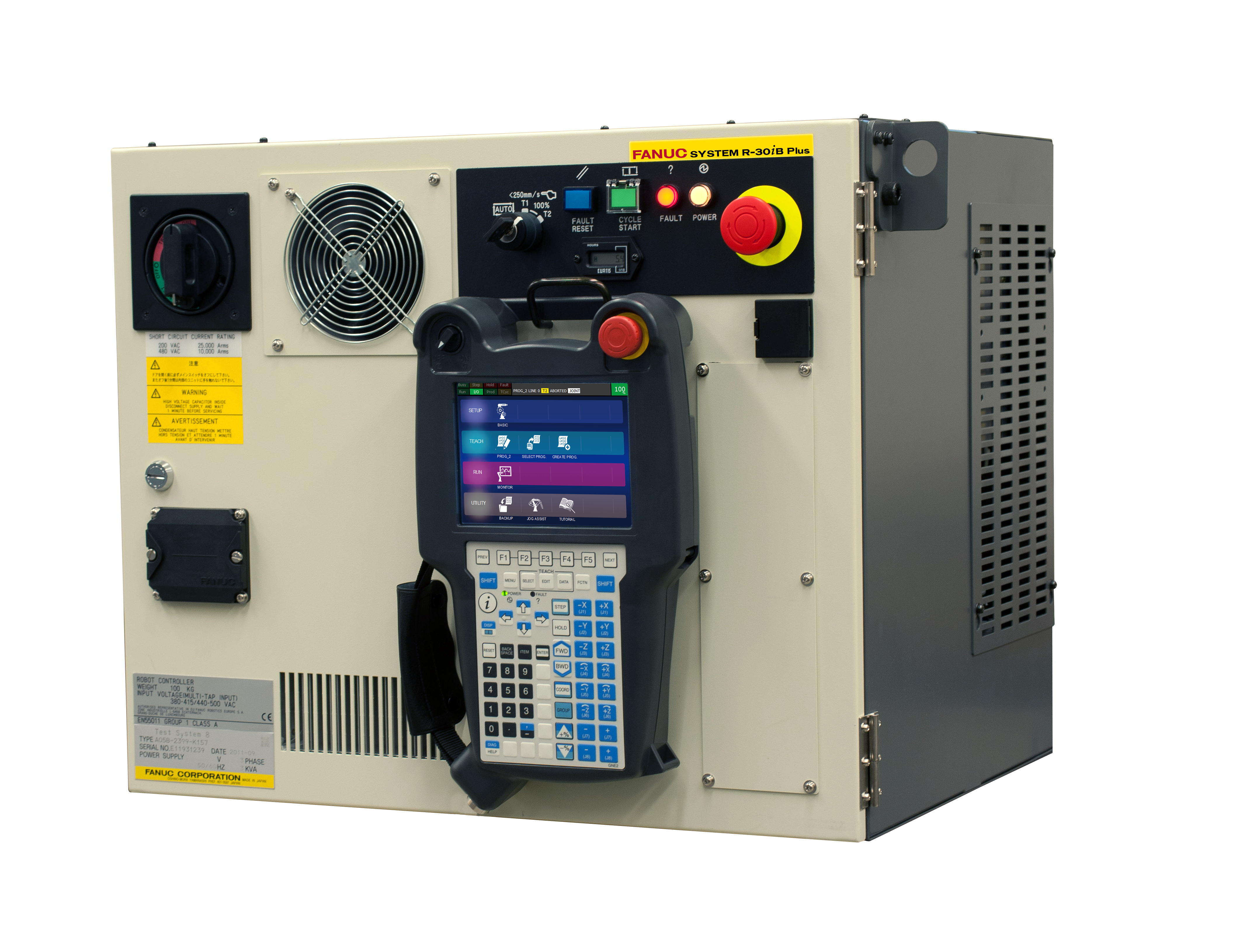

Meet the Controller
The ARC Mate 100iD features the robot controller R-30iB Plus, which now has a more flexible appearance, based on an improved user interface.

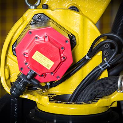

J1 Hollow Reducer
Largest J1 hollow reducer (108mm)
Through a facilitated routing of welding dressouts, third party supplies and sensor cables from the robot flange can be lead through axis 1. It allows the design of more compact welding cells with less interference with peripheral equipment.

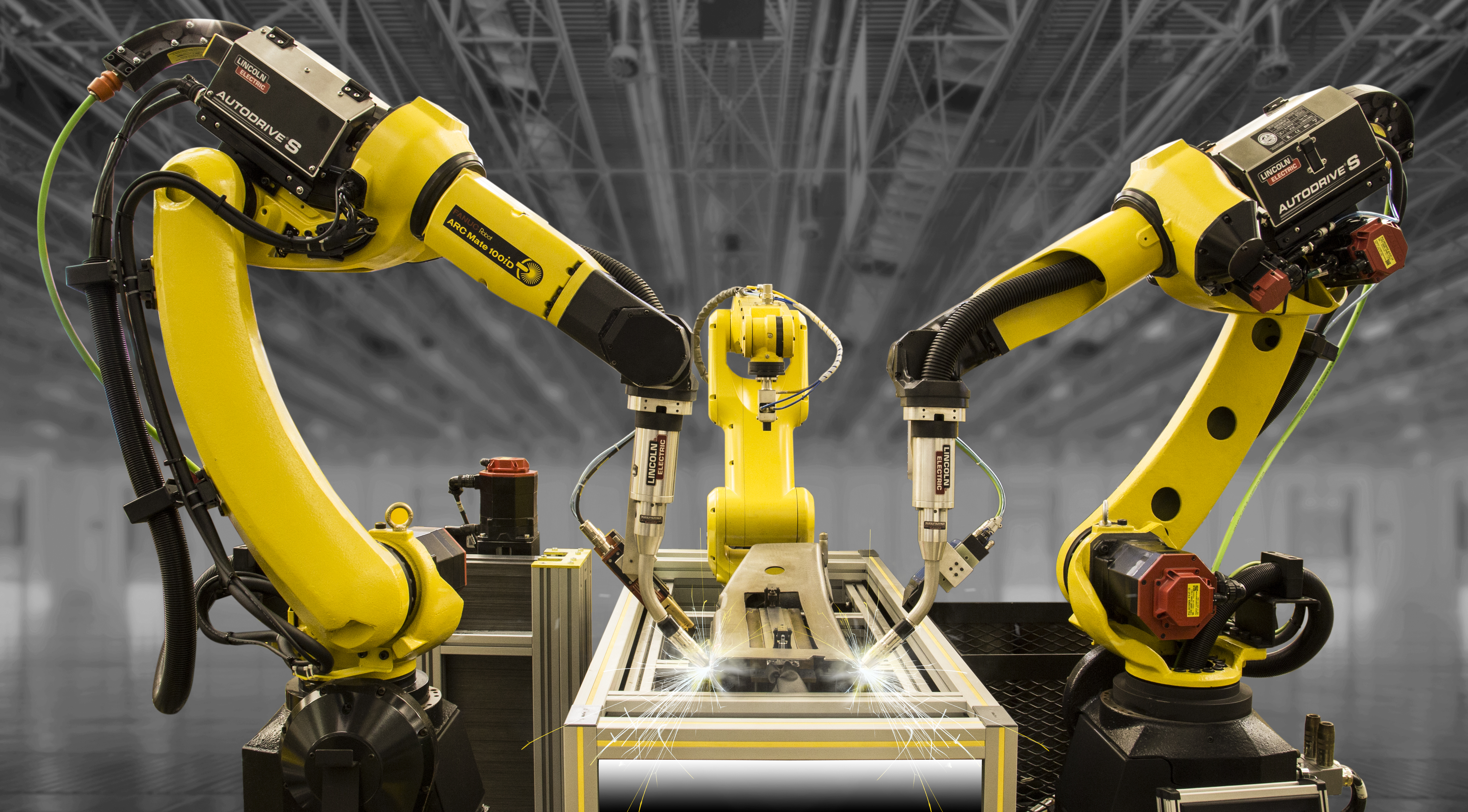

Dual ARC Mate 100i D LR Mate 200i D
Hollow Wrist for High-Density Layouts
The torch hosepack as well as additional utilities such as seam tracking sensor cables, vision cables, or air pipes, are routed through its hollow arm and wrist, enabling it to fully articulate to reach narrow spaces in jigs and tight fixtures. This arc welding robot features the largest hollow wrist in its class with 57mm.
12 kg
±0.02 mm
1441 mm
Footprint
343 mm x 343 mm
130 kg
1 kW
340°
235°
450°
380°
380°
900°
240°/s
240°/s
230°/s
430°/s
430°/s
650°/s
26/.9
26/.9
11/.3
IP54 / IP55

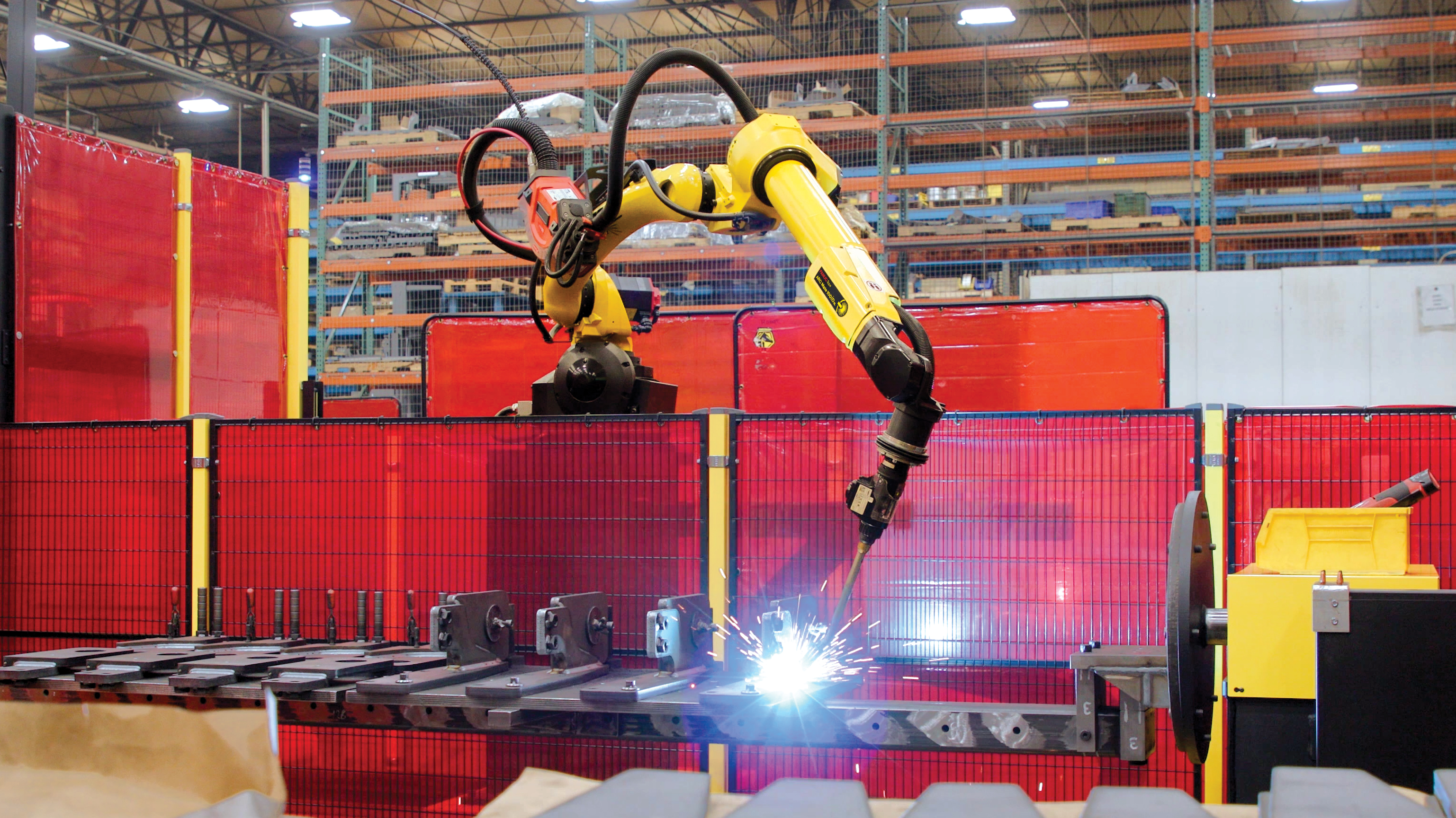

See It In Action
Acieta FastArc PW Welding Solution
With the FastARC PW system, ports are welded quickly, with high-quality and accurate welds.
Acieta LLC
Video courtesy of Acieta LLC

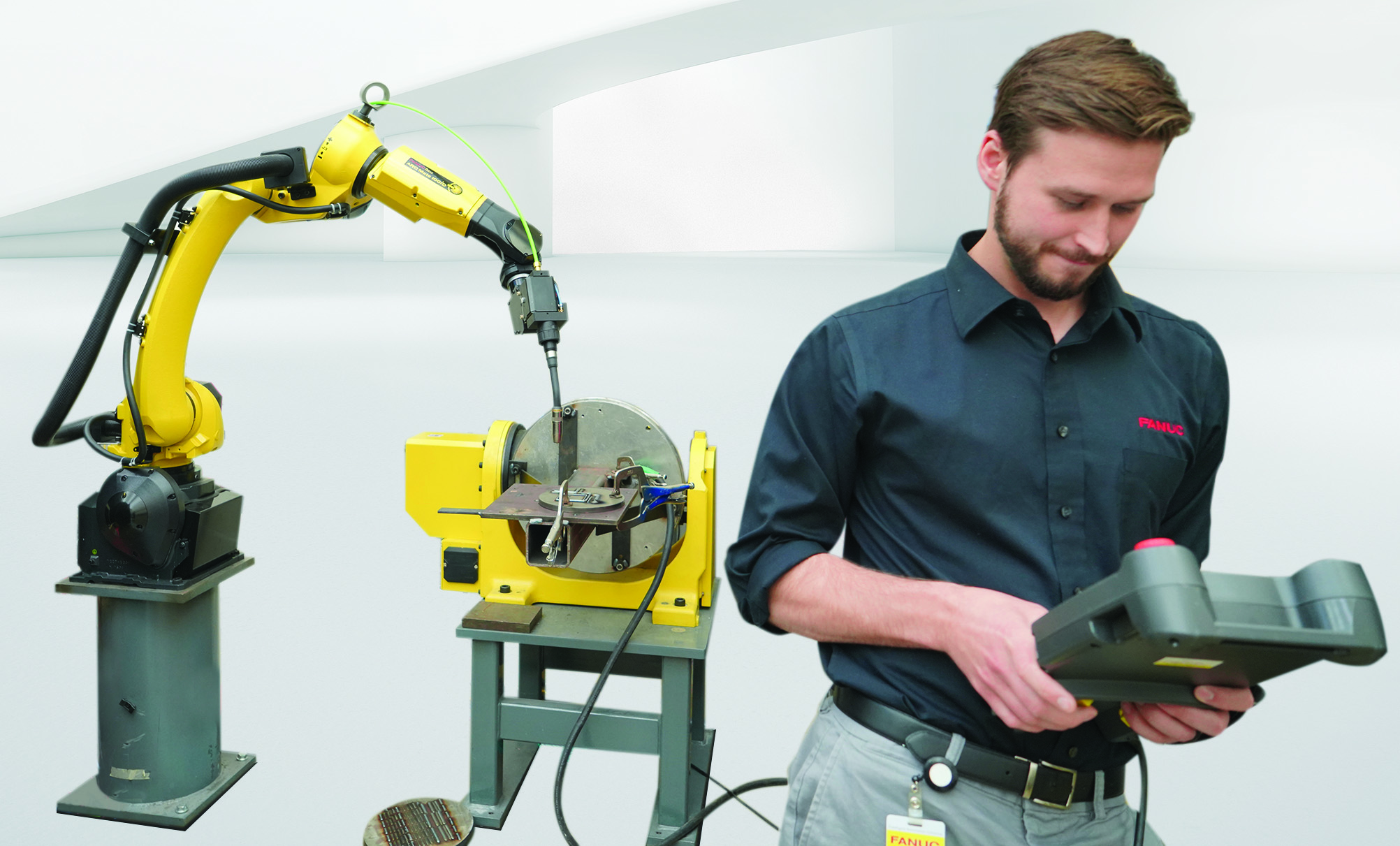

ARC Mate 100iD - ARC Welding
An ARC Mate 100iD robot performs arc welding as a single‑axis positioner rotates the part for optimal weld access.
