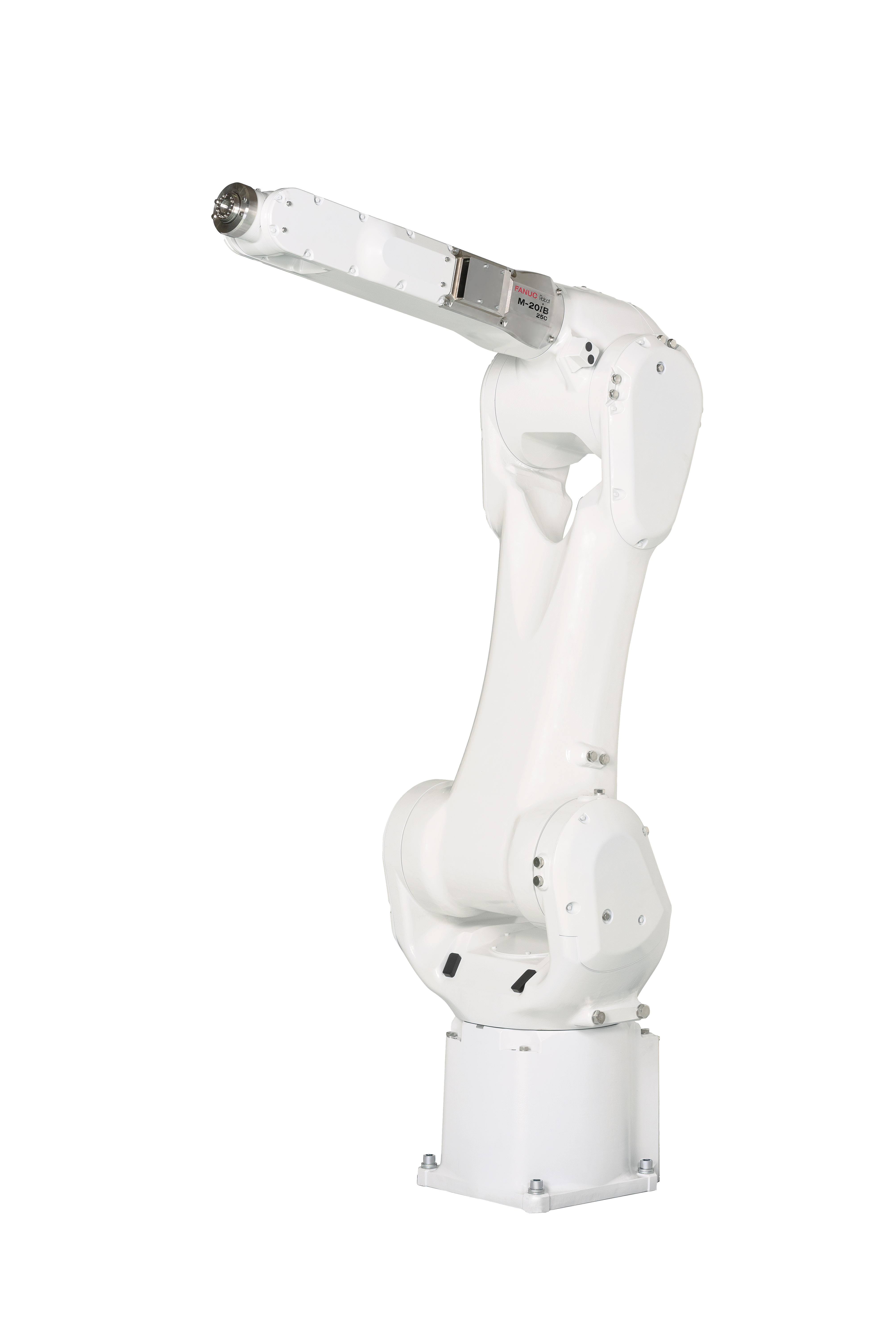

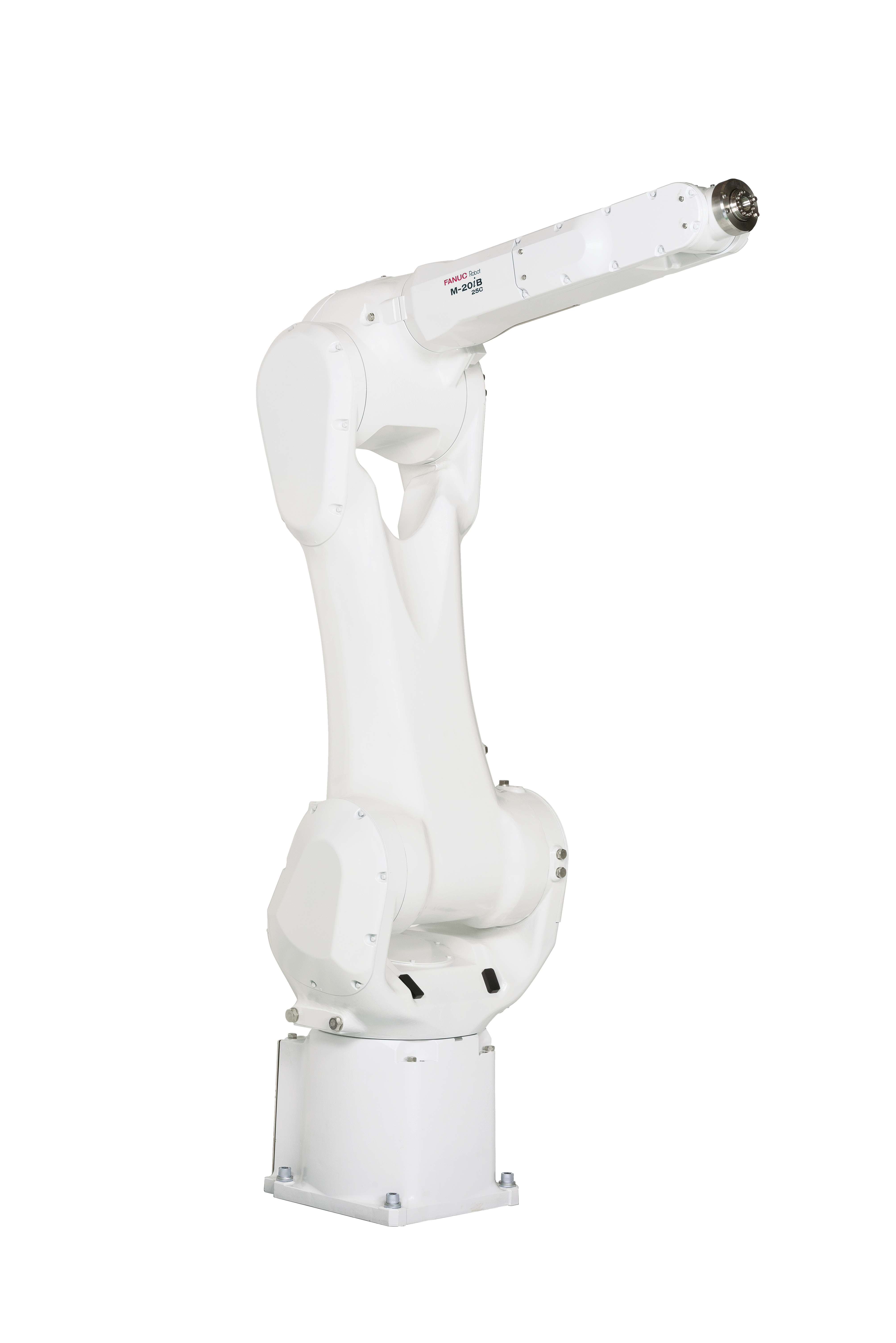

M-20 Series
M-20iB/25C
25 kg
1853 mm
210 kg
The FANUC M-20iB/25C comes in special white paint indicating its resistance against cleaning agents and used in daily wash down operations typical for cleanroom environments such as 2nd-Food areas or the medical, optical, pharmaceutical or electronics industry. This model, based on the M-20iB series, was built with the intent to meet the standard requirements (IP67 standard) of such demanding environments - with no compromise of robot speed and repeatability. Based on its slim, entirely encapsulated design, the cleanroom robot reaches high flexibility levels, adding versatility to its ability to perform applications within compact cells.

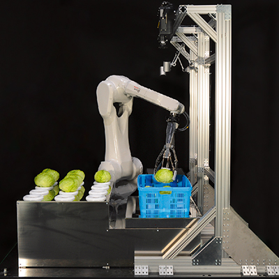

M-20iB/25C Handling Lettuce
Automating delicate processes
This Cleanroom Robot is an ideal fit for the semiconductor industry, as it has the necessary accuracy and repeatable precision to produce sensitive medical parts at a high-level (e.g. mirrors and lenses). Furthermore, its speed allows manufacturers from the 2nd food area to increase their output through extremely fast processing, and handling of goods (e.g. getting raw materials on the production line, or handling goods at different stages of the production process) within today’s competitive food market.

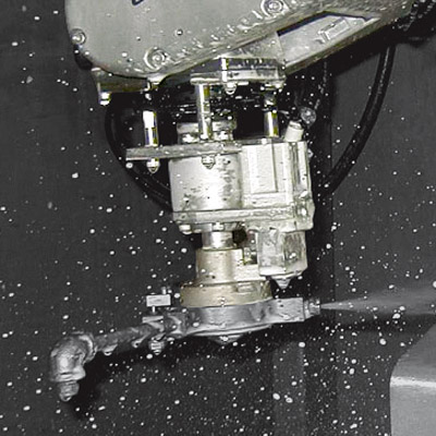

Enclosed robot design
Compared to the standard FANUC robot model, its sturdy, waterproof design renders it an ideal for every type of production environment involving food or other hygiene-sensitive materials - whether wet or dirty. Having all cables or motors integrated in its arm, and due to its special white coating, the robot is IP67 rated, making it waterproof, hence apt to be washed. As all six axes of the robot arm are equipped with food lubricant by default, it makes it perfect for the 2nd-Food or pharmaceutical manufacturing area.

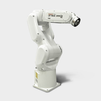

Need an even shorter reach?
Check out the LR Mate 200iD/4SC Cleanroom Robot - it has the shortest reach with 550 mm for extra compact robot cells.
