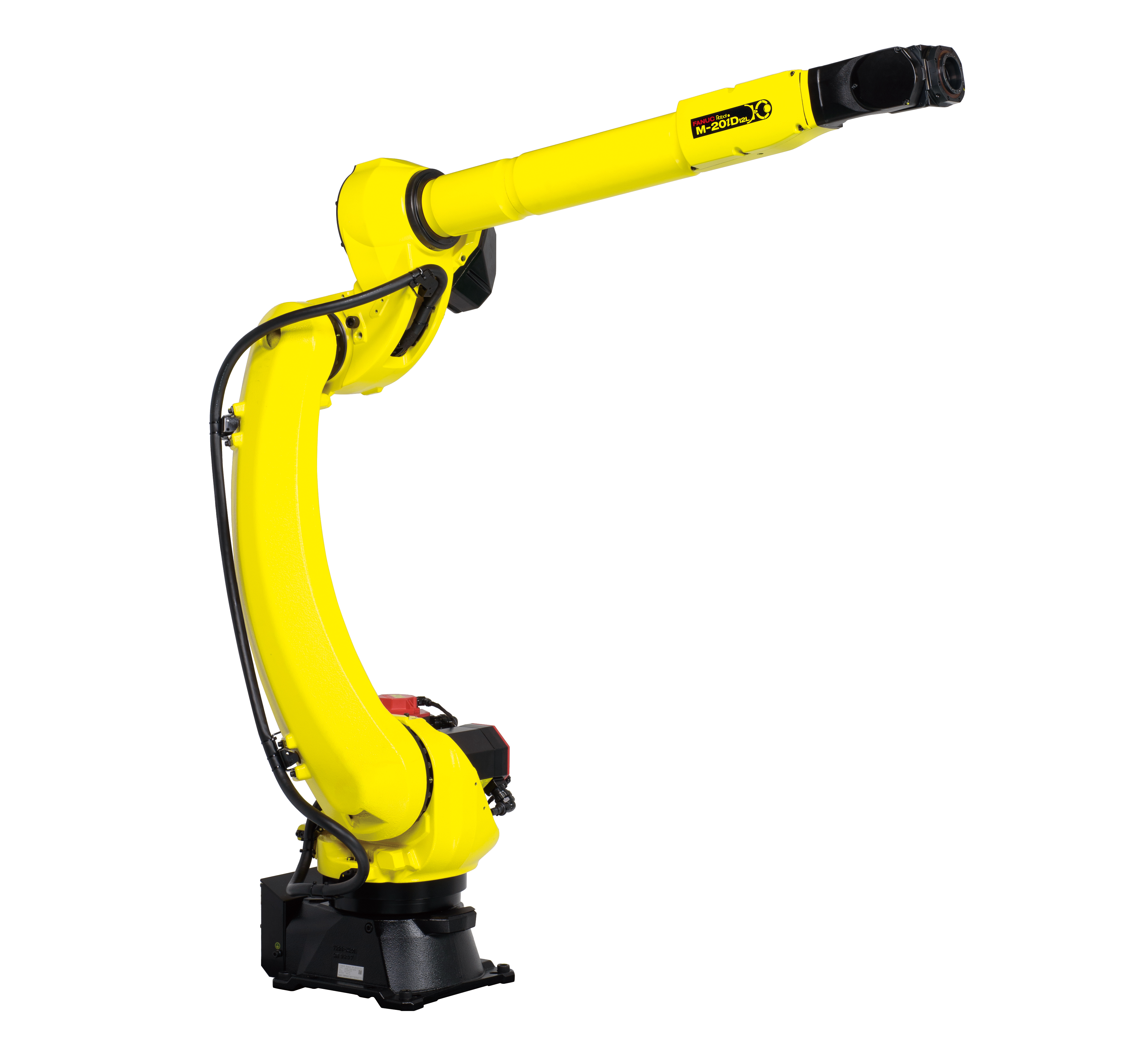

M-20 Series
M-20iD/12L
12 kg
2272 mm
250 kg
Designed specifically for handling applications, this model features outstanding axis speeds and ultimate precision within its class. The highly versatile robot can handle large parts thanks to its very long horizontal stroke. To further maximize flexibility and open up a new range of manufacturing application possibilities, it can also carry additional tools weighing up to 12 kg.

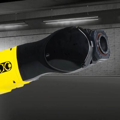

Large hollow wrist
To prevent the risk of snagging and cable wear, all cables can be routed through the robot’s large 57 mm diameter hollow wrist and hollow arm.

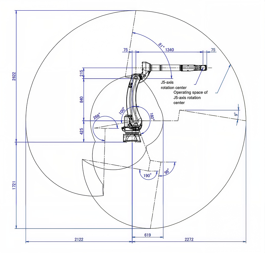

12 kg
±0.03 mm
2272 mm
250 kg
1 kW
340°
260°
475°
400°
360°
900°
210°/s
210°/s
265°/s
420°/s
450°/s
720°/s
22/.65
22/.65
9.8/.17
IP54 / IP65
