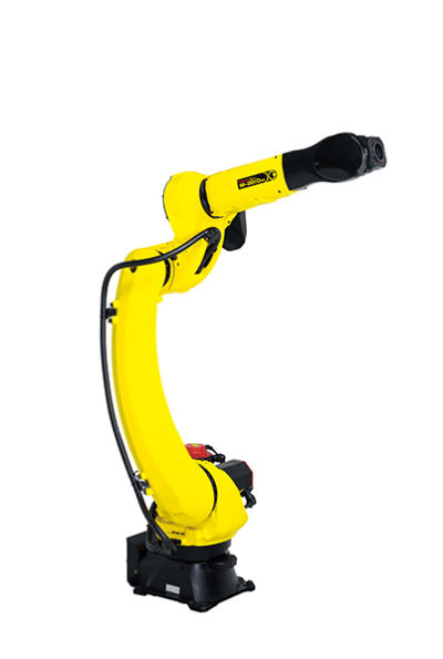

M-20 Series
M-20iD/35
35 kg
1831 mm
250 kg
With a payload of 35 kg this robot is designed for material handling of large parts. Equipped with outstanding axis speeds and ultimate precision within its class this robot is suitable for a wide range of applications.

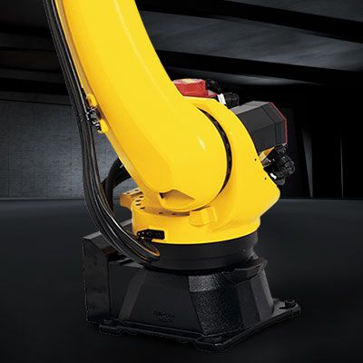

Fully integrated cable management
The M-20iD series features a fully integrated cable management system.

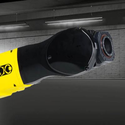

Large hollow wrist
To prevent the risk of snagging and cable wear, all cables can be routed through the robot’s large 57 mm diameter hollow wrist and hollow arm.
