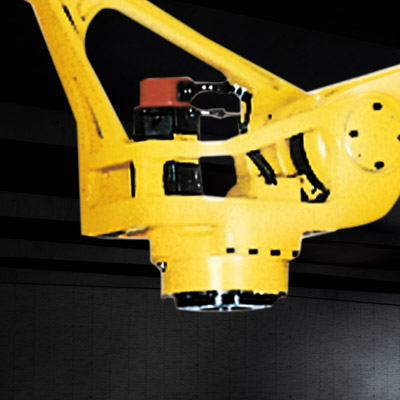

The M-410iC/500 palletizing robot improves throughput and will lift 500 kg. Designed specifically for the job by the company that built the world's first dedicated palletizing robot, the M-410 series is the solution for palletizing and handling applications.
M410ia industrial robot view banner
Flexible pedestal mounting
Depending on the application, the M-410iC/500 can be pedestal mounted for more flexibility. The robot controller can either be housed within the pedestal or separately as an independent unit.
Fea ro pr m410450 l 3
Hollow wrist design
Cable routing through the robot's wrist prevents snagging and increases reliability.
