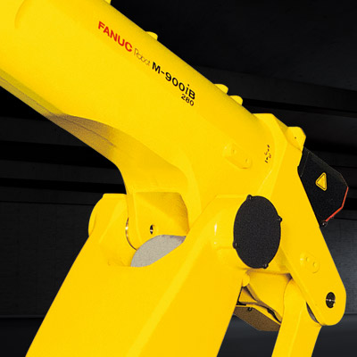

Based on the extremely capable M-900iB/360, the M-900iB/280 features a completely redesigned J3 arm to provide maximum stiffness. The M-900iB/280 has been tested to ISO 9283 rigidity standards and exhibits a very high level of static compliance. This makes it ideally suited to operations where pressure is applied to the tool and accuracy essential.
Fea ro pr m900280 r 2
The stiffness specialist

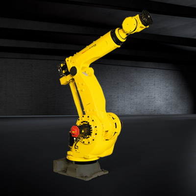

The M-900iB/280 has been purposely developed for flow drill screwing and roller hemming, as well as a range of other applications that demand enhanced rigidity from a robot.

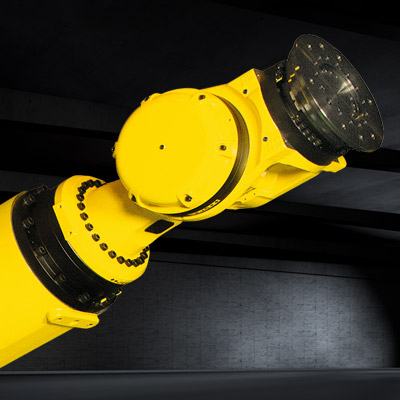

Stiff but flexible
Six axes provide the tool dexterity required to reduce cycle times on operations such as roller hemming.
