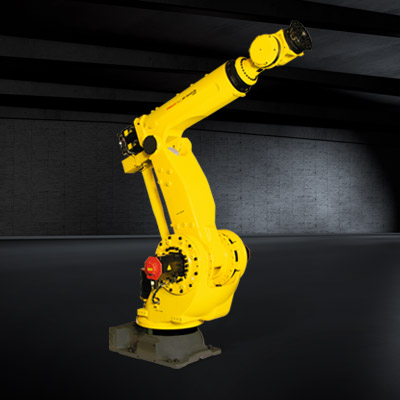

M-900 Series
M-900iB/360
360 kg
2655 mm
1540 kg

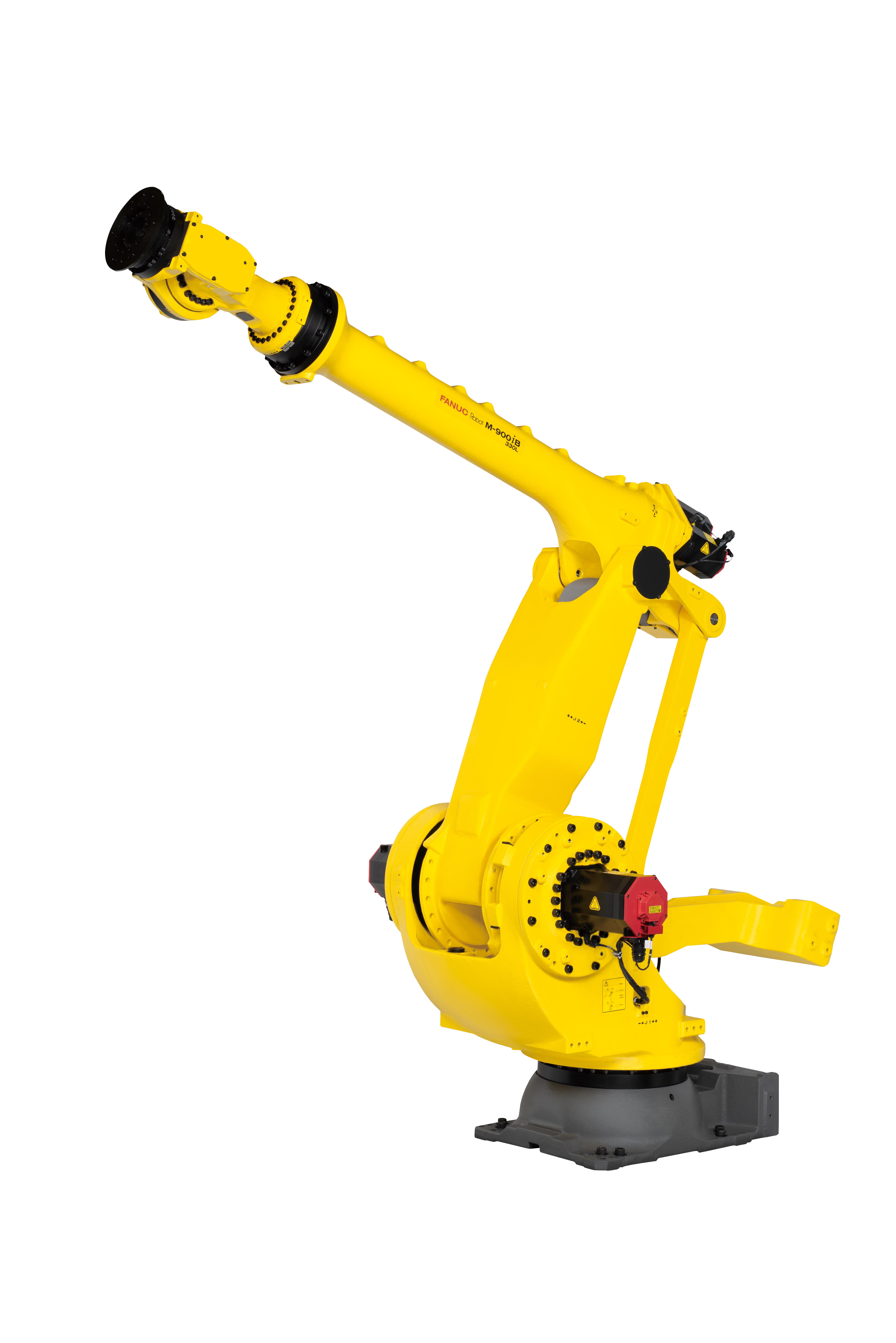

This model is ideally suited to the heavier payloads involved in assembly, parts transfer and machine tending applications. Floor and ceiling mounting options make it extremely flexible, with its 6 axes providing the dexterity required for fast accurate handling. Faster cycle times and higher loads are enabled though improved cooling.
M900ia steel sheet robot banner
The flexible M-900
Ideal for heavy assembly, welding and loading tasks within a large envelope.
Fea ro pr m900280 r 2
Compact, space saving design
The "lightweight" hollow wrist design on this model protects motors from heat and harsh environments and enables higher loads and duty cycles through improved cooling.
M 900 robot upside banner
Various mounting options
This model comes with ceiling, floor, angle and wall mounting options where space is a concern.
M900ib 360l robot drive banner
Optional severe dust and liquid protection (SDLP)
Additional robot base, drive train and J1 J2 axis protection kit available to provide dust and water protection. J3 arm and wrist come with IP67 protection as standard.

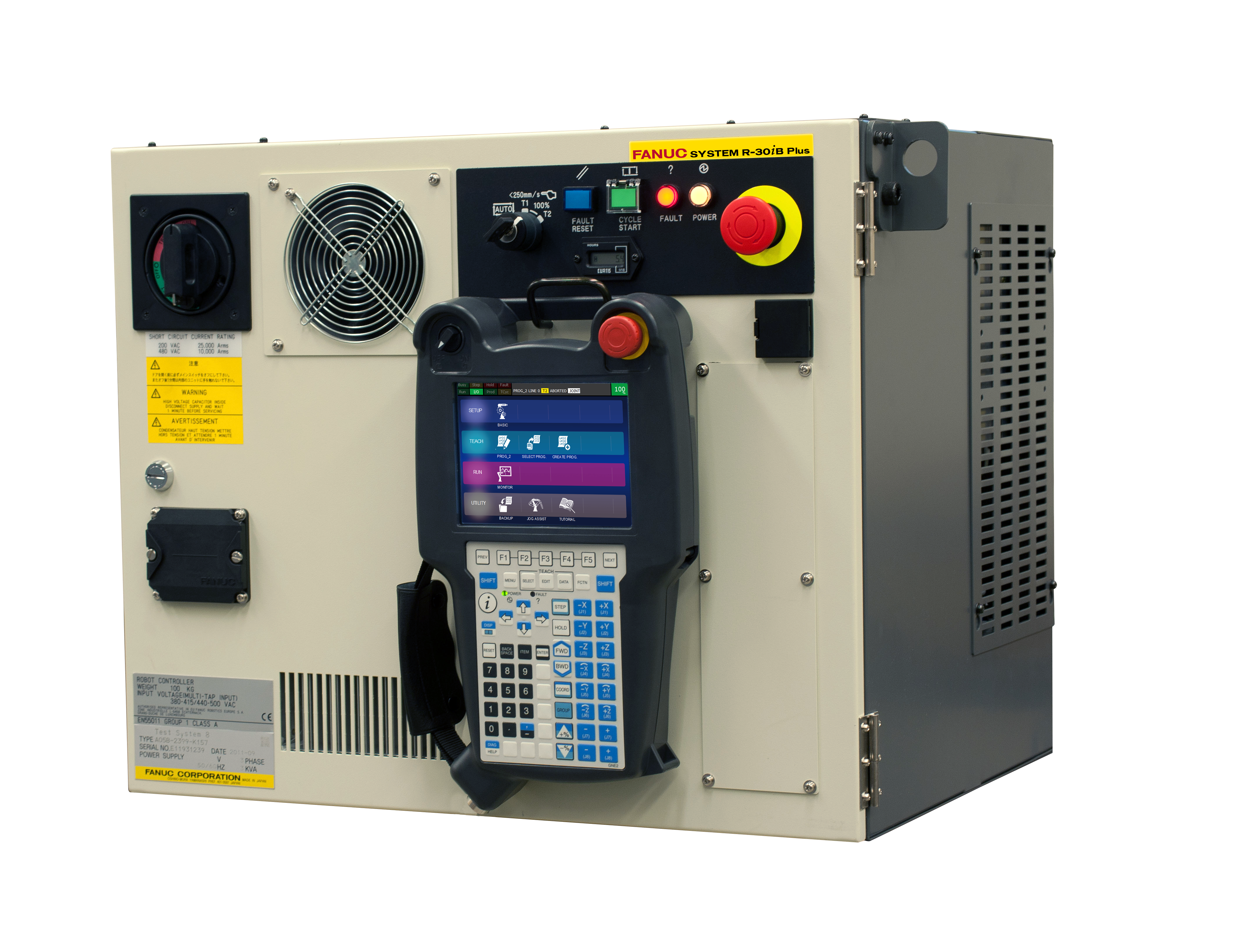

R-30iB Plus A-Cabinet
View R-30iB Plus A-Cabinet

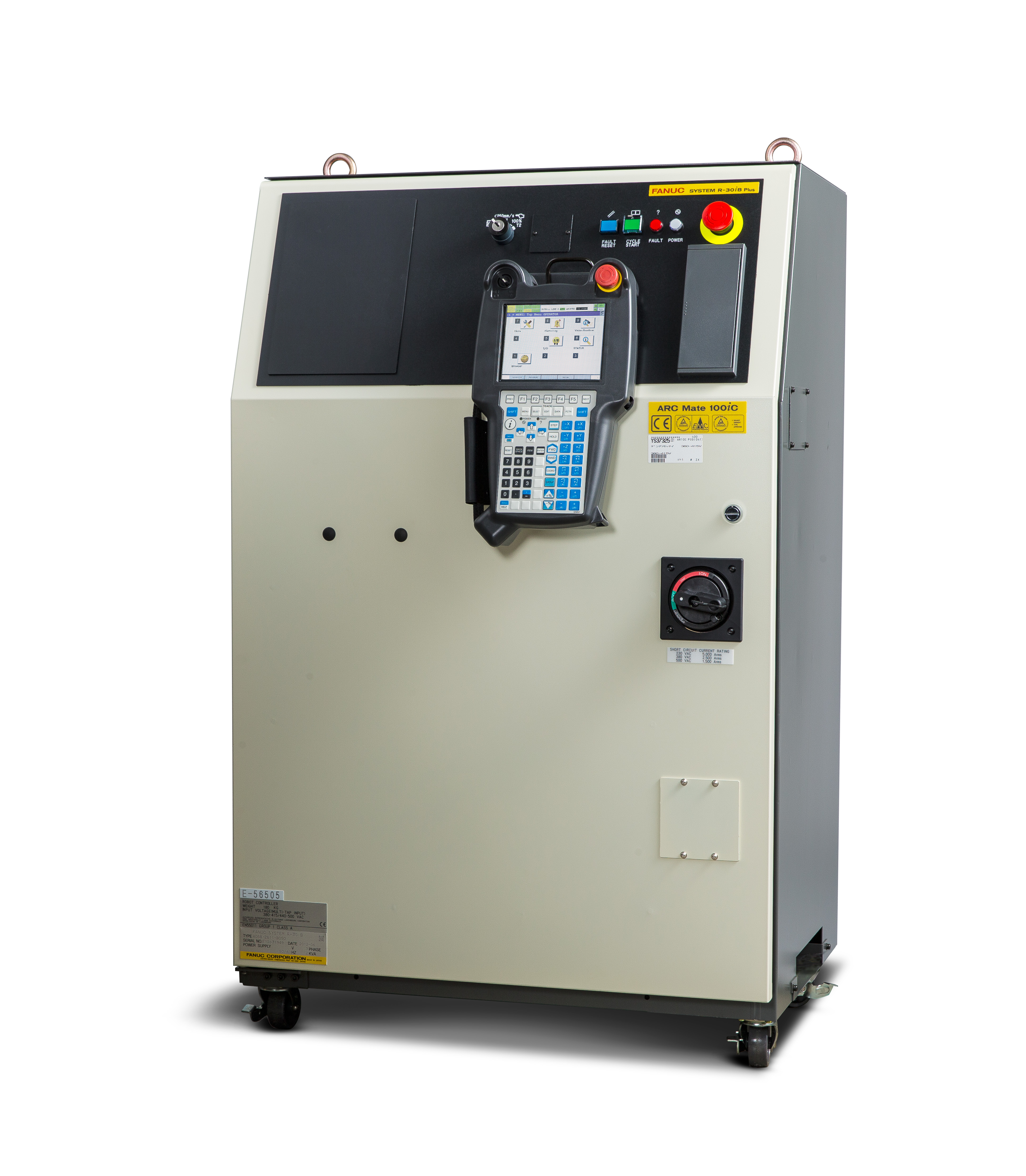

R-30iB Plus B-Cabinet
View R-30iB Plus B-Cabinet

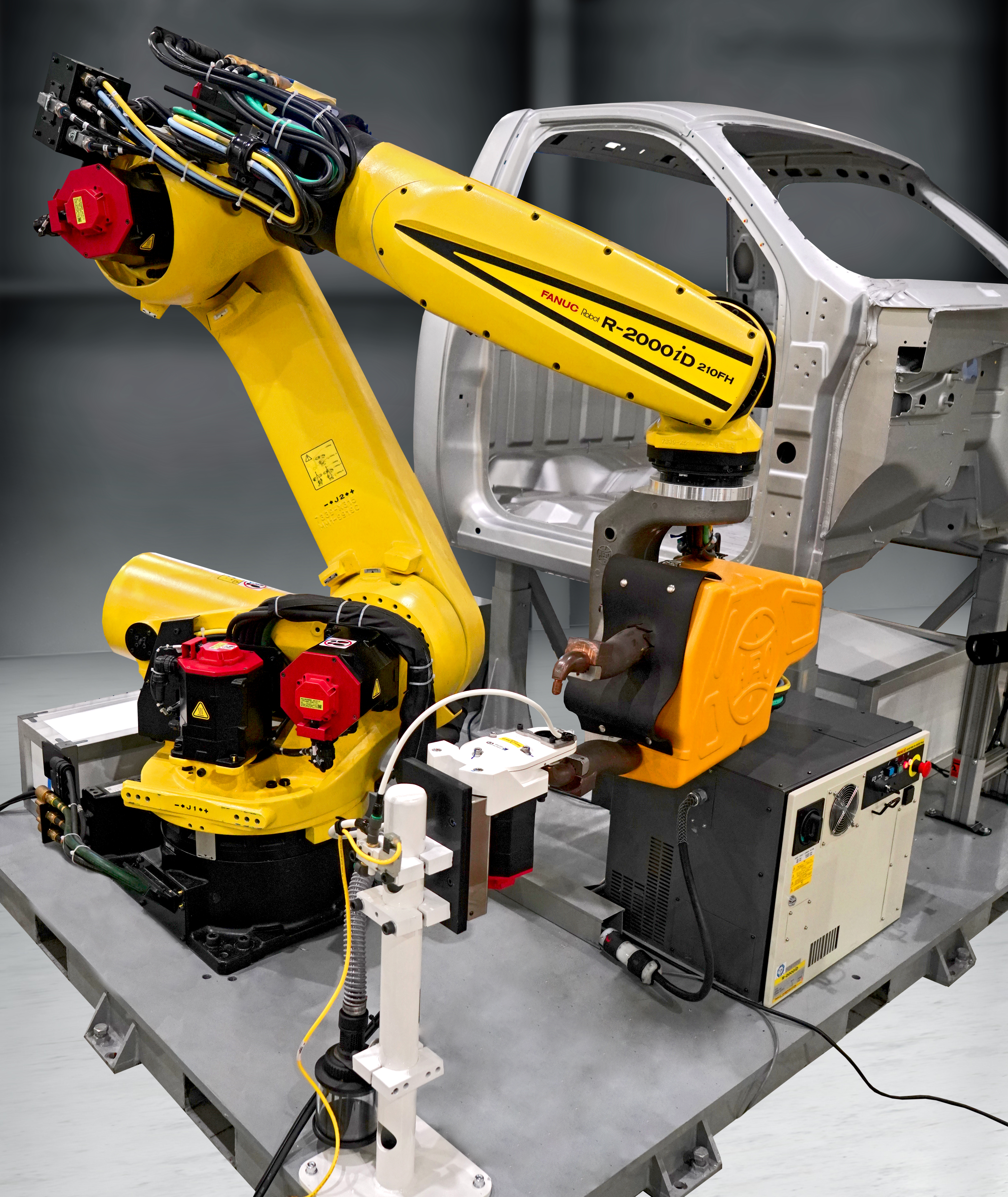

R2000i D 210 FH Tip Dresser
Spot Welding
