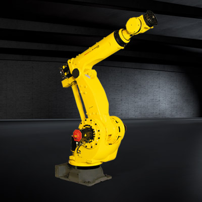

M-900 Series
M-900iB/400L
400 kg
3704 mm
3150 kg
Thanks to stable floor mounting and a huge lifting capacity this model is ideally suited to applications involving heavy payloads. Additional flexibility is provided by its extended reach and 6 axes. This makes it a great solution for processes requiring heavy-weight handling within a wider work envelope.
M900ib 400l robot arm banner
Long and robust arm
Tough and strong, this model boasts a super-long reach and 400 kg payload.
Fea ro pr m900280 r 2
Floor mounting
Stable floor mounting and a huge lifting capacity make this model ideal for heavy loads.
M900ib robot pedestal driving train banner
Severe dust and liquid protection (SDLP) option
With J3 arm and wrist IP67 protection as standard, this model is also available with a robot base, drive train and J1 J2 axis protection kit
M900ia robot forge welding banner
Heavy weight
Ideal for loading, unloading and handling heavy workpieces, palletizing (complete layers), press transfer and heavy duty spot welding.
Compatible Controllers
R-30iB Plus B-Cabinet
400 kg
Floor
±0.10 mm
3704 mm
3150 kg
5 kW
360°
154°
160°
244°
80°/s
80°/s
80°/s
100°/s
100°/s
160°/s
2744/1098
2744/1098
1725/444
IP54 / IP56
