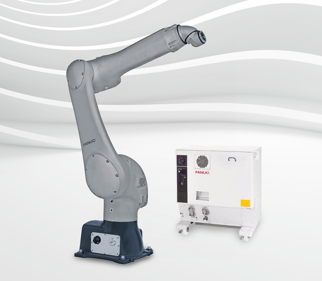

FANUC’s new P-55/15-21A paint robot delivers easy operation and high-quality performance for both industrial and automotive applications. With a 2-meter reach, 15 kg payload, and right or left hand configurations, it handles large parts and flexible line layouts. The new R-50iA controller simplifies installation and maintenance with a single-cabinet design, while updated software improves path accuracy and coating quality. Battery-less encoders further reduce upkeep, making the P-55/15-21A a reliable, low-maintenance solution for efficient, consistent painting.
