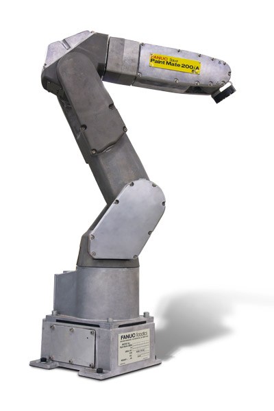

Paint Series
Paint Mate 200iA/5L
5 kg
892 mm
37 kg

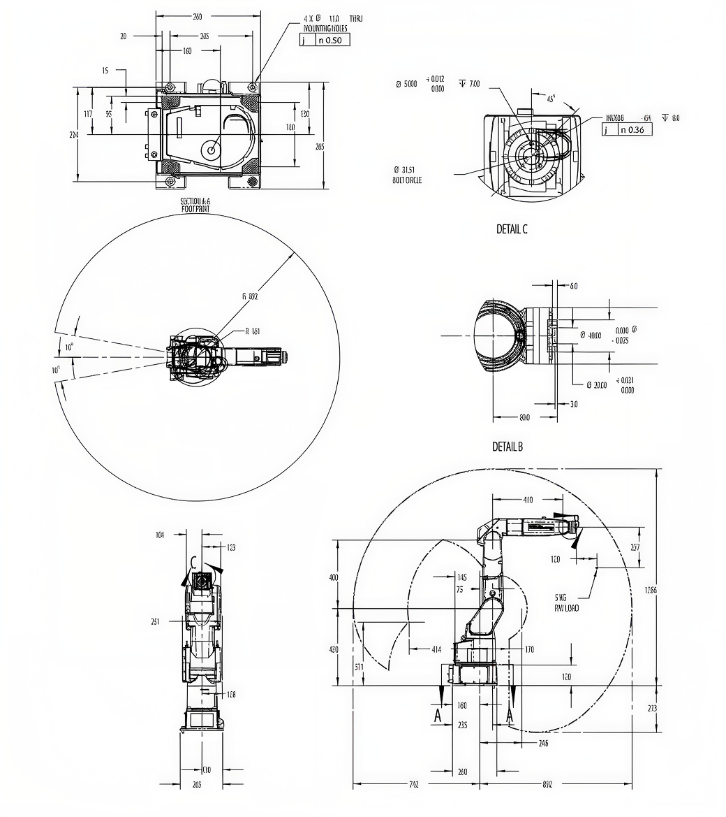

The long arm Paint Mate 200iA/5L is a versatile, compact paint robot with an increased maximum reach and 5 kg payload capacity. Ideal for painting applications, assembly and handling operations requiring increased reach even in hazardous environments.
5 kg
Floor / Angle / Inverted / Rail
±0.03 mm
892 mm
37 kg
340°
230°
373°
380°
240°
270°/s
270°/s
270°/s
450°/s
450°/s
720°/s
11.9/.3
11.9/.3
6.7/.1

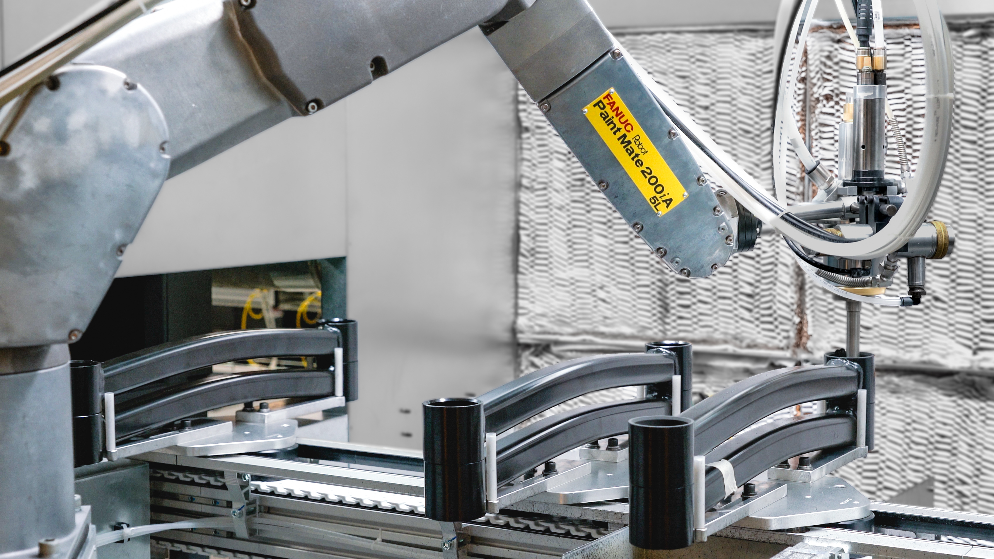

Control Arm Robotic Coating and Painting
Paint Mate 200iA/L robot efficiently coats control arms using a flexible power‑and‑free pallet system with precise positioning.
Turbo Spray Midwest Inc.
Video courtesy of Turbo Spray Midwest Inc.
