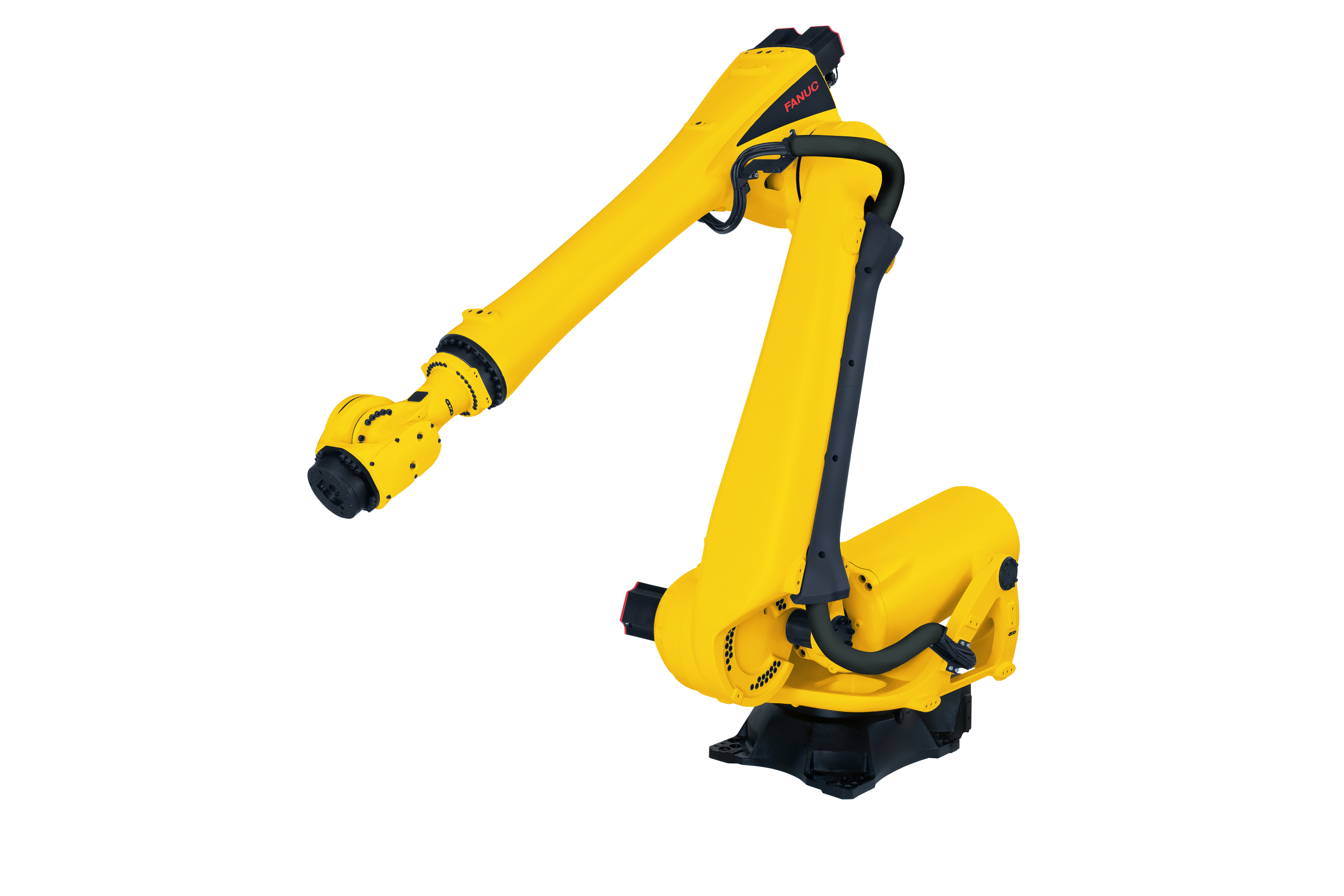

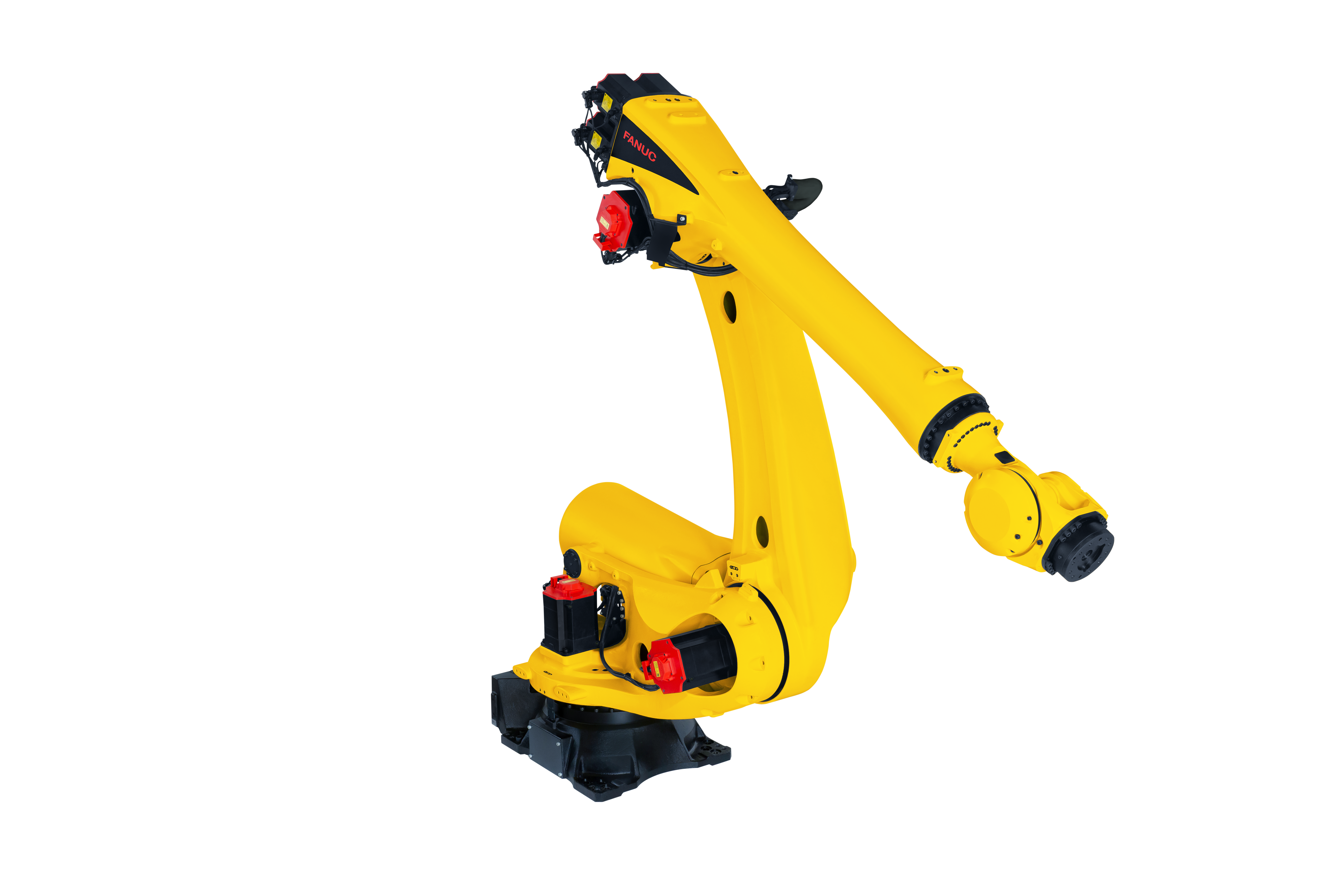

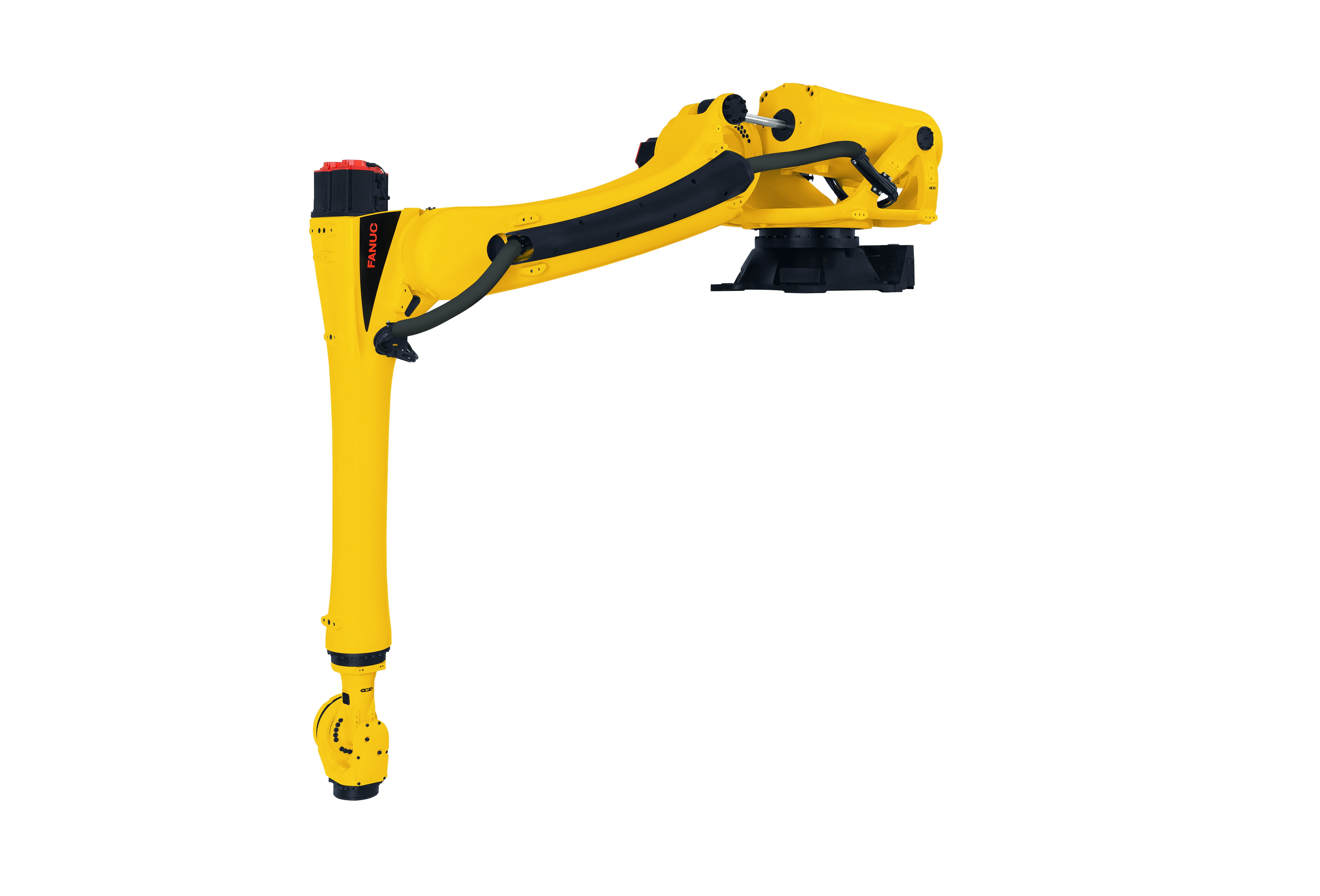

R-2000/E Series
R-2000/120R-39E
120 kg
3905 mm
1540 kg
The FANUC R-2000/120R-39E is a long-reach, rack-mounted robot engineered for applications that demand extensive coverage and efficient use of floor space. With a reach of 3905 mm and a 120 kg payload, it excels in palletizing, logistics, and large-part material handling. Despite its extended reach, the robot provides consistent accuracy with ±0.05 mm repeatability across all 6 axes.
Using the FANUC R-50iA controller, this R-2000/E Series model delivers high-speed performance along with advanced motion control. Its high-inertia mode and rigid arm design ensure stability over long distances, while the maintenance-free concept and energy-efficient drives contribute to lower total cost of ownership and sustainable manufacturing.
