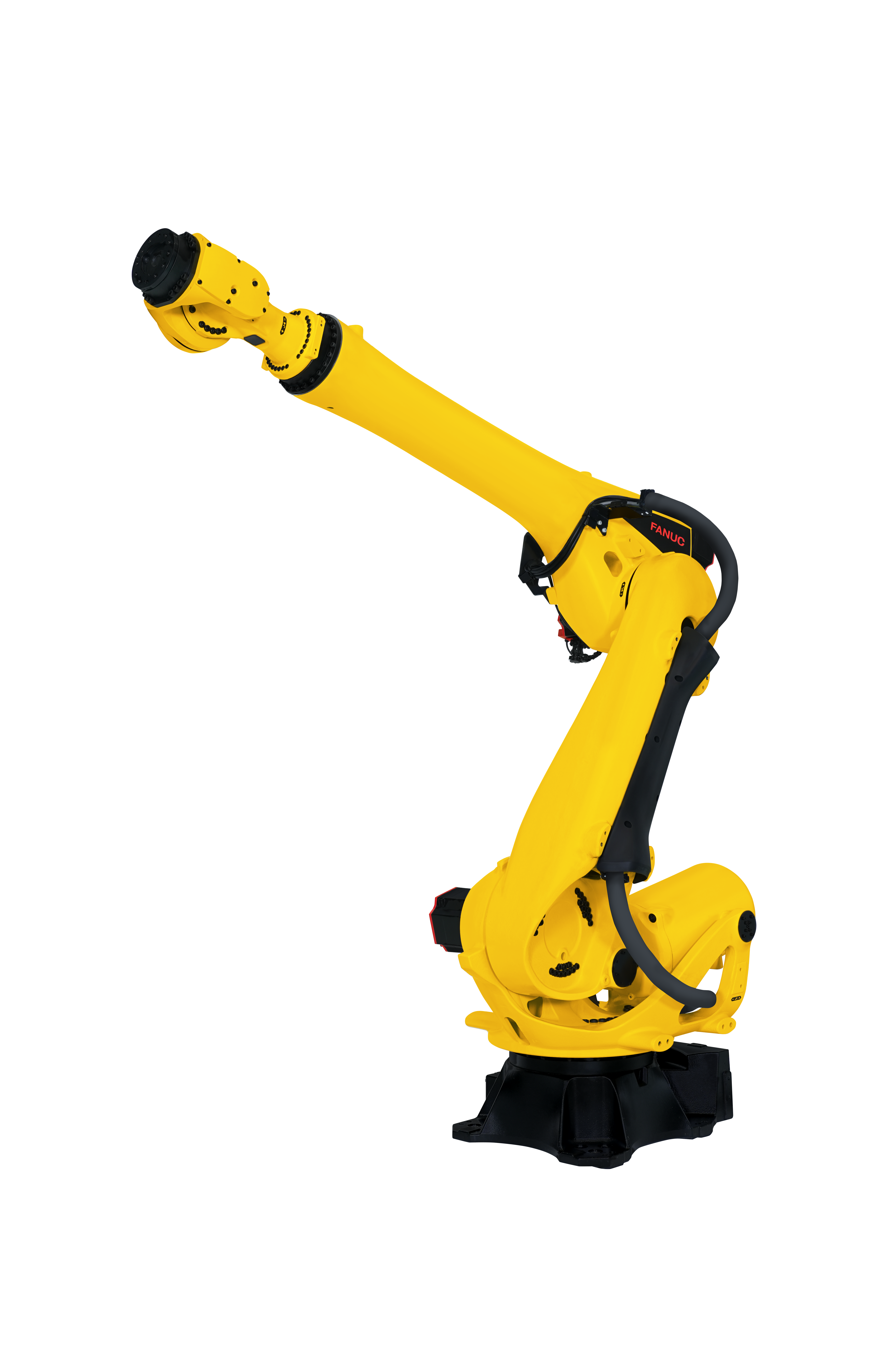

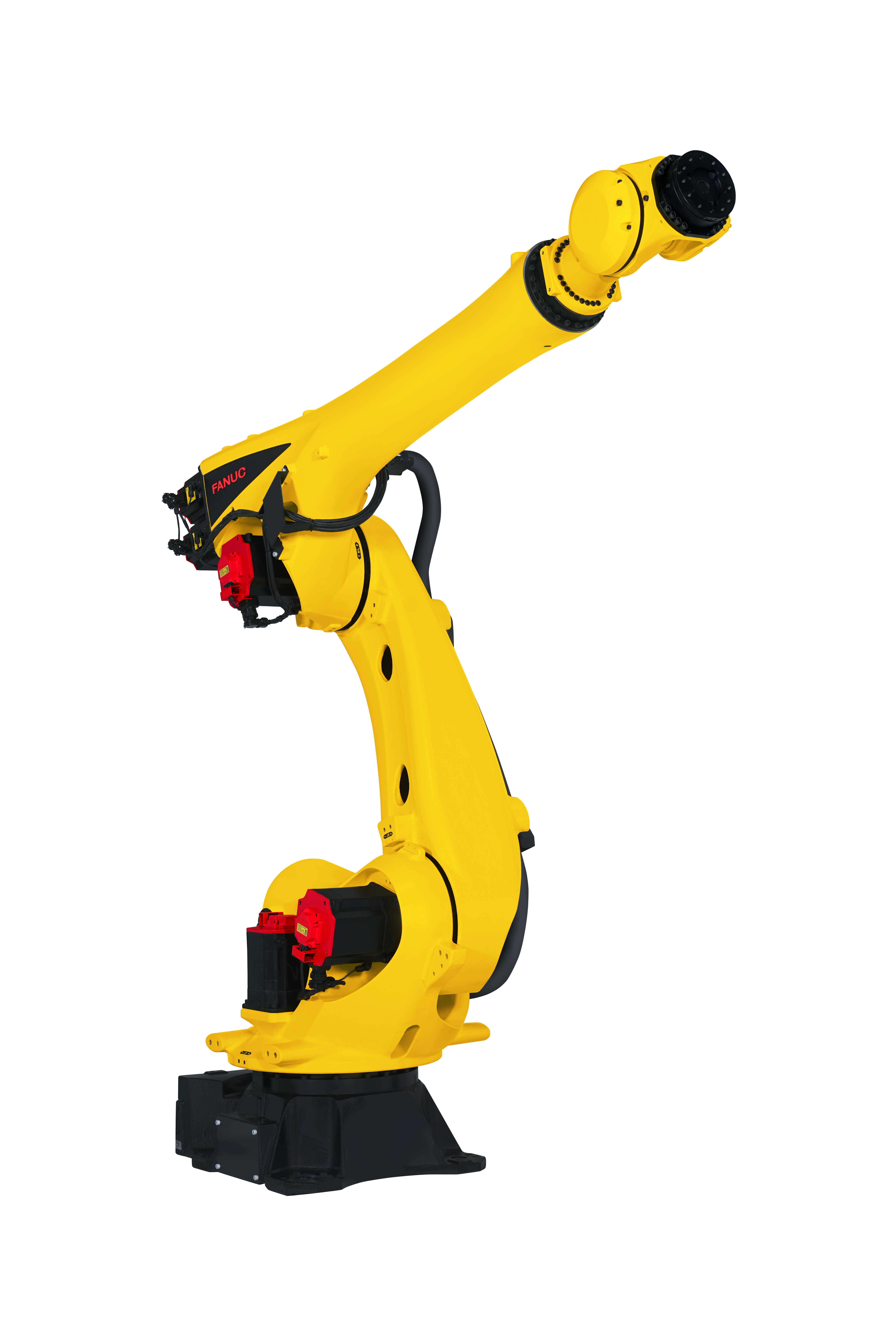

R-2000/E Series
R-2000/125F-31E
125 kg
3100 mm
1125 kg
The FANUC R-2000/125F-31E provides a balanced combination of reach, payload, and footprint for medium-to-heavy industrial automation. With a 125 kg payload and 3100 mm reach, this floor-mounted robot is well suited for spot welding, material handling, and general assembly operations requiring extended coverage. Its 6-axis articulation and ±0.05 mm repeatability ensure dependable performance across high-volume production cycles.
Operating with the FANUC R-50iA controller, this robot takes full advantage of the R-2000/E Series’ faster speeds and smarter functionality. Maintenance-free operation, improved cable routing, and reduced power consumption help minimize downtime while supporting modern digital manufacturing and remote diagnostics.
