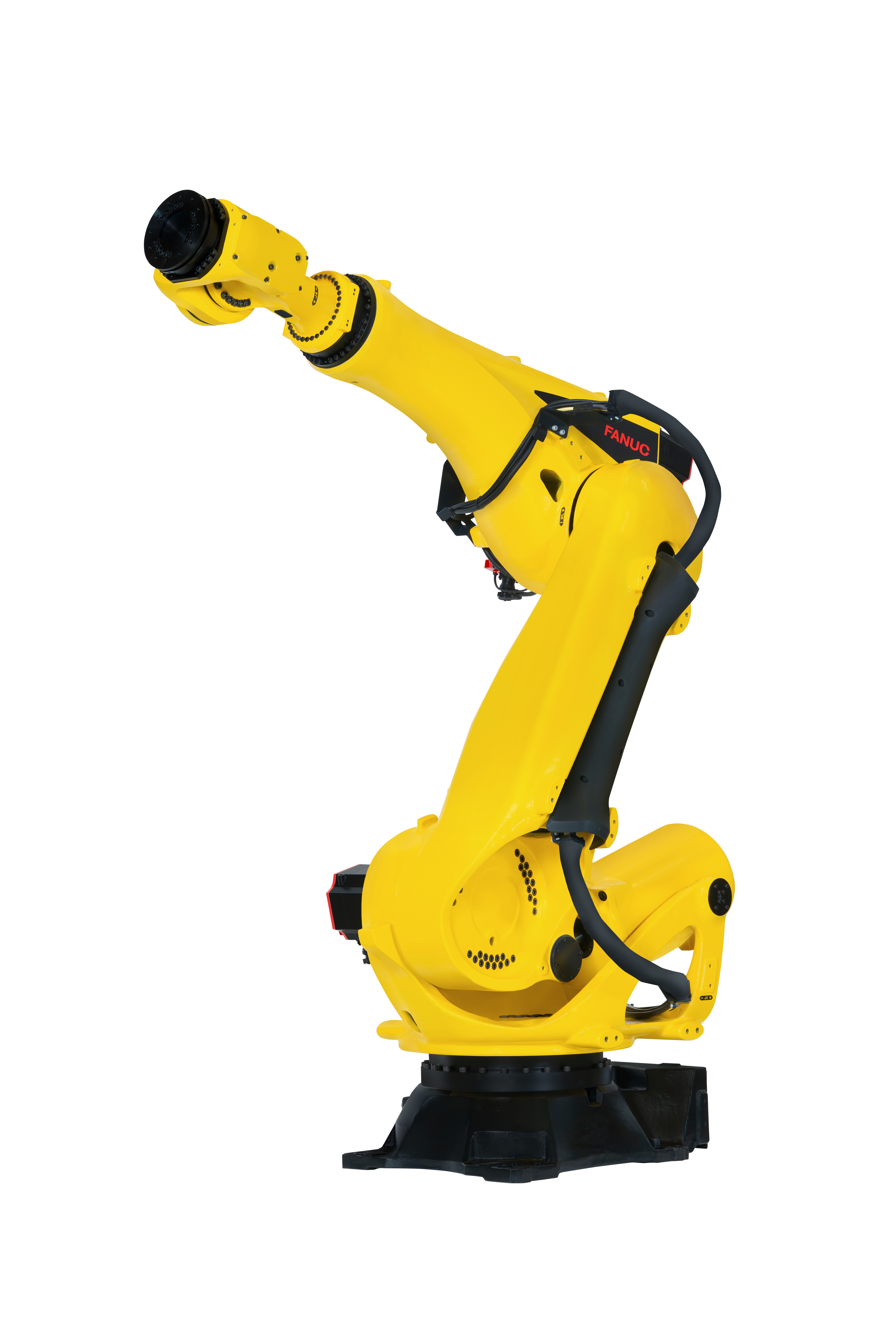

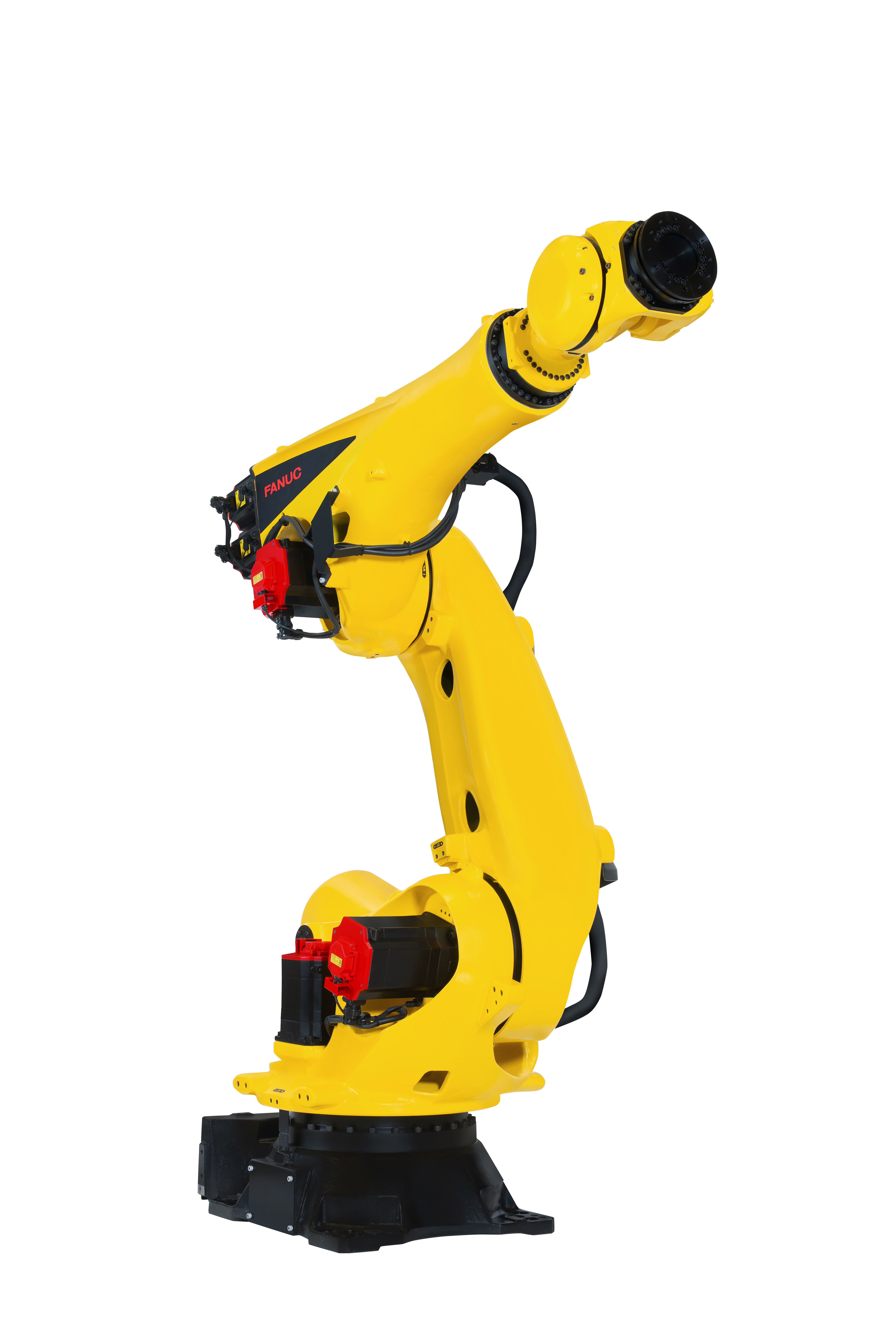

R-2000/E Series
R-2000/180F-27E
180 kg
2655 mm
The FANUC R-2000/180F-27E is a versatile floor-mounted robot tailored for high-speed production environments that require reliable heavy-payload capability in a compact footprint. Offering a 180 kg payload and 2655 mm reach, it is well suited for spot welding, machine tending, and material transfer in automotive and general manufacturing applications. Its 6-axis motion and 0.05 mm repeatability ensure consistent accuracy across repetitive tasks.
As part of the redesigned R-2000/E Series, the robot operates with the FANUC R-50iA controller, supporting faster motion, improved cable management, and modern automation features. Its maintenance-free architecture eliminates grease, battery, and cable changes, reducing downtime and operating costs while supporting quieter, more energy-efficient operation.
R-50iA
180 kg
Floor
±0.05 mm
2655 mm
2.5 kW
370°
136°
357°
130°/s
120°/s
130°/s
180°/s
180°/s
290°/s
1160/170
1160/170
570/140
STANDARD
STANDARD
R-50iA
