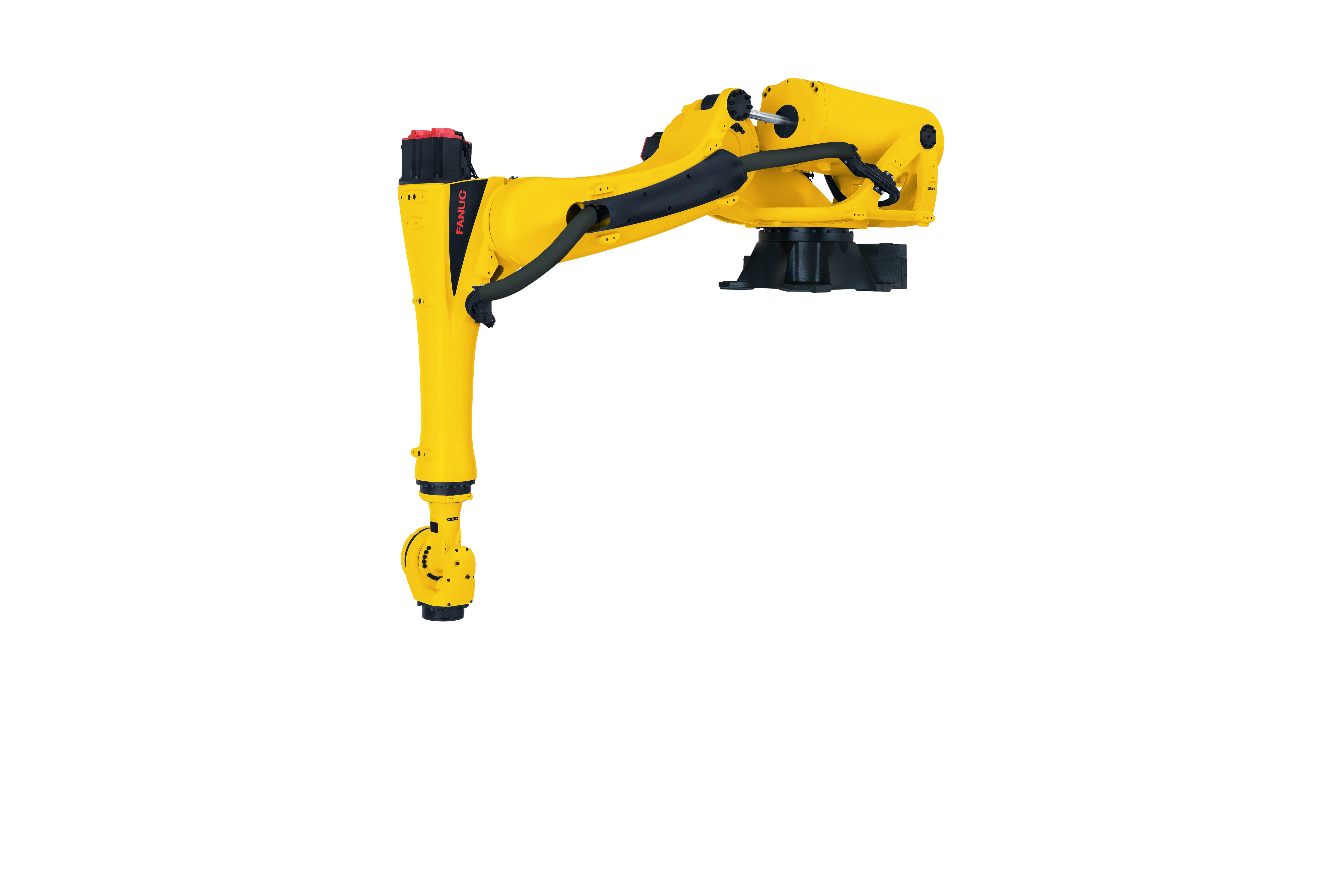

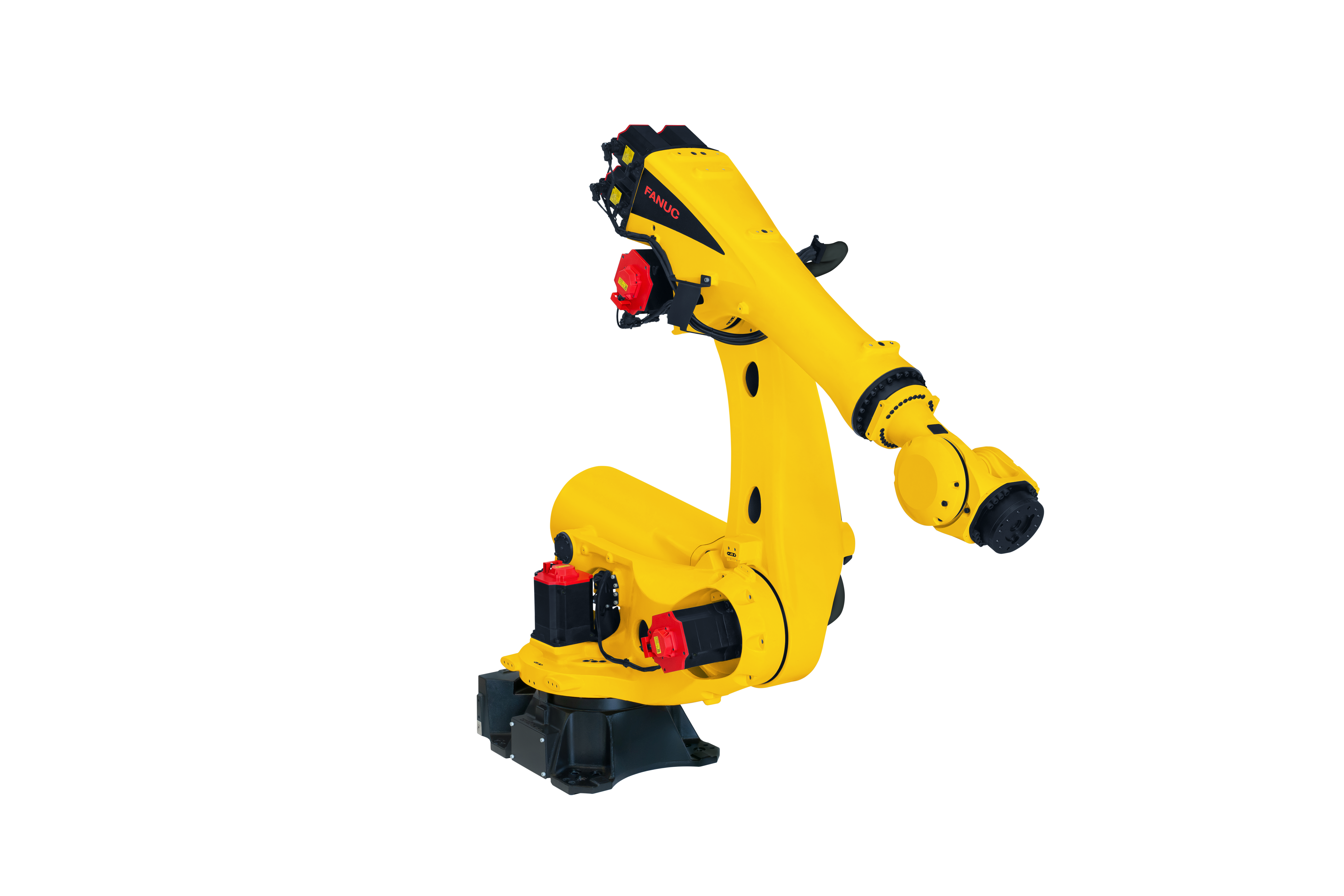

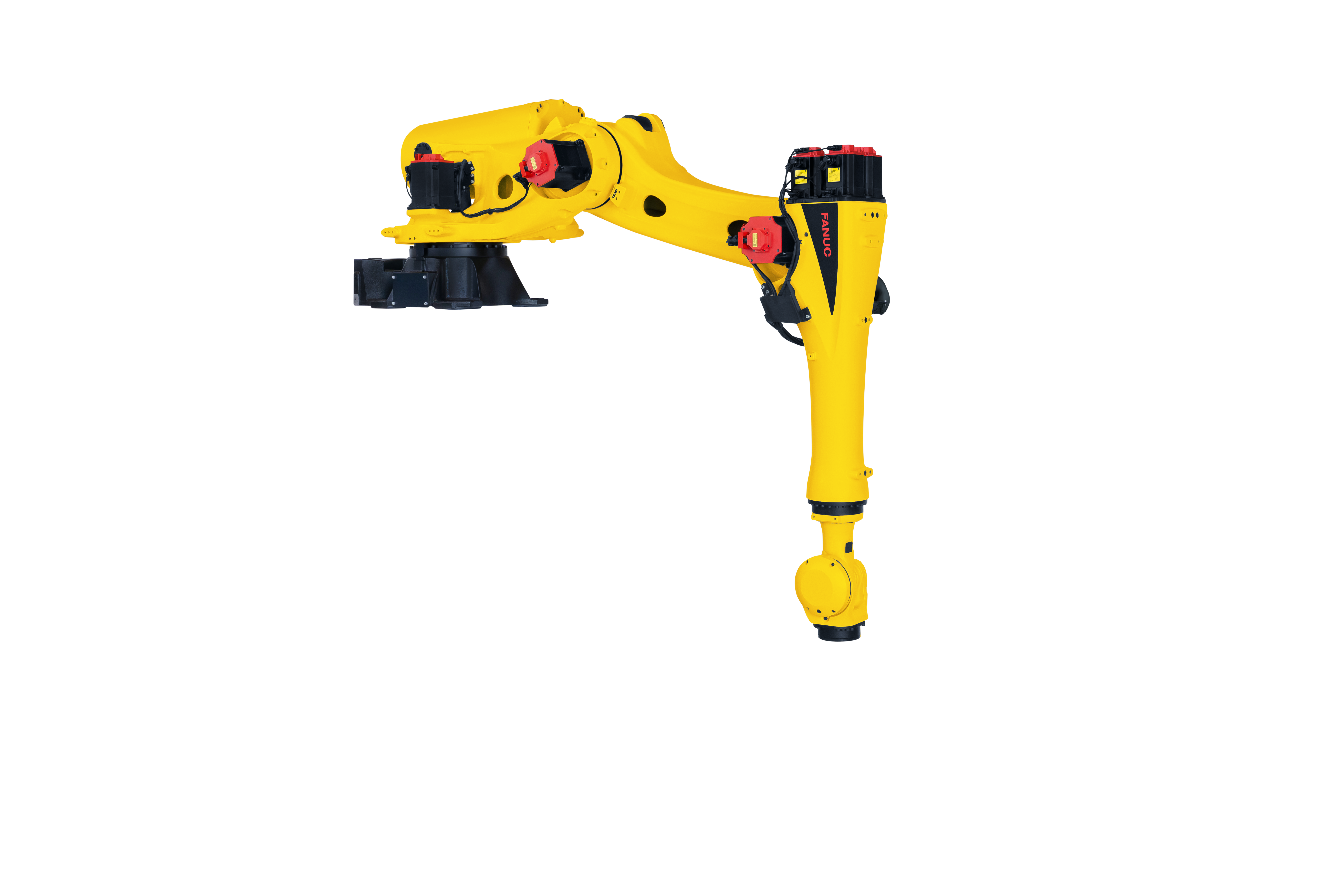

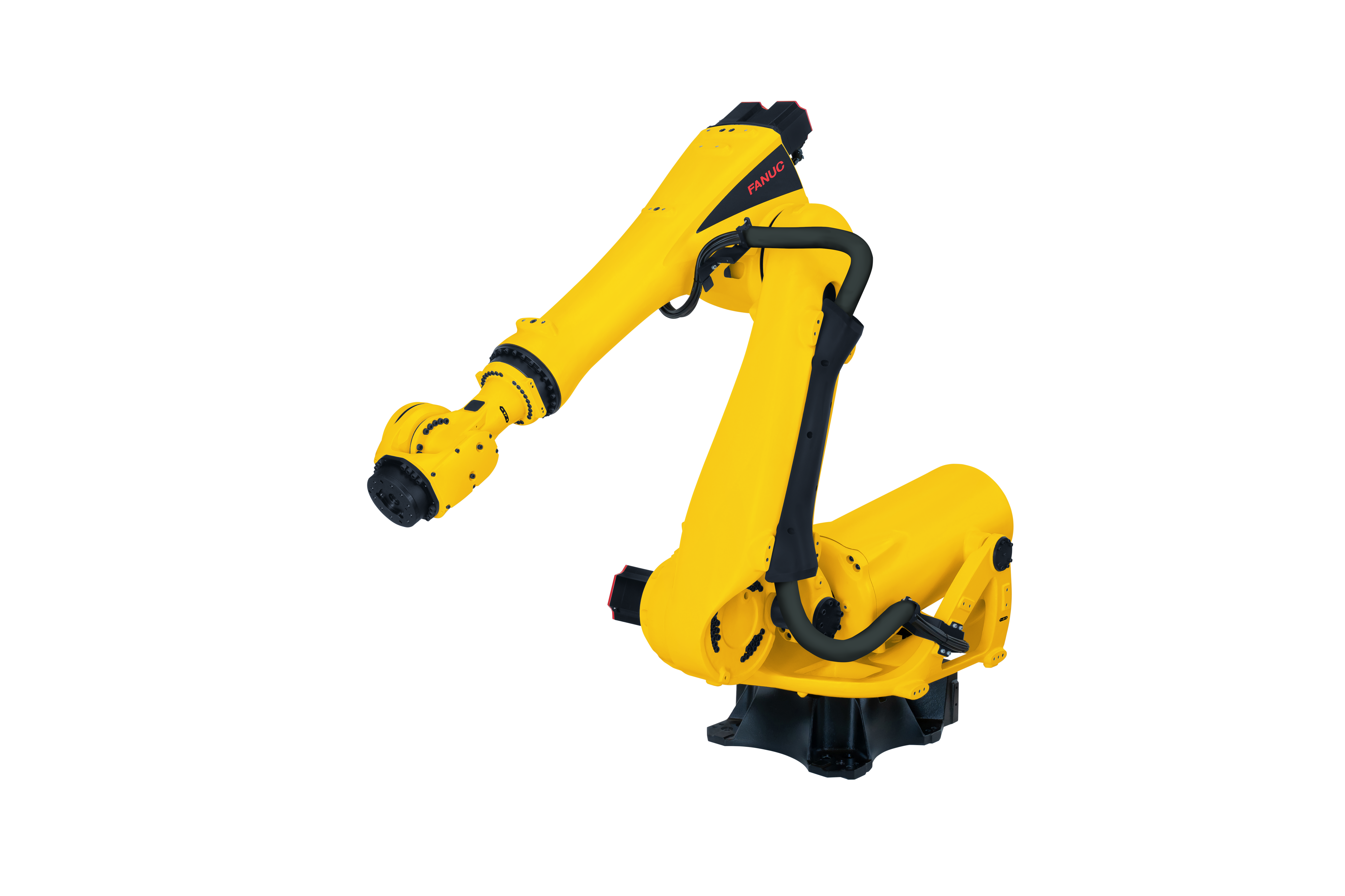

The FANUC R-2000/210R-31E is a rack-mounted heavy-payload robot designed to maximize workspace efficiency while delivering strong lifting capability. Featuring a 210 kg payload and 3095 mm reach, it is ideal for overhead mounting in automotive body shops and large-part handling systems. High repeatability of ±0.05 mm ensures precise and reliable operation, even in complex multi-robot cells.
Integrated with the FANUC R-50iA controller, this R-2000/E model delivers faster cycle times, higher wrist payload support, and advanced motion coordination. Its maintenance-free design, lower energy consumption, and quieter operation help manufacturers improve productivity while reducing long-term operating costs.
