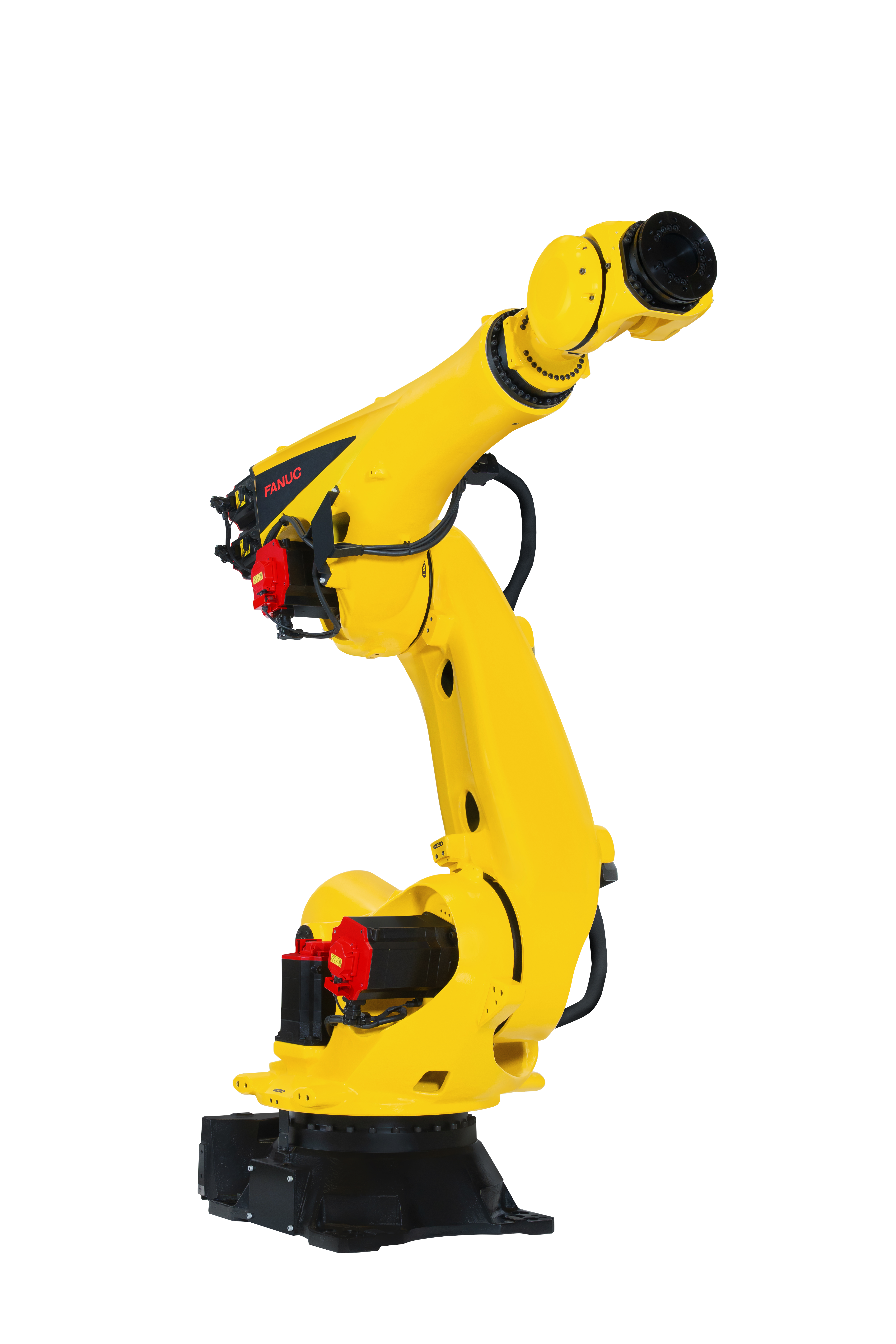

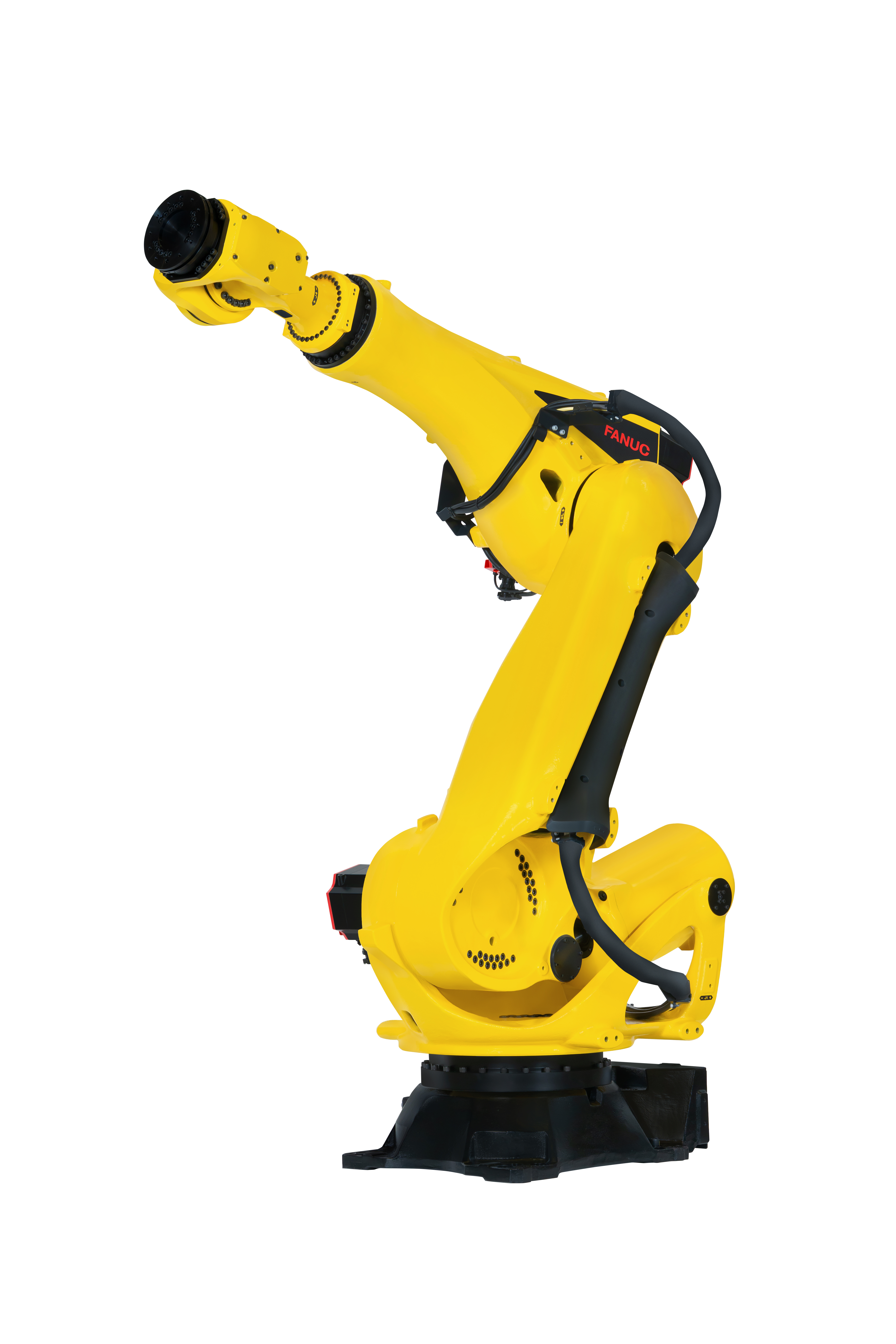

The FANUC R-2000/300F-27E is the highest-payload floor-mounted robot in the R-2000E lineup, delivering an exceptional 300 kg payload within a 2655 mm reach. It is purpose-built for extreme-duty applications such as large tooling manipulation, heavy assembly, and high-force spot welding. Despite its strength, the robot maintains precise motion with ±0.05 mm repeatability across all 6 axes.
Equipped with the FANUC R-50iA controller, this robot offers faster operating speeds, improved wrist load capacity, and seamless integration into advanced automation systems. Its compact baseplate, maintenance-free design, and energy-efficient operation help reduce total cost of ownership while supporting safer, quieter, and more sustainable production environments.

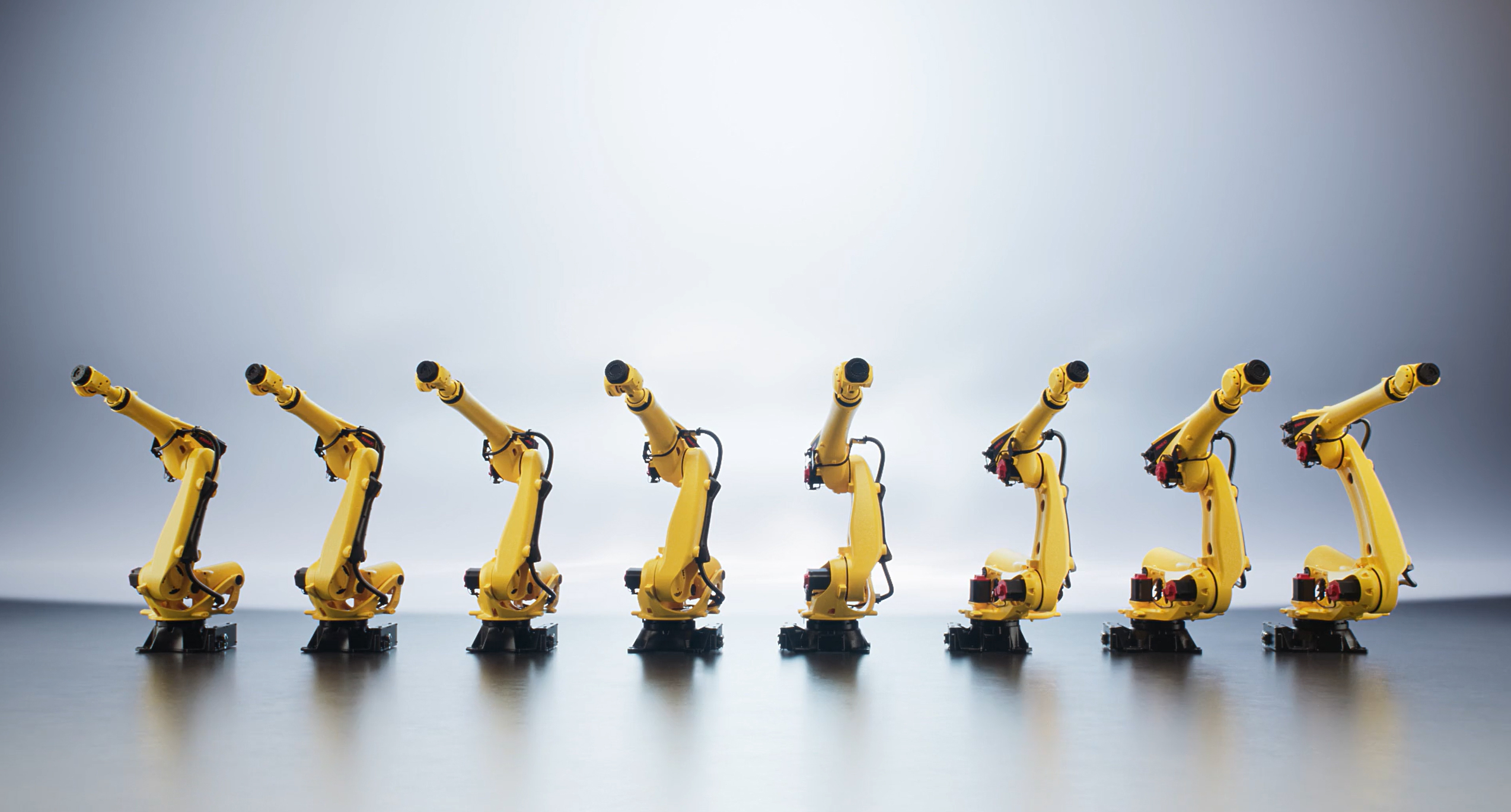

The R-2000/E Series
FANUC R-2000/E Series offers eight heavy-payload robots with 120–300 kg capacity and up to 3905 mm reach for welding, handling, and logistics.
