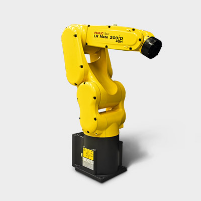

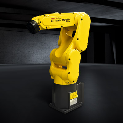

Featuring a 550 mm reach and high-speed wrist, this ultra compact 5 axis short arm version is ideal for confined work spaces and compact machines. Extremely easy to integrate, this model is also available with a range of options including integrated intelligent (vision & force) functionality and special application packages.
Lr mate 200id 4sh facing right
Lightweight, fast and accurate
For payloads of up to 4 kg, this short arm LR Mate 200iD/4SH provides ultimate 5-axis performance - This robot is a cost-effective 5-axis solution that delivers absolute flexibility and fast handling of small payloads.

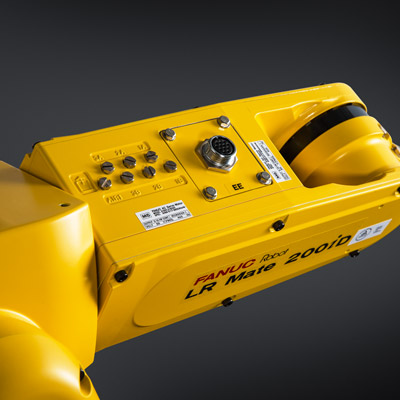

User-friendly with Integrated End Effector Services
Enclosed cabling and smooth surfaces make for easy cleaning, minimal maintenance and zero downtime. A cleaner look, better cable protection and durability, easier cleaning and maintenance, better system reliability and improved performance.
