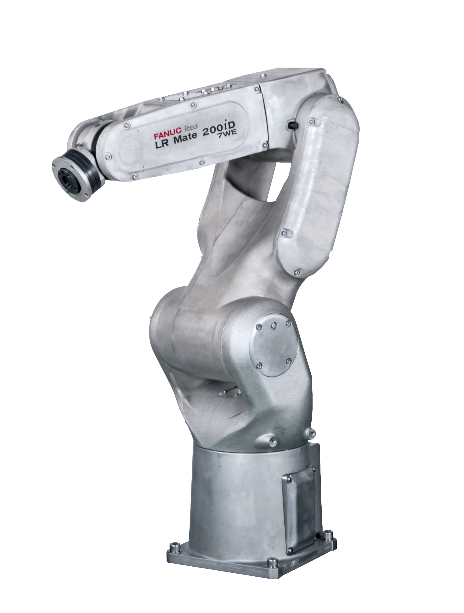

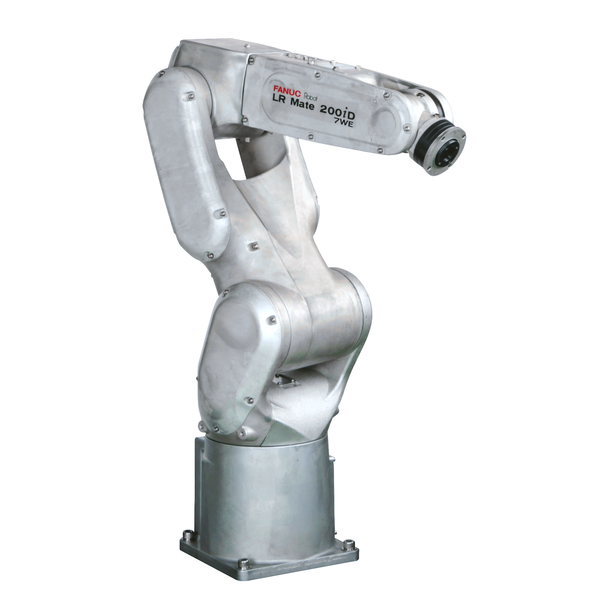

Built to get wet, this compact 6 axis model is ideal for wet environments and can be easily integrated into confined spaces and machines. Like other LR Mate robots, it is available with a range of options including integrated intelligent (vision & force) functionality.
LR Mate 200i D 7 WP Load and Unload
Easy to Integrate, Even Into A Machine, Thanks to Sealed Mechanical Units
FANUC LR Mate 200iD/7WE offers you full flexibility with floor, ceiling, wall and angle mounting – thanks to its compact design and sealed mechanical units you can even integrate it directly into a machine for robotic machine tending.

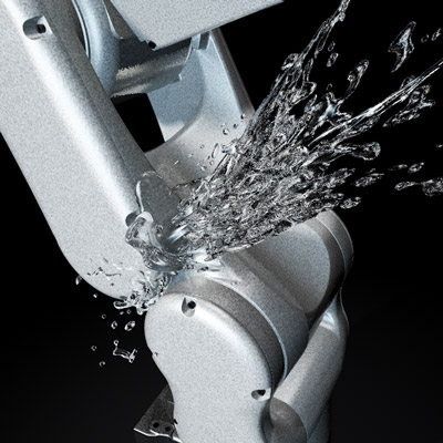

Lr mate 200id 7wp ip67 protection
IP67 Protection
At home working in environments involving dust, water jet and die cast thanks to a waterproof wrist and IP67 protection on the J4 arm. Get more protection with optional IP69K.
LR Mate 200iD/7WE
Get It Wet!
This washproof LR Mate version is ideal for use in wet environments and for high pressure washing applications.
