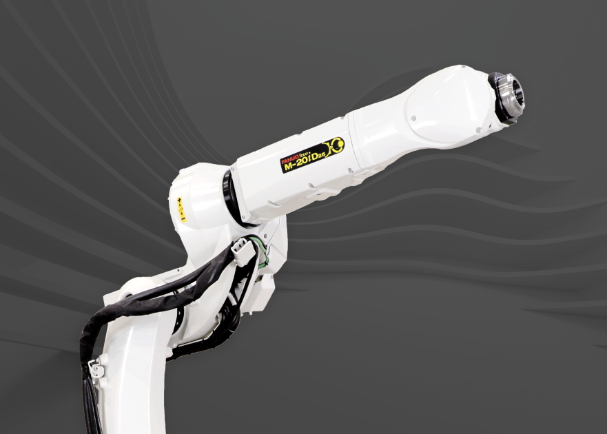

Offering high performance in a small footprint, the FANUC M-20iD/25 is ideally suited to loading and unloading machines as well as parts handling and positioning in crowded factory environments. For best access, it features a compact arm and wrist and, thanks to its new improved design and drive train, offers significantly higher axis speeds and motion performance. With an increased active stroke of 1831 mm, it offers a generous working envelope, with better rigidity translating to improved repeatability of ± 0.02 mm. To prevent snagging and improve reliability, cable routing is internal. By combining performance with reliability, the FANUC M-20iD/25 maximizes throughput leading to higher profitability. Installation is easy and running costs are low.

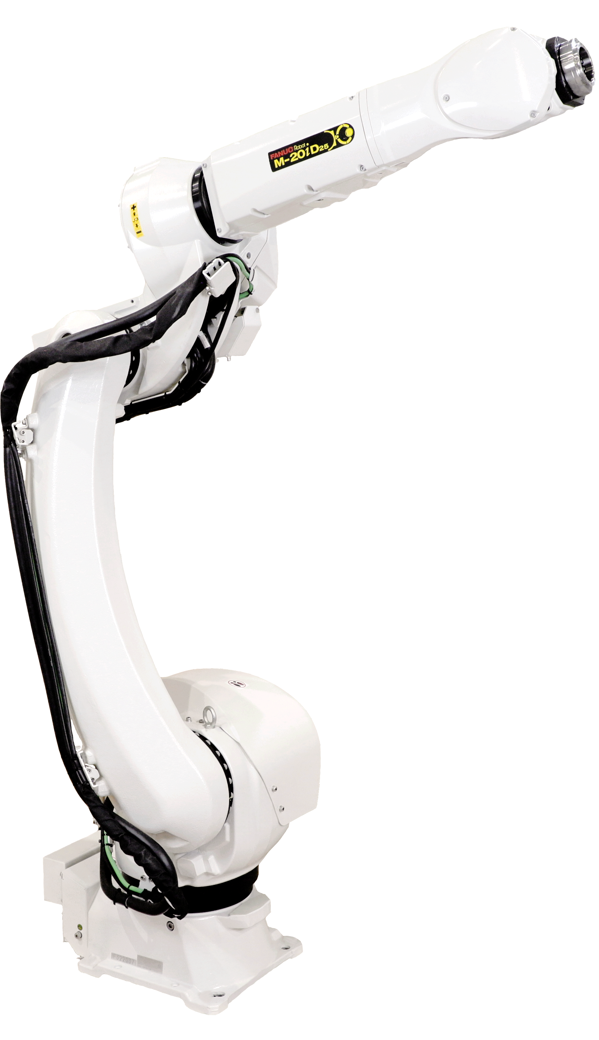

The FANUC M-20iD/25 food grade robot is designed for users in the food industry that need high-speed and high-payload robots.

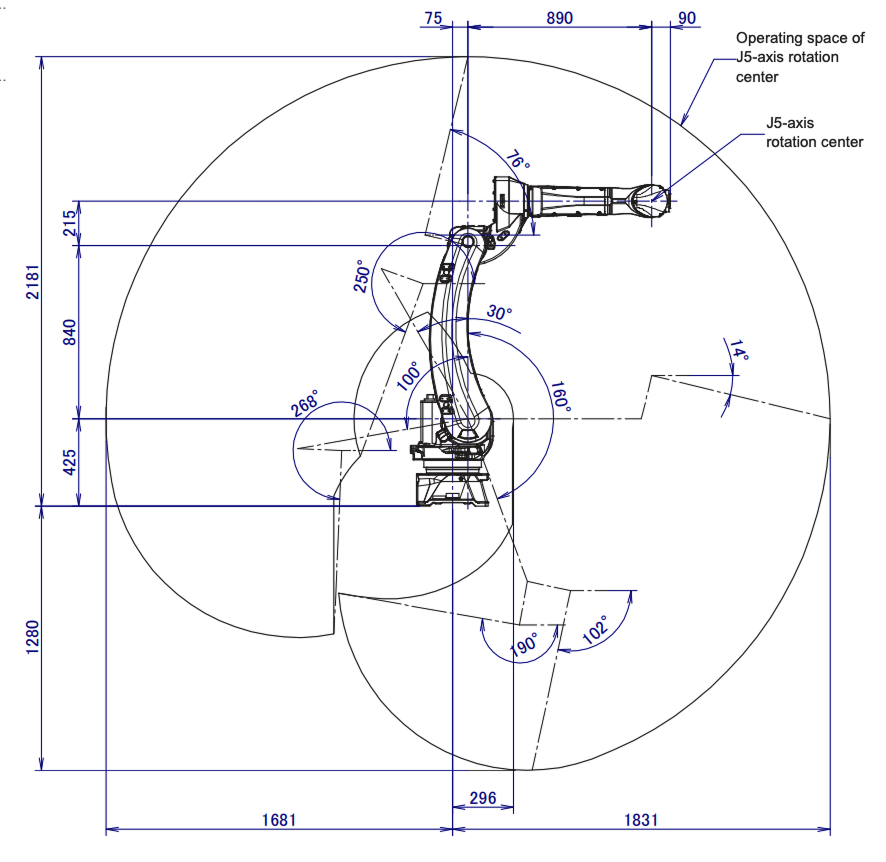

25 kg
±0.02 mm
1831 mm
250 kg
1 kW
340°
260°
458°
400°
360°
210°/s
210°/s
265°/s
420°/s
420°/s
720°/s
52/2.4
52/2.4
32/1.2
IP54 / IP65
