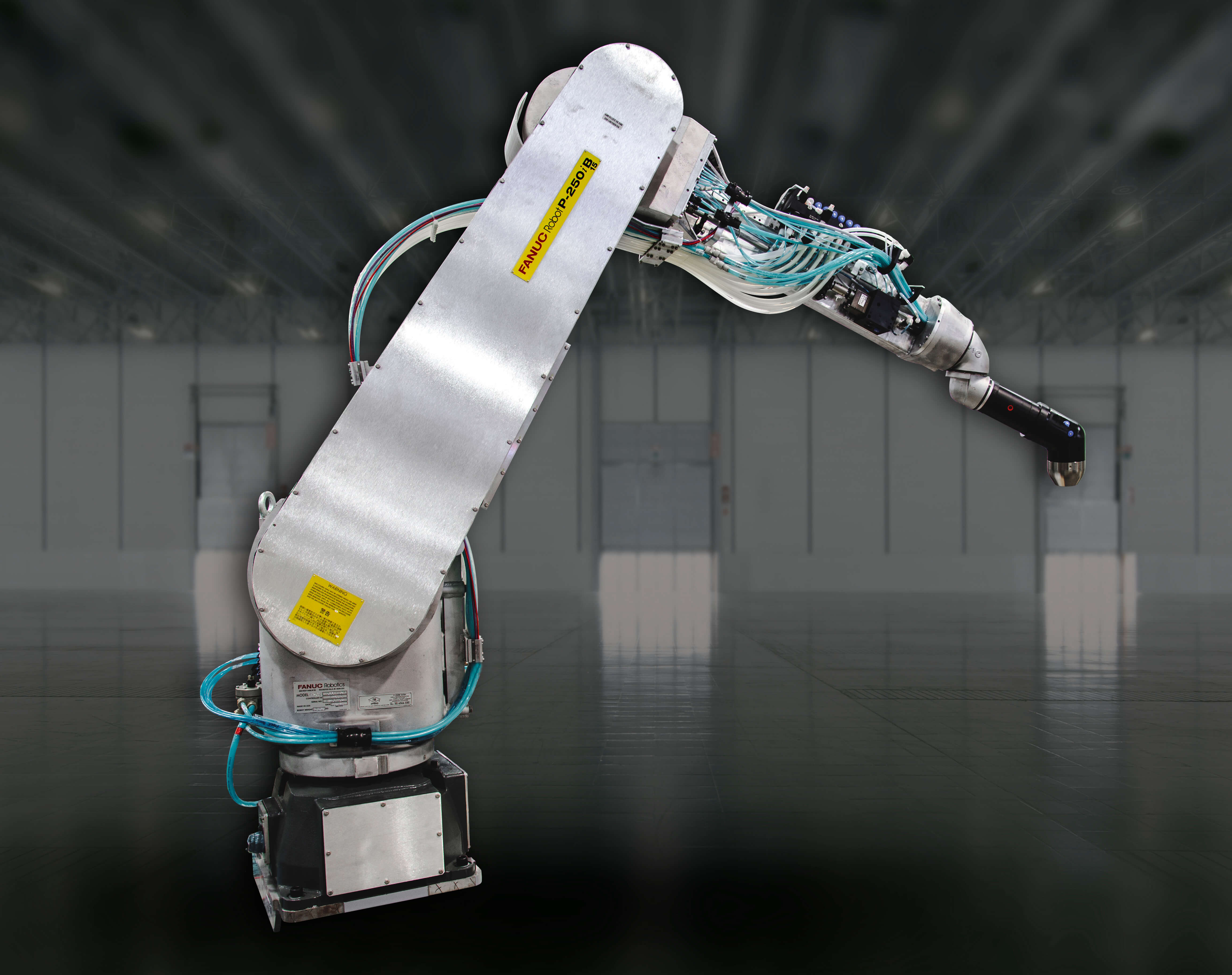

This paint robot is the industry's best solution for large and mid-size painting jobs. Suitable for a wide range of painting and coating applications, it has a large handling capacity and generous work envelope.
P 250ib 15 with cables
Designed for Efficient Process Equipment integration
This model boasts a wide range of features and easy to integrate equipment designed to add flexibility and cover a wide spectrum of painting and coating applications.

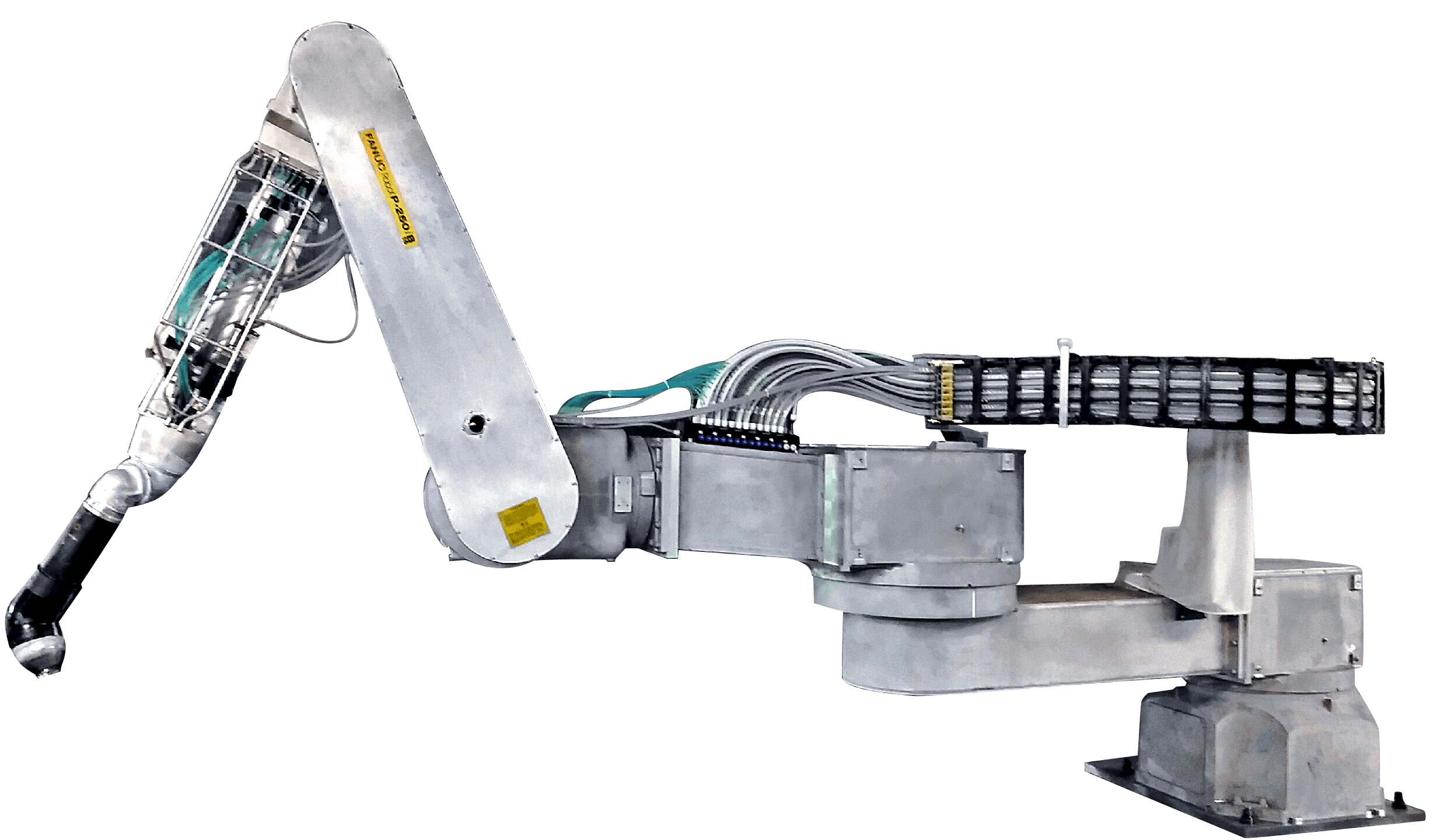

P 250ib rail mount beauty shot
Flexible Mounting for Maximum Use
Floor, wall and inverted mounting allows easy access to even the hard-to-reach spaces. The robot can also be mounted for elevated, in-booth and clean wall floor style rails.

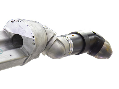

Paint robot hollow wrist
Patented Hollow Wrist
Production proven hollow wrist and though-arm hose routing support a clean application environment and help to achieve top product quality.

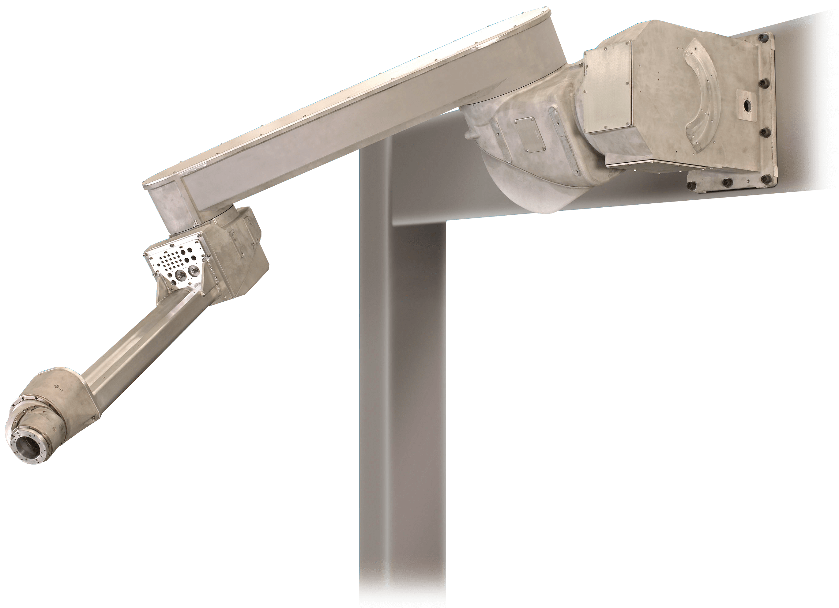

P 250ib swing arm
Process Flexibility with Wide Reach
Do you need even more reach? This model is offered in a swing arm variant extending it’s work envelope to 3,575 mm. This makes it an excellent replacement for manual spraying or older automation.

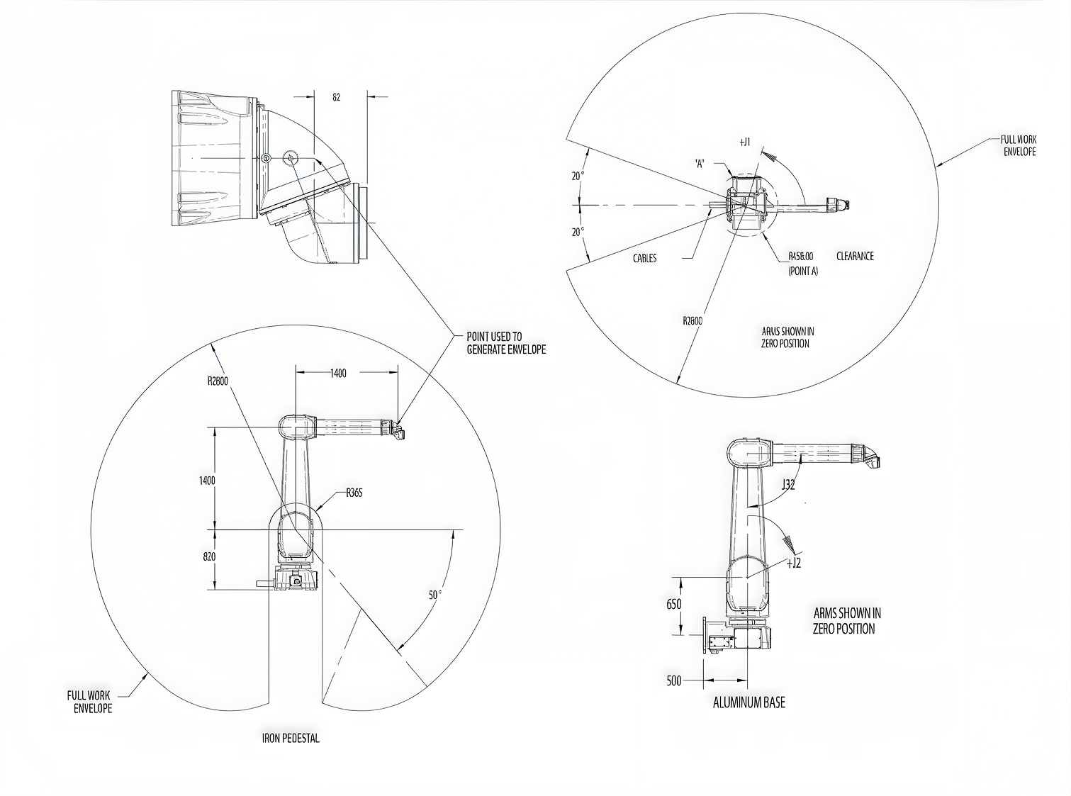

R-30iB Plus Mate Cabinet
15 kg
±0.07 mm
2800 mm
530 kg
320°
280°
330°
1080°
1080°
1080°
160°/s
160°/s
160°/s
375°/s
430°/s
545°/s
65/3
55/2.1
11.5/.35
