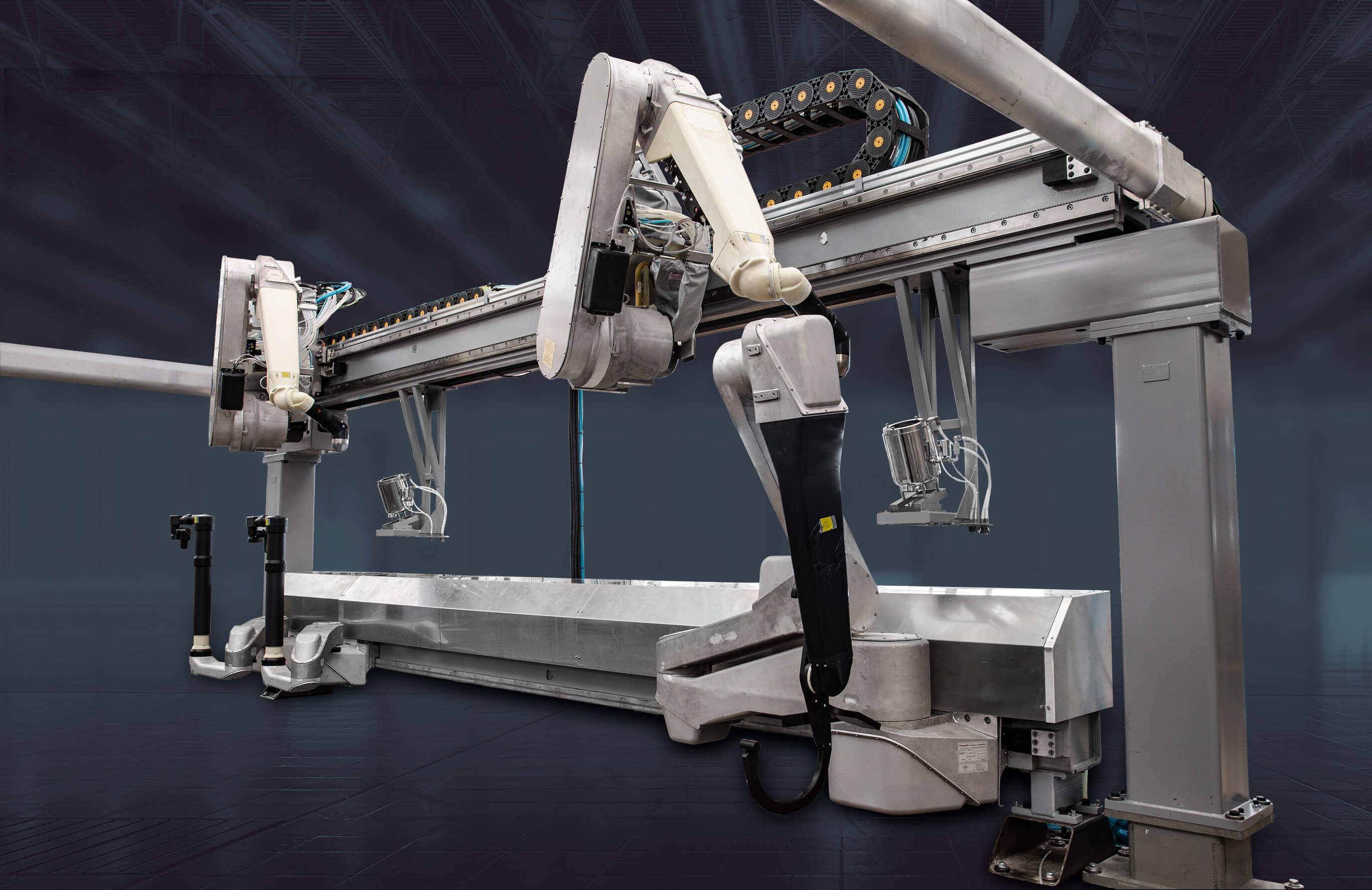

P-25iB
3397 mm
470 kg
While other’s rely on using a paint robot to open hoods & decks, FANUC has a DEDICATED robot to do the job. The P-25iB is built to lift your heavy swing metal but can keep up with your product as it moves down the line. When coupled with any of our other paint robots, this unit can make sure your interior looks as good as your exterior.
P 700ib paint system
Up Down and All Around
Do you have a stop station or a moving line? Either is fine. Thanks to the dynamic design of the P-25iB, this robot can be mounted on a pedestal or a rail. It can move along with your vehicle as it is getting painted or stay in place to make sure we don’t drop the hood.

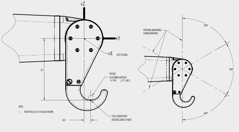

Robust Tooling
While vehicles can vary from customer to customer, the P-25iB was designed to serve everyone with one universal tool. The robust hook design utilized at the end of arm allows enough flexibility to lift any hood or deck while providing the strength required to hold it while your product gets the finishing touch.

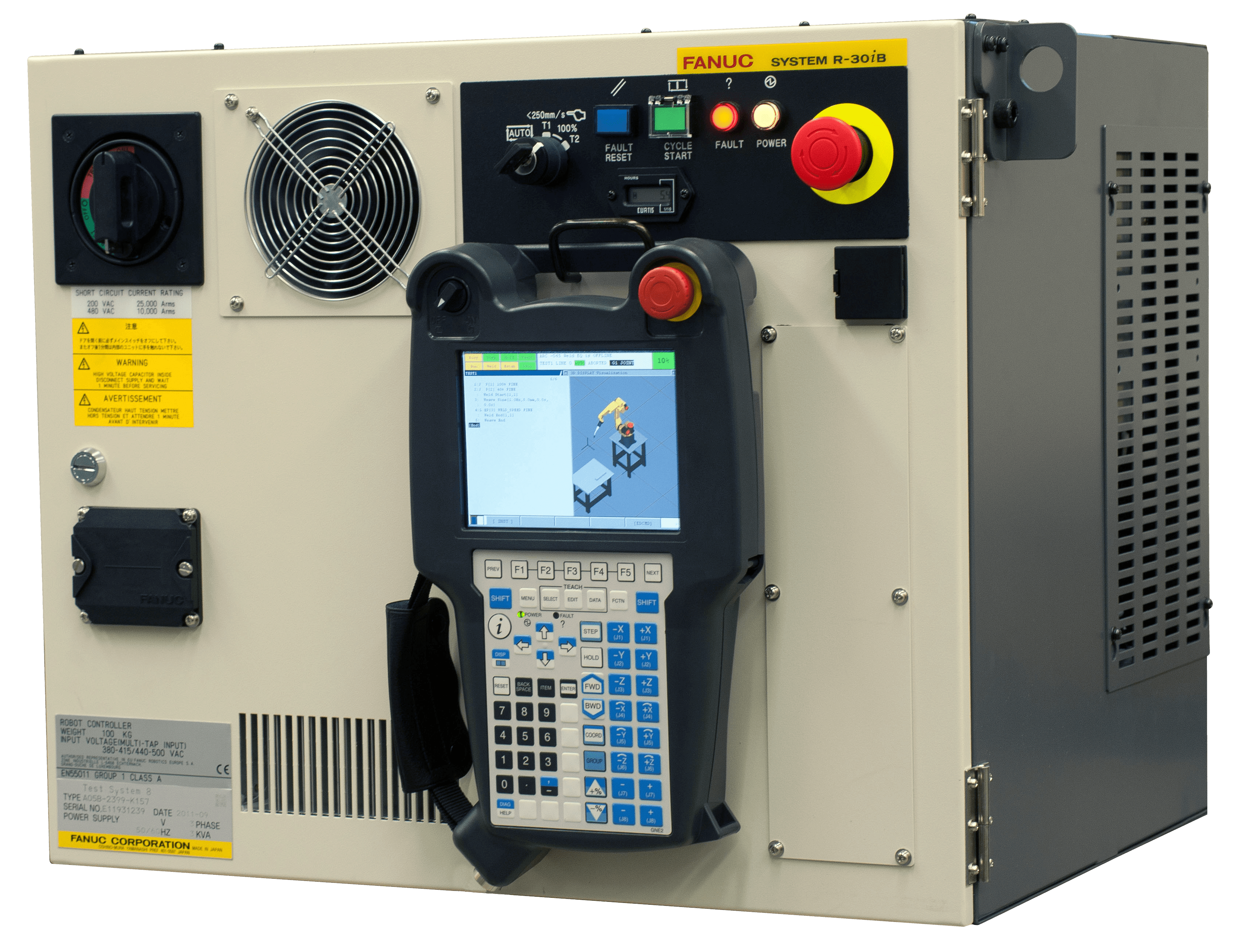

No Extra Controllers
Due to the efficient FANUC controller design, the P-25iB does not need a stand alone controller because this robot can run off a shared controller with the paint robot. This means less of a crowd in your clean room allowing you more space for different equipment or a smaller plant overall.
