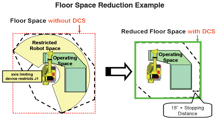

By enabling advanced safety functions such as safe work zones, speed-limited areas, and dynamic safety behavior, DCS Position and Speed Check allows precise control of robot motion without the need for external safety sensors or additional hardware. Safety parameters can be configured to match specific application requirements, supporting flexible cell layouts and intelligent safety strategies.

By using internal position feedback and built-in safety monitoring, Basic Position Check provides a simple and effective safety solution for applications requiring fixed safety boundaries. The configuration process is straightforward, making it well suited for standard robotic cells with consistent operating zones. Designed to meet international functional safety standards, DCS Basic Position Check offers certified, reliable protection while simplifying system design and reducing overall installation complexity.
