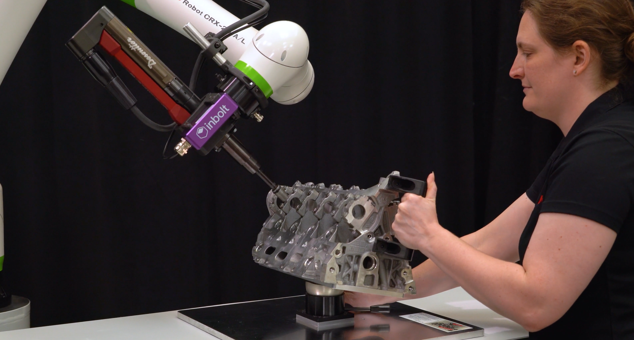

Stream Motion provides a way for external systems to generate trajectory data in real time and stream those commands directly to the robot controller for execution. This enables motion control for paths generated dynamically by external CPUs and software, rather than predefined in TP programs. It is particularly useful for applications where traditional automation—with fixed, repeatable paths—is not suitable, such as real-time 3D vision-guided processes, adaptive machining, and advanced or research environments requiring flexible, externally driven motion.

Modern automation increasingly relies on data from external systems such as cameras, sensors, scanners, and custom software applications. Stream Motion allows these systems to influence robot movement dynamically during operation.
By connecting advanced processing and decision-making systems with robot execution, manufacturers can develop automation solutions that respond to real-world conditions as they occur.
