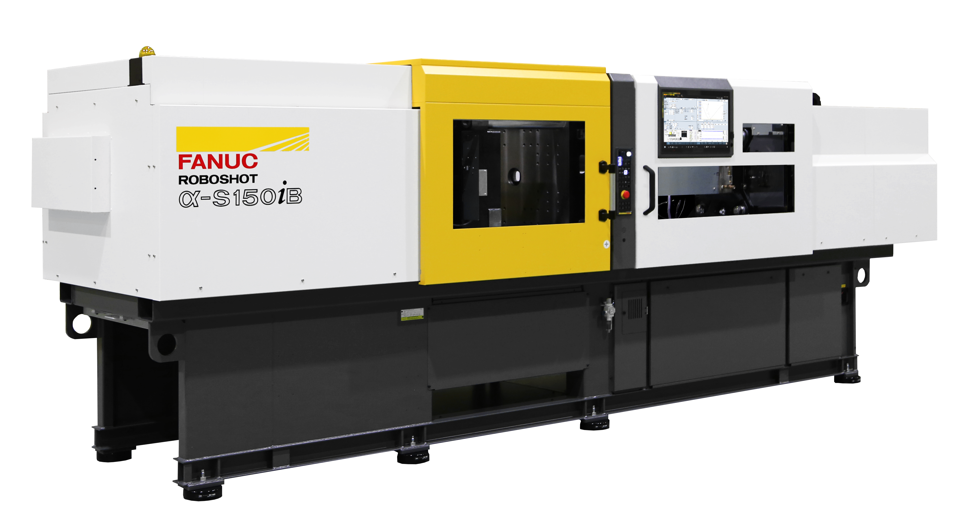

ROBOSHOT α-S150iB de capacidad pequeña
Tonnage
1500 kN | 150 tonf
Screw Diameter
22, 26, 28, 32, 36, 40, 44 mm
Tie Bar Spacing (H × V)
560 x 510 mm
Detalles técnicos
Clamping Mechanism
Mecanismo de doble palanca de 5 puntos
Tonnage
1500 | 150 tonf
Tonnage (Increased)
1800 | 180 tonf
Max/Min Die Height (Double Platen)
500-200 mm
Max/Min Die Height (Double Platen, Increased)
600-200 mm
Max/Min Die Height (Single Platen)
575-275 mm
Max/Min Die Height (Single Platen, Increased)
675-275 mm
Clamping Stroke
440 mm
Locating Ring Diameter
160 mm
560 x 510 mm
Platen Size (H × V)
800 x 750 mm
Minimum Mould Size (H × V)
325 x 300 mm
Maximum Mould Weight (Double Platen)
800-800 kg
Maximum Mould Weight (Single Platen)
1060-800 kg
Ejector Stroke
150 mm
Maximum Ejector Force
35|3,5 tonf
Maximum Ejector Force (Increased)
80|8,0 tonf
Screw Diameter
Injection Stroke
75, 95, 95, 128, 144, 144, 160 mm
Max. Injection Volume
29, 50, 58, 103, 147, 181, 243 cm³
Nozzle Touch Force
15|1,5 tonf
Nozzle Touch Force (Increased)
30|3,0 tonf
