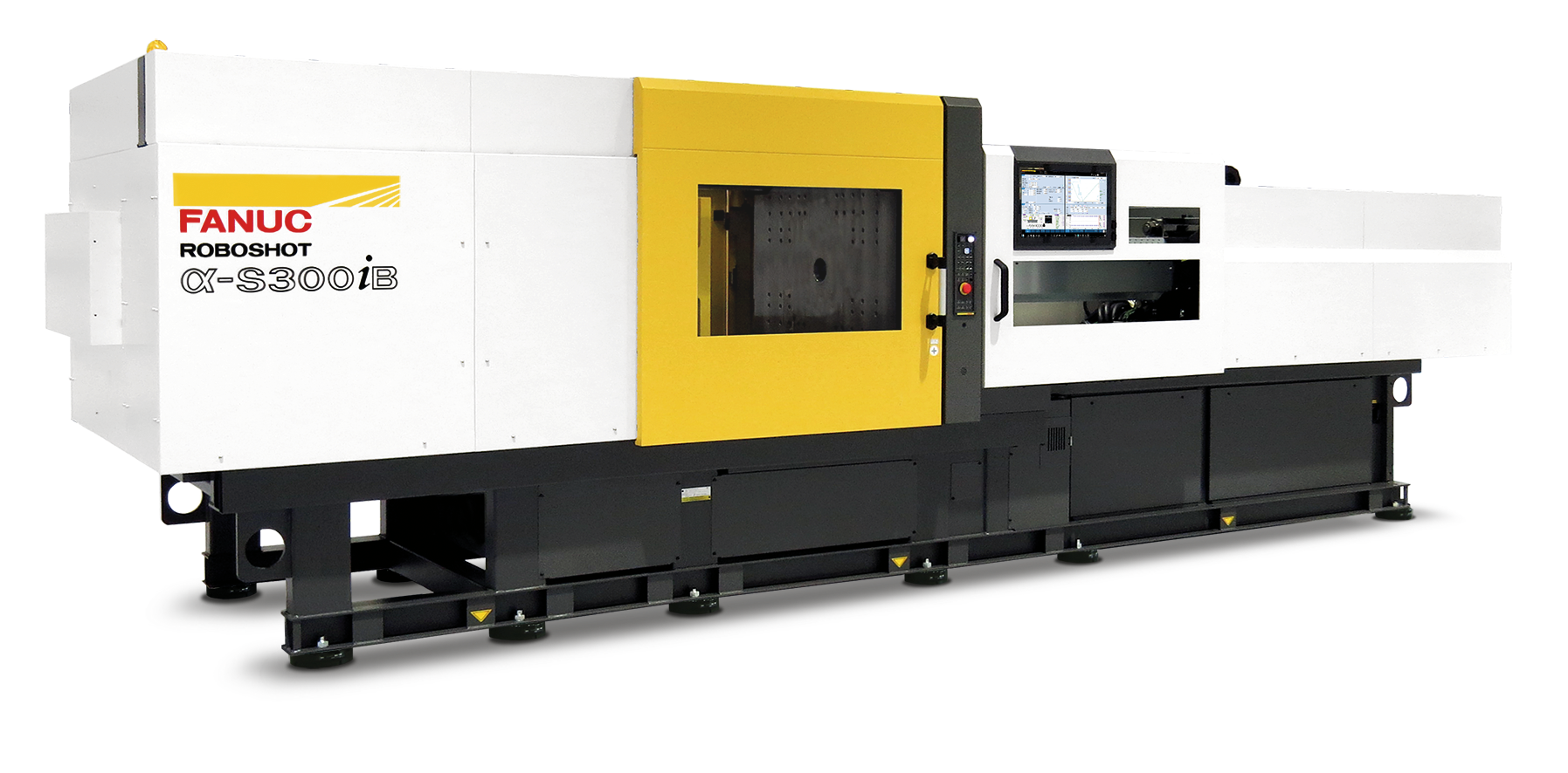

ROBOSHOT α-S300iB de gran capacidad
Tonnage
3000 kN | 300 tonf
Screw Diameter
64, 68, 72, 80 mm
Tie Bar Spacing (H × V)
810 x 710 mm
Detalles técnicos
- Clamping Mechanism
- Doble palanca
- Tonnage
- 3000 | 300 tonf
- Tonnage (Increased)
- 3500 | 350 tonf
- Max/Min Die Height (Single Platen)
- 650-300 mm
- Max/Min Die Height (Single Platen, Increased)
- 750-300 mm
- Clamping Stroke
- 600 mm
- Locating Ring Diameter
- 160 mm
- Tie Bar Spacing (H × V)
- 810 x 710 mm
- Platen Size (H × V)
- 1130 x 1030 mm
- Minimum Mould Size (H × V)
- 470 x 420 mm
- Maximum Mould Weight (Single Platen)
- 2400-2400 kg
- Ejector Stroke
- 200 mm
- Maximum Ejector Force
- 80 | 8,0 tonf
- Screw Diameter
- 64, 68, 72, 80 mm
- Injection Stroke
- 280, 300, 320, 320 mm
- Max. Injection Volume
- 901, 1090, 1303, 1608 cm³
- Nozzle Touch Force
- 30|3,0 tonf
- Nozzle Touch Force (Increased)
- 50|5,0 tonf
