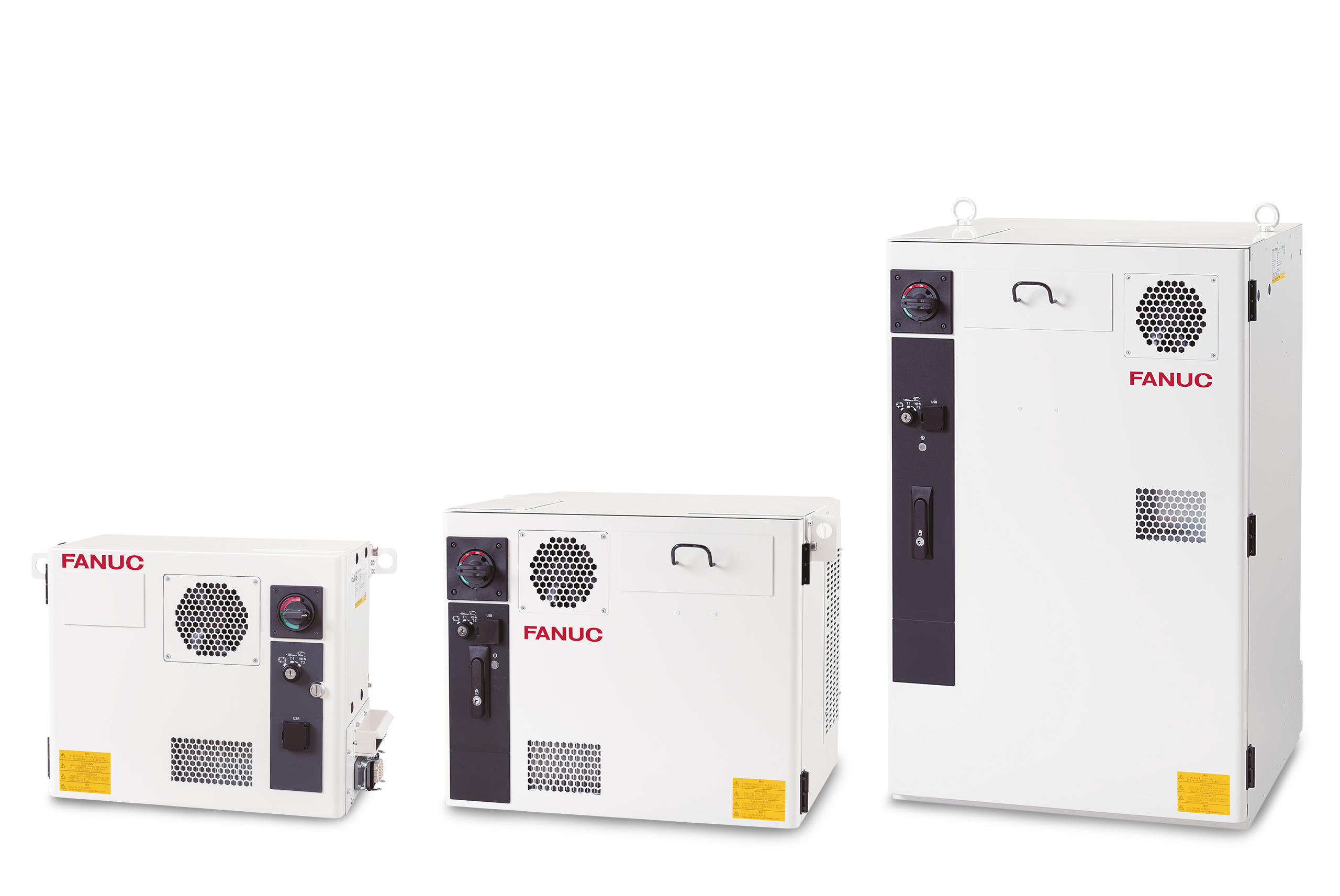

FANUC R 50i A Controller A Cabinet
Run Python on the Controller
The globally popular programming language Python can now be executed directly on the robot controller R-50iA. This robot control enables seamless integration of rich open-source libraries—such as those for statistical processing, data analysis, and image processing—into robot control. The development environment supports VS Code (Visual Studio Code), allowing efficient program development with advanced remote debugging features such as step execution, breakpoints, and variable views.

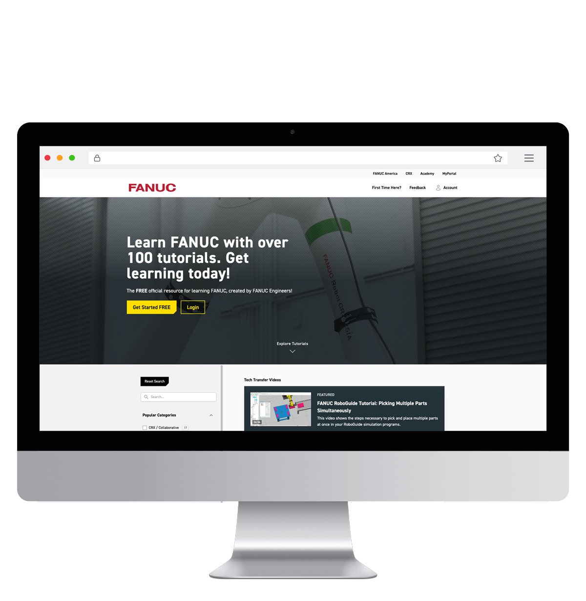

Tech transfer
Learn how to take advantage of Python programming on the FANUC R-50A Controller through this Technical Transfer video. Python script execution is a standard feature of the controller, enabling rapid development for file operations, communication processing, numerical calculations, and integration with external systems. The video demonstrates how Python can be used to enhance automation workflows while working directly on the robot controller.
*Free registration required
