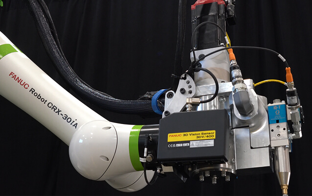

In today’s demanding industrial landscape, manufacturers are seeking smarter solutions that boost quality, enhance worker ergonomics and increase profitability. FANUC’s new Mobile Dispense Cart rises to that challenge—delivering precision, flexibility, and simplicity in an automated dispensing system built for modern production needs.
The solution pairs FANUC’s Integral Servo Dispenser software with Graco’s state-of-the-art continuous flow dispensing equipment to create a mobile platform designed for agility and performance. And depending on customer needs, it can be powered by either a FANUC industrial robot or purchased as a standardized cobot system.

Game-Changing Features and Benefits
Fanuc mobile dispense cart
  • Consistent Control: The servo-driven system adjusts flow rate for adhesives and sealants dynamically as the robot changes speed, ensuring the right bead size every time—without the need for complex programming.
  • More Uptime, Less Waste: A direct connection between the Graco metering pump and the dispense valve minimizes the effects of viscosity variation and virtually eliminates the need for purging, reducing waste and boosting productivity.
  • Maintenance Made Easy: The dispense system is designed for rapid maintenance without needing to flush adhesive lines, cutting downtime and disposal costs.
  • Vision-Guided Accuracy: With FANUC iRVision 3DV, the cobot identifies part locations, adjusts for speed through curves, and can even verify bead presence—bringing a new level of intelligence to dispensing operations.
