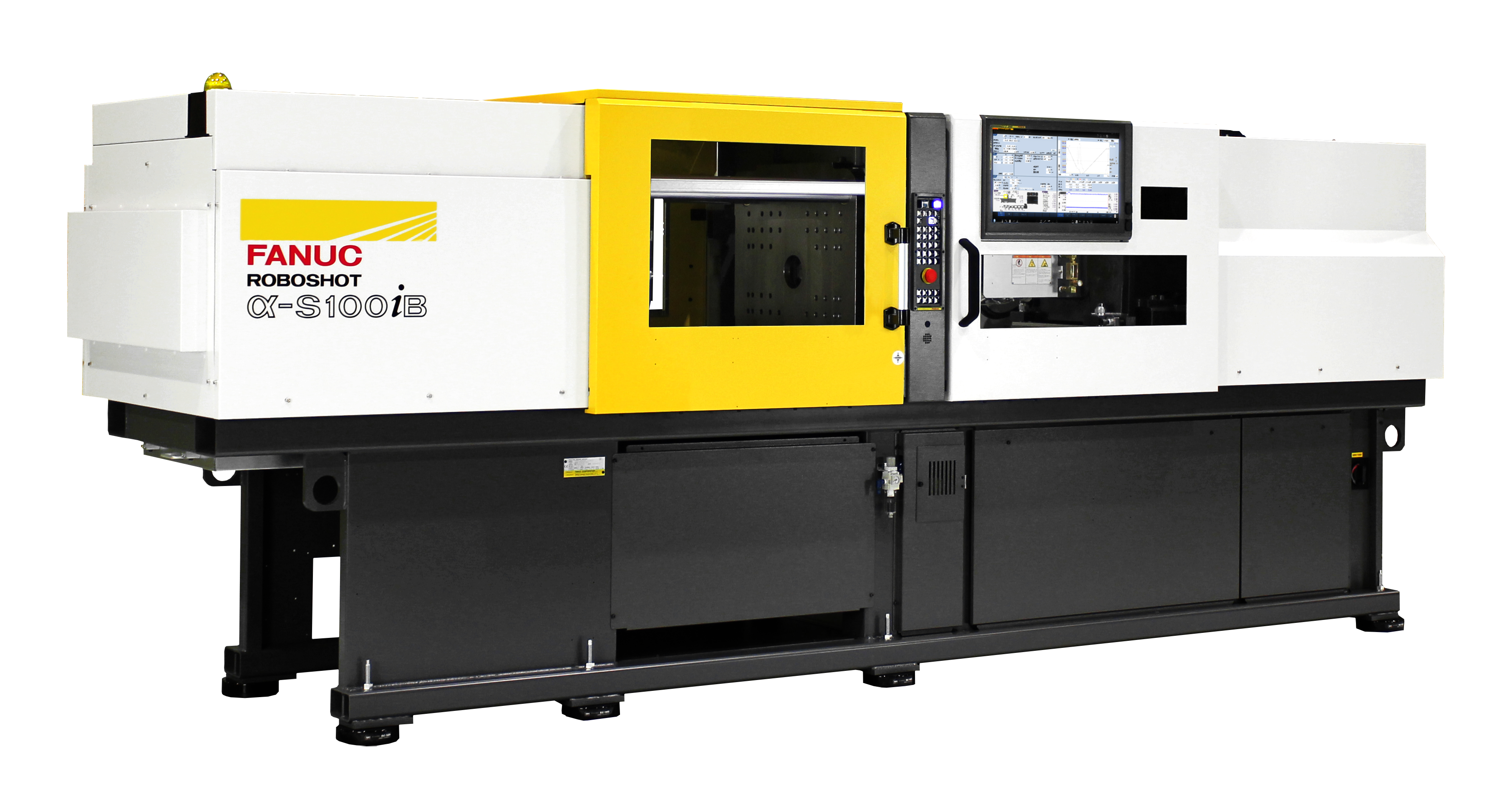

ROBOSHOT α-S100iB
Tonnage
1000 kN | 100 tonf
Screw Diameter
22, 26, 28, 32, 36, 40 mm
Tie Bar Spacing (H × V)
460 x 410 mm
Detalles técnicos
- Clamping Mechanism
- 5 puntos de doble palanca
- Tonnage
- 1000 | 100 tonf
- Tonnage (Increased)
- 1250 | 125 tonf
- Max/Min Die Height (Double Platen)
- 450-150 mm
- Max/Min Die Height (Double Platen, Increased)
- 550-150 mm
- Max/Min Die Height (Single Platen)
- 520-220 mm
- Max/Min Die Height (Single Platen, Increased)
- 620-220 mm
- Clamping Stroke
- 350 mm
- Locating Ring Diameter
- 125 mm
- Tie Bar Spacing (H × V)
- 460 x 410 mm
- Platen Size (H × V)
- 660 x 610 mm
- Minimum Mould Size (H × V)
- 265 x 240 mm
- Maximum Mould Weight (Double Platen)
- 440-440 kg
- Maximum Mould Weight (Single Platen)
- 600-440 kg
- Ejector Stroke
- 100 mm
- Maximum Ejector Force
- 25|2,5 tonf
- Maximum Ejector Force (Increased)
- 60|6,0 tonf
- Screw Diameter
- 22, 26, 28, 32, 36, 40 mm
- Injection Stroke
- 75, 95, 95, 128, 144, 144 mm
- Max. Injection Volume
- 29, 50, 58, 103, 147, 181 cm³
- Nozzle Touch Force
- 15|1,5 tonf
- Nozzle Touch Force (Increased)
- 30|3,0 tonf
