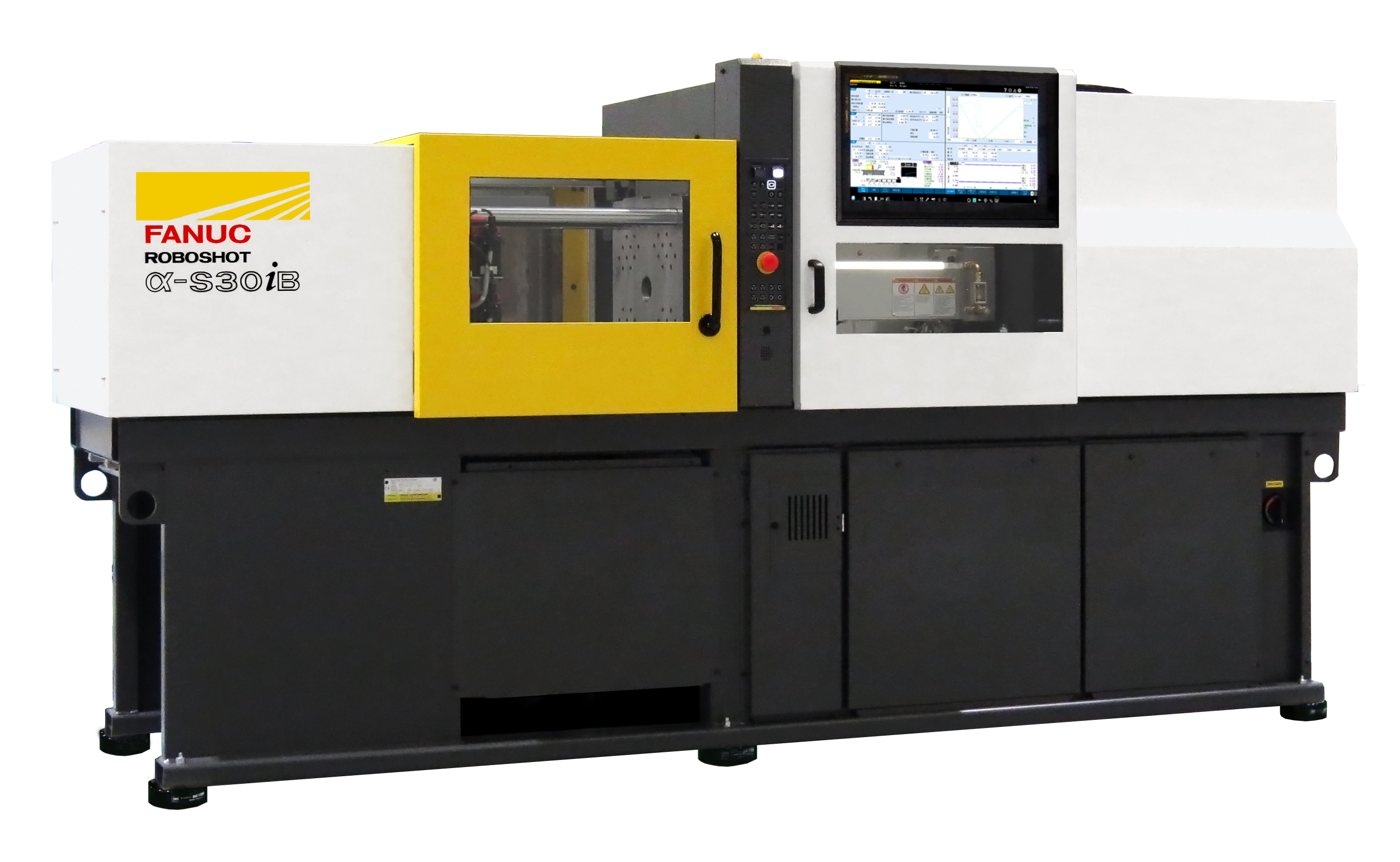

ROBOSHOT α-S30iB
Tonnage
300 kN | 30 tonf
Screw Diameter
14, 16, 18, 20, 22 mm
Tie Bar Spacing (H × V)
310x290 mm
Detalles técnicos
- Clamping Mechanism
- Doble palanca
- Tonnage
- 300|30 tonf
- Max/Min Die Height (Double Platen)
- 330-150 mm
- Clamping Stroke
- 230 mm
- Locating Ring Diameter
- 100 mm
- Tie Bar Spacing (H × V)
- 310x290 mm
- Platen Size (H × V)
- 440 x 240 mm
- Minimum Mould Size (H × V)
- 175x165 mm
- Maximum Mould Weight (Double Platen)
- 150-150 kg
- Ejector Stroke
- 60 mm
- Maximum Ejector Force
- 8|0,8 tonf
- Screw Diameter
- 14, 16, 18, 20, 22 mm
- Injection Stroke
- 56, 56, 75, 75, 75 mm
- Max. Injection Volume
- 9, 11, 19, 24, 29 cm³
- Nozzle Touch Force
- 9|0,9 tonf
