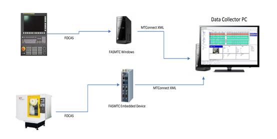

MTConnect Communication Flow
Data is sent from the FANUC CNC to the PC where the FASMTC software is installed using the FANUC FOCAS protocol over a standard Ethernet connection. FASMTC converts the data to the structured MTConnect XML and is sent to the data collection PC or any other MTConnect client application.
Simple Installation - MTConnect Server
FANUC MTConnect Server can be installed on an industrial PC, embedded PC or other PC at the machine tool. Windows 7 and 10 are the primary operating systems that are currently supported. The FANUC MTConnect Server package consists of the FANUC MTConnect Adapter and a standard MTConnect agent, however it can be connected to an existing MTConnect adapter if one is available. Configuration can be completed quickly and easily using the simple Windows UI.
