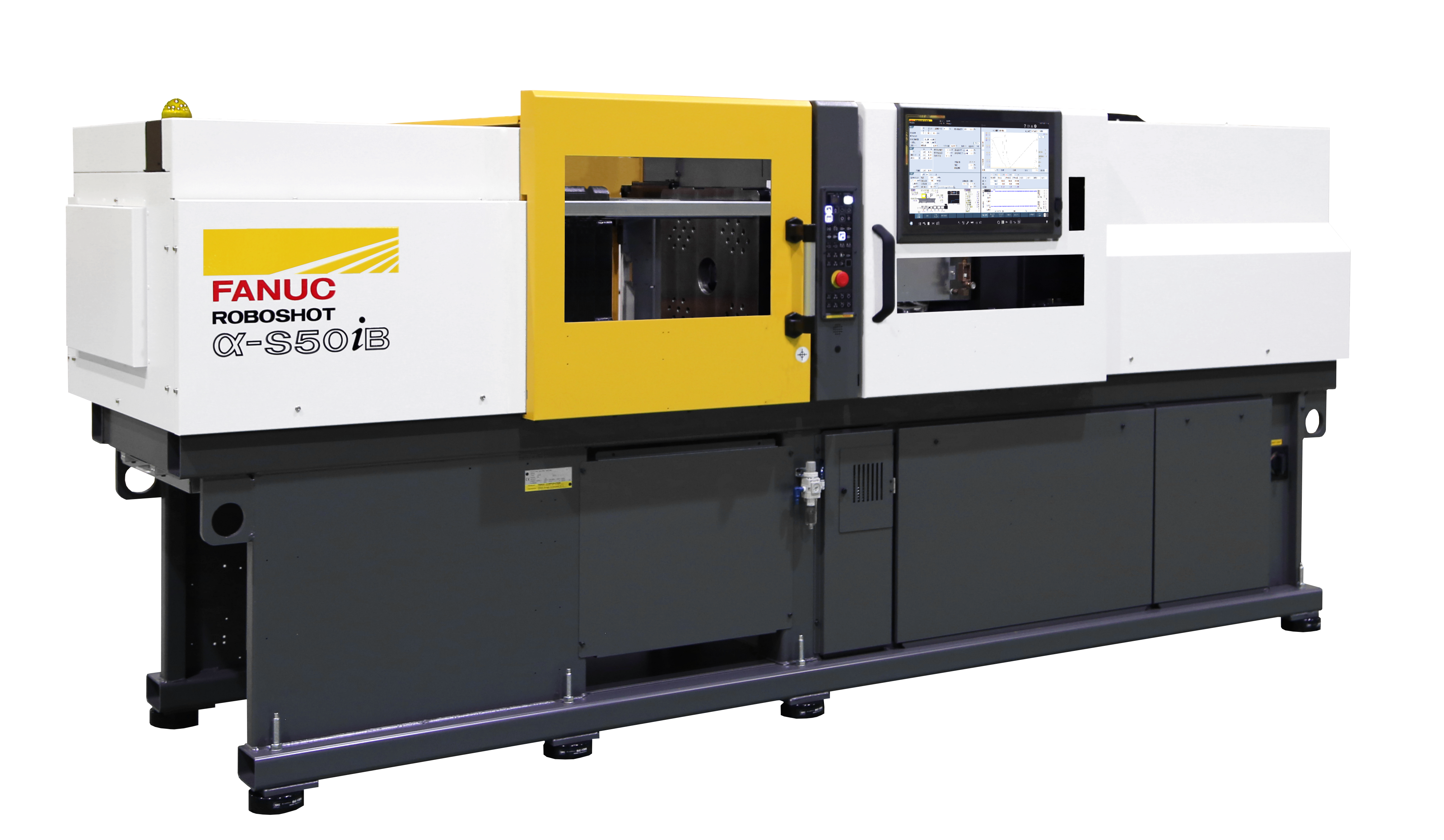

ROBOSHOT α-S50iB
Tonnage
500 kN | 50 tonf
Screw Diameter
18, 20, 22, 26, 28, 32 mm
Tie Bar Spacing (H × V)
360x320 mm
Detalles tecnicos
Detalles tecnicos esenciales e informacion valiosa sobre nuestros productos para ayudarte a tomar las decisiones correctas y aprovechar al maximo tus productos FANUC.
- Clamping Mechanism
- Máquina de doble palanca de 5 puntos
- Tonnage
- 500|50 tonf
- Tonnage (Increased)
- 650|65 tonf
- Max/Min Die Height (Double Platen)
- 350-150 mm
- Max/Min Die Height (Double Platen, Increased)
- 400-150 mm
- Max/Min Die Height (Single Platen)
- 410-210 mm
- Max/Min Die Height (Single Platen, Increased)
- 460-210 mm
- Clamping Stroke
- 250 mm
- Locating Ring Diameter
- 125 mm
- Tie Bar Spacing (H × V)
- 360x320 mm
- Platen Size (H × V)
- 500 x 470 mm
- Minimum Mould Size (H × V)
- 205x185 mm
- Maximum Mould Weight (Double Platen)
- 220-220|300-220 kg
- Ejector Stroke
- 70 mm
- Maximum Ejector Force
- 20|2,0 tonf
- Maximum Ejector Force (Increased)
- 60|6,0 tonf
- Screw Diameter
- 18, 20, 22, 26, 28, 32 mm
- Injection Stroke
- 75, 75, 75, 95, 95, 95 mm
- Max. Injection Volume
- 19, 24, 29, 50, 58, 76 cm³
- Nozzle Touch Force
- 15|1,5 tonf
- Nozzle Touch Force (Increased)
- 30|3,0 tonf
