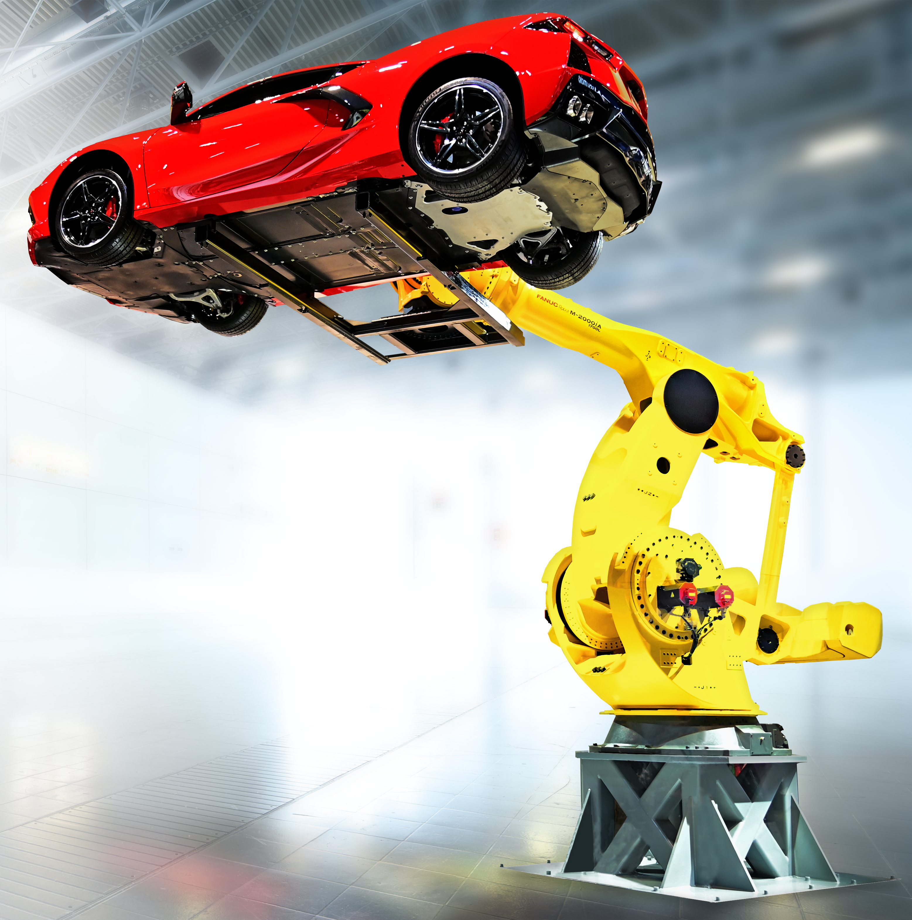

M2000i A 1700 L Lifting C8 Corvette With Background
