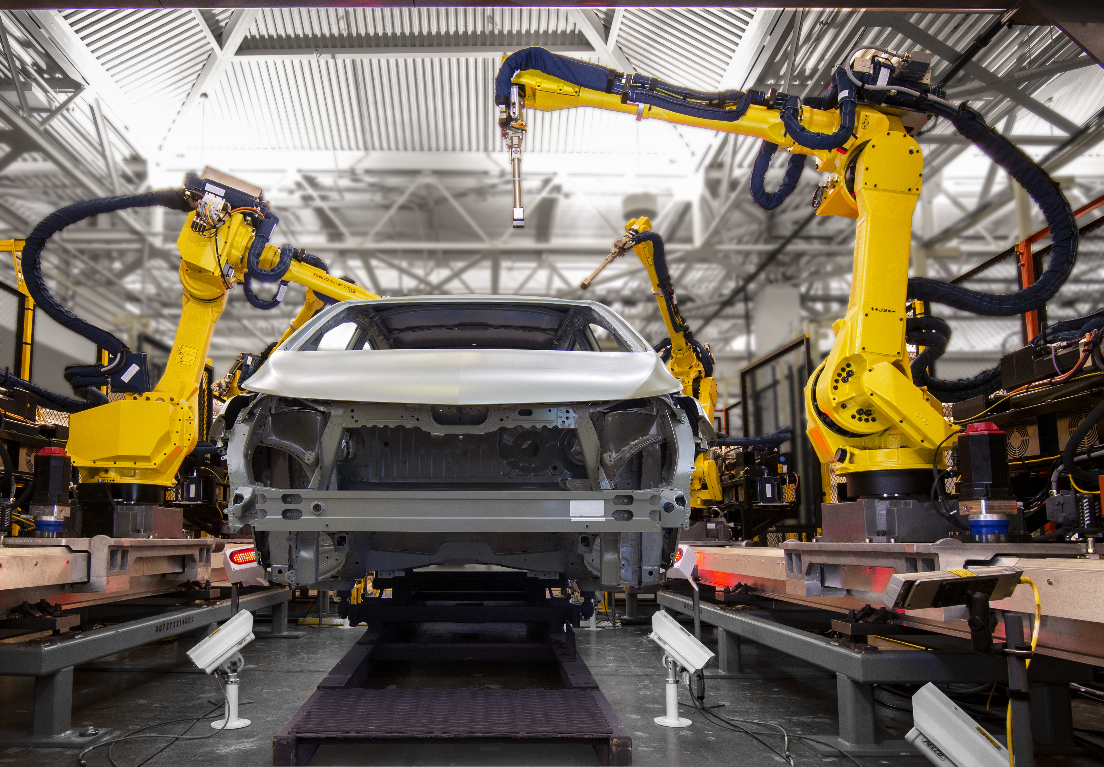

Automotive Dispensing and Sealing
Automotive manufacturers use robotic dispensing systems throughout the production process for gasketing, structural bonding, seam sealing, and sound-deadening applications. FANUC robots are well suited for demanding automotive dispensing applications that require consistent bead placement, accurate path control, and reliable material flow.
Common automotive dispensing applications include:
  • Powertrain RTV gasketing for engines, transmissions, and related components
  • Body shop structural adhesive application for vehicle assembly and bonding
  • Anti-flutter adhesive dispensing for panels and body components
  • Sealer deck applications including PVC sealer and LASD dispensing
  • Automotive seam sealing for repeatable sealant application across vehicle bodies
FANUC robots can be selected based on the required payload, reach, dispense equipment configuration, and path complexity to support both compact and large-scale automotive dispensing systems.
